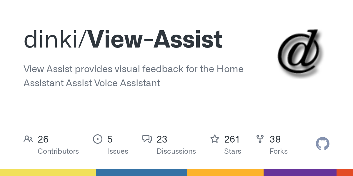

Just use an app called ViewAssist; it was made to run on Android.
I’m using it today and it’s wonderful, just one question, has anyone managed to get the Echo Show 5 camera working?
I’ve got mine jailbroken and showing dashboards through fully kiosk. Can I run viewassist along side fully kiosk or is it one or the other?
Yes, you just need to configure it to start the View Assist app as if it were the HA address; it’s a way for you to specify the application’s address in the Android folder.
