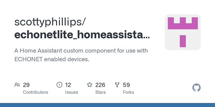

I noticed that Echonet Lite was no longer listed as being downloaded in HACS, and it was also not listed as a downloadable item in HACS. What I did was (1) revert back the core OS to 2026.03.4. I am not sure if this step is necessary though. Then (2) I went to the Echonet Lite Github webpage and clicked on the HACS install button on that webpage:
Echonetlite was then reinstalled, and after I rebooted, my aircon was again available on my dashboard.
