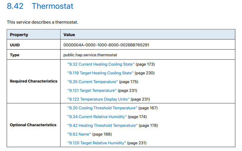

Here’s a link to a document describing the Homekit Accessory Protocol (HAP).
Here’s the section describing the mandatory and optional features of HAP’s “Thermostat accessory object”.
HAP’s Thermostat accessory doesn’t support features like identifying and/or controlling heating/cooling stages, etc. Therefore Home Assistant’s Homekit Device integration cannot model the additional features of an Ecobee thermostat (or other manufacturer) via HAP’s Thermostat.
Perhaps it may be possible to model the additional features using other HAP accessories. For example, HAP has a Fan accessory which might be used to model the Ecobee’s fan control. However, I am not sufficiently familiar with HAP to know what could be used to define/control heating/cooling stages. Plus I don’t know if there are any ‘best practices’ that discourage modelling a physical device as multiple HAP accessories.
tl;dr
HAP only supports a basic set of thermostat features.
Although Ecobee thermostats do not support the Matter protocol, it serves as a useful comparison to HAP. This document describes version 1.2 of the Matter protocol and Matter’s Thermostat model appears to support more features than HAP. Perhaps if Ecobee ever supports Matter (pure speculation), it will become possible to expose more of its features via Home Assistant’s Matter integration.
