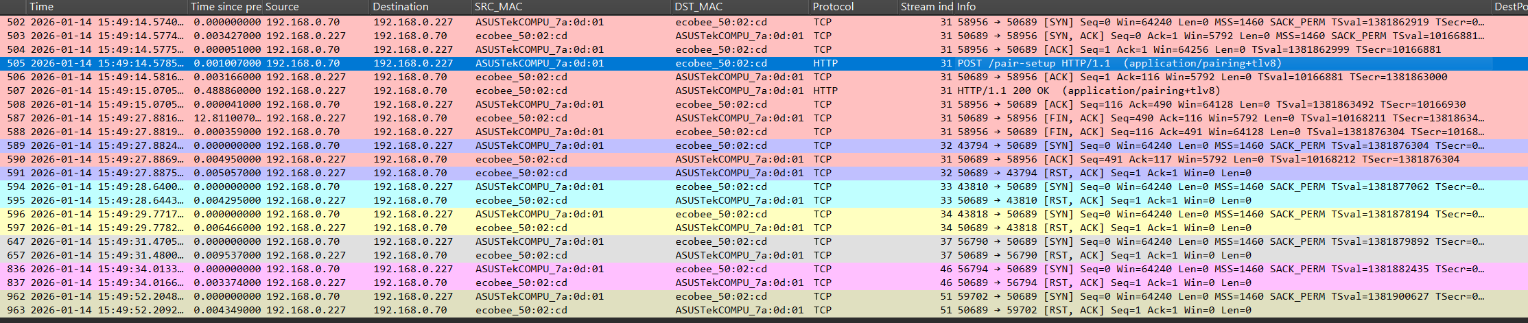

I have recently installed HA and am having some issues getting my ecobee to pair with my server. They are on the same subnet and network with no firewall restrictions. I enter the pairing code and immediately get the dreaded ‘Incorrect HomeKit code. Please check it and try again’ error.
I took a packet capture from my HA server and I see an http request go to the ecobee with a pairing request, followed buy ssl connections that the ecobee are terminating:
I do not have any other Home Kit devices that I can test to see if they work, but it looks to me like it may be an issue on the ecobee itself?
