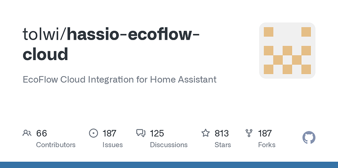

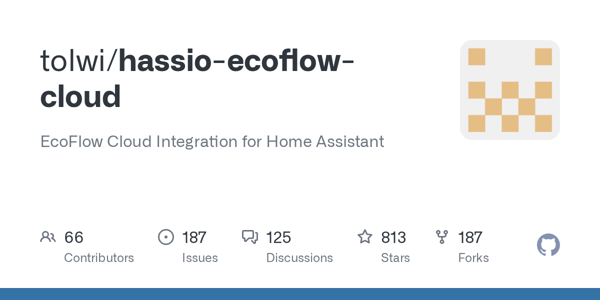

There is a separate integration to pull EF data from the cloud. From the cloud integration notes it does pull energy metrics from the shp2 and delta pro ultra. You have options… and i run both and i use integrals to get the data i want how i want it. Both projects are community driven, you are welcome to contribute your skills as well.
One correction - I don’t think it pulls it from the device - I can’t find a field that represents energy for either of these devices which means that it does not calculate energy internally - it only integrates while connected to the cloud (I know this is the case for Delta 3s as it says Statistics are estimated based on cloud data generated while the device is online in the EF app).
FYI - for cloud integration SHP2 and DPU, the integral is calculated in HA from power sensors - it does not pull it from cloud/device so it does exactly the same thing as manual integral, it just saves you few clicks. We could do the same thing, but I find these sensors a bit misleading.
