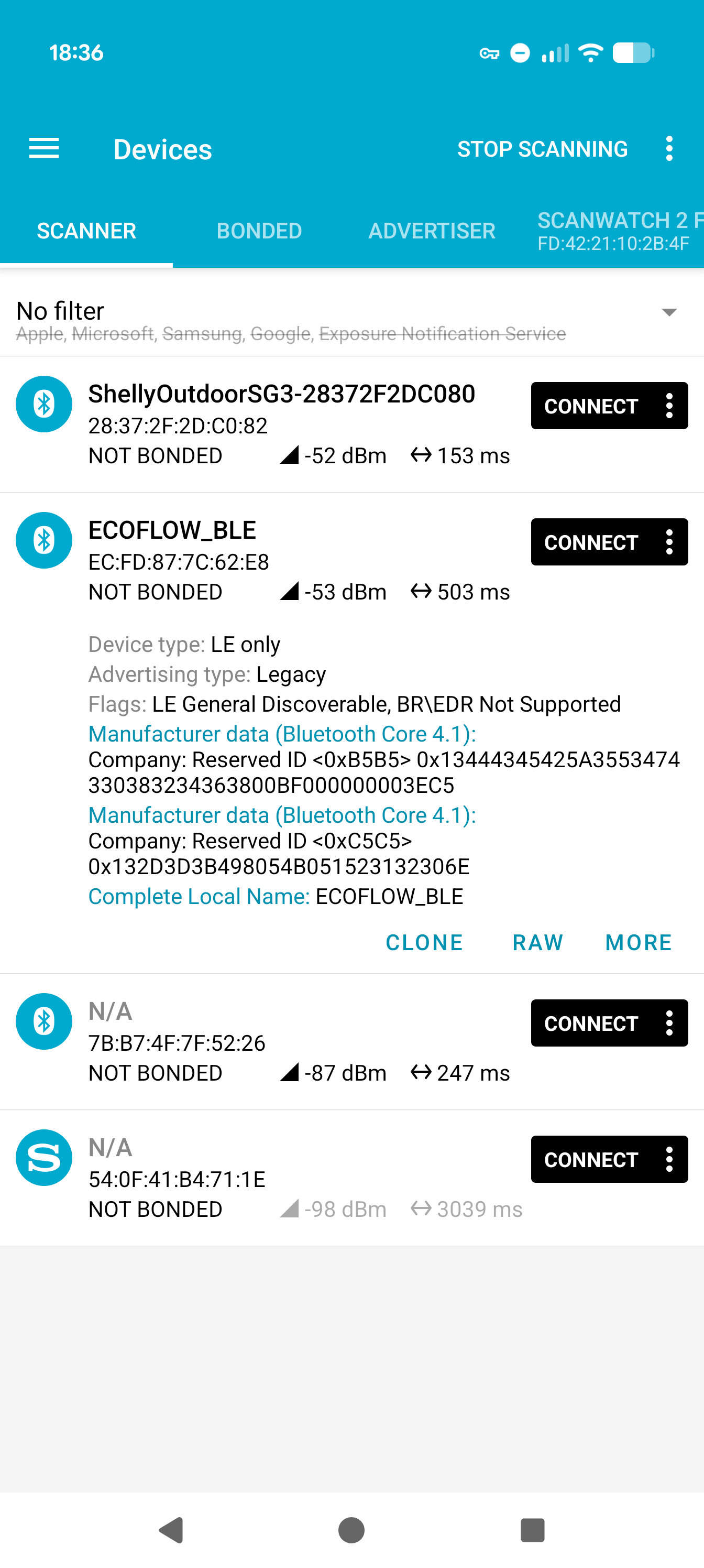

It isn’t picked up anywhere in Home Assistant. Here are the signal properties of the Delta Pro, maybe someone finds the cause. It’ is transmitting a signal, but the ble isnt picking it up.
I posted 2 more screenshots in the Github discussion, as I’m limited to one here.

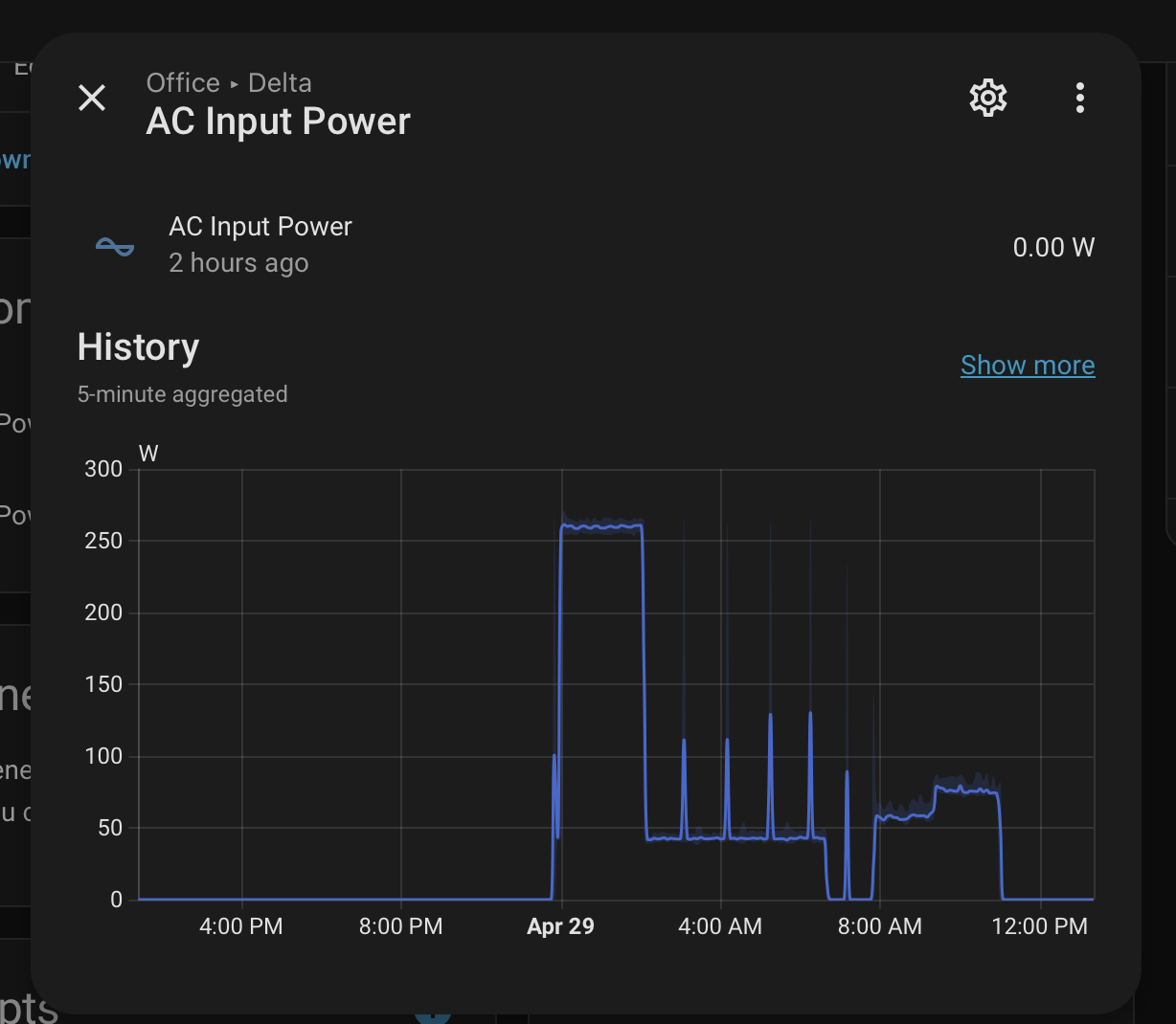

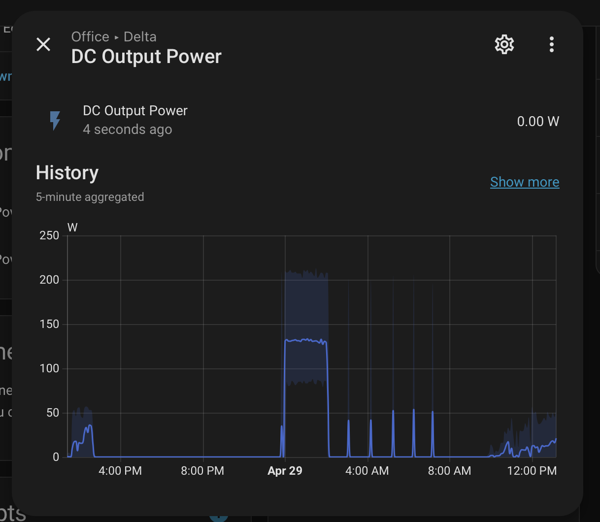

I just recently switched over a Delta 2 from using the Cloud integration to the BLE integration (v0.8.5), and noticed an anomaly since doing so, with DC Output Power. I have DC Output turned off, and nothing connected to the DC ports, but I’m still getting power values:
As background, this Delta 2 is connected to some leftover solar panels, which charge it during the day, and the AC Input to the Delta 2 is cut off between 4pm-9pm (where my energy tariffs are higher), and I just run off the battery during that period. Power comes back on at 9pm (but Backup Reserve is set to 10% until midnight, when it is restored to 50%), so these DC Output Power values really look a lot like the AC Input values:
Is this a bug in the integration, or perhaps this is illustrative of what is going on behind the scenes? For example, is that AC input getting turned into DC output even though I"m not using the DC ports?

@jaydisc Delta 2 messages are annoying to work with because they use fixed length encoding and the byte sequence does depend on the firmware. This encoding means that if we misidentify one field, everything after it can shift and will report incorrect values - I think in your case it is reporting DC Input Power, not output power - input power field is right next to output power, just shifted 4 bytes left. If you create an issue on github and provide some diagnostics data, we can look at it.
