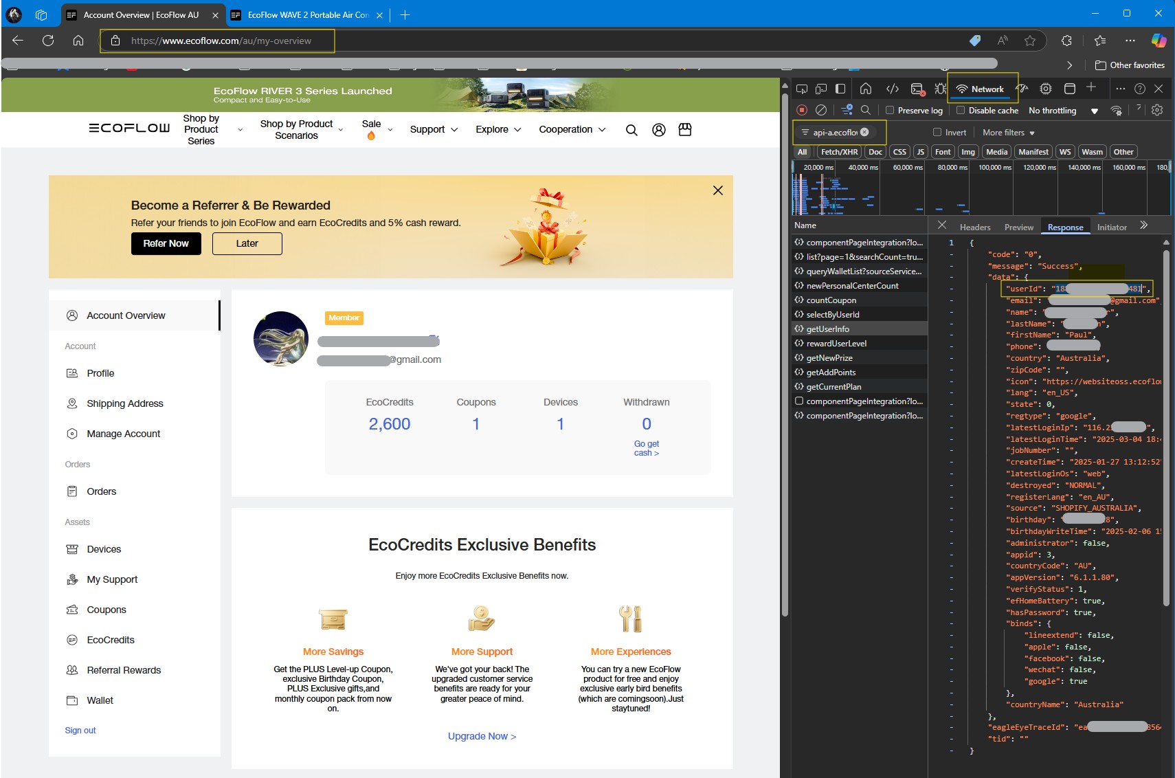

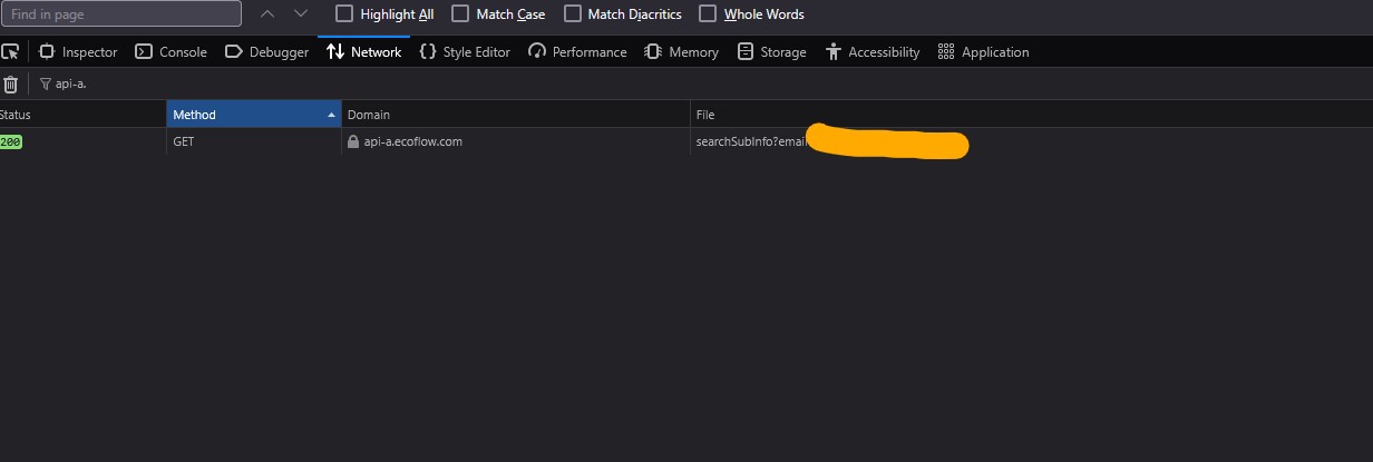

I’m having trouble locating my userID using the existing tutorial (as seen here EcoFlow BLE (Unofficial) - #10 by Rabit) I see none of the information I’m supposed to see. There is no POST entry, only this, right after logging in (and using the correct filter):
Did the web login change?
Hi @HA-one , POST is happening when you click “Log In” button on the login page - it’s literally the request sent to api-a.ecoflow.com with your login and password when you click on the button, so please make sure you following the procedure: your browser should not be logged-in already, just use the incognito (private) mode for that if you are not sure.
Thank you for the assistance.
Yes, I’m pretty sure that’s what I’ve been trying. After this login page:
it goes straight to here:
And it does not show any POST requests that match the filter, within the console. Am I looking at it too late?
Ok, then you probably need to check what the other requests are sent after you click “Log In” button - who knows, maybe it’s just me who gets api-a.ecoflow.com and yours is api-b.ecoflow.com. So just remove all the filters, then cleanup all the requests before you click on “Log In” button (small trash bin button in left corner of the console) and look at the POST request sent when you press the button.
Alternative way to get the user id is using scripts for getting mqtt credentials mentioned in ioBroker.ecoflow-mqtt.
I made a stripped down version in this gist that only prints the user id after log in. We could probably do the same during the integration setup.
