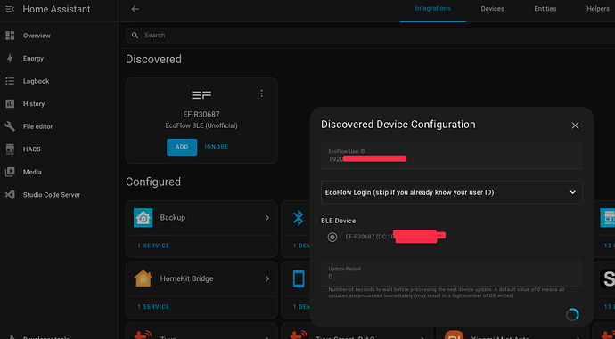

I have wifi & bluetooth card that I can recognize. It can scan the Ecoflow River 3 Plus of my but I can’t connect it after filling the user ID and account.
Sooo you can start from reading this page: Home · rabits/ha-ef-ble Wiki · GitHub - it has alternative way to get the user id through browser & dev console. But if your HA is not connected to internet (needed to contact ecoflow api to get your user id automatically) - you probably have much bigger issues to worry about…

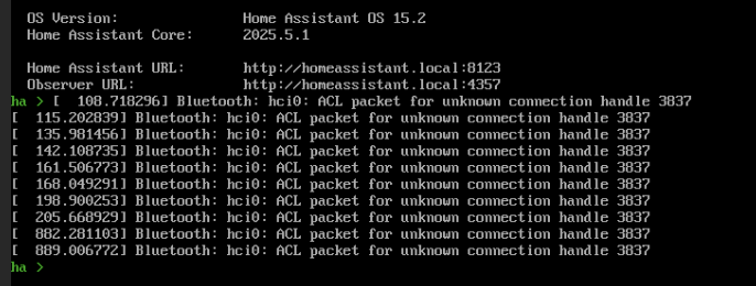

What Bluetooth adapter are you using? I went straight bluetooth (no proxy) I’ve tried SABRENT BT-UB40 and Sena UD100-G03 ( this thing is a beast ) from the HA known working adapters list and I’m getting no errors in the debug logging when I try to add the D3 the RSSI is excellent at -44, but it still won’t add I just get error “Could not connect to device, exceeded maximum tries” every time I try.
I figure I might have better luck if I try the same BT adapter and emulate a know working config as close as possible. :innocent:
I’m using Intel M.2 wifi+bluetooth cards on my main devices (AX200 and AX201), but it also worked on my Raspberry PI 4 bluetooth chipset. I also had esp32-wroom-32d laying around so I flashed proxy on it and it did not have any problems with D3+ - I don’t believe that it’s a hardware problem.
Looking back at your logs, it seems that D3 responds to key exchange request, but is ignoring the session key request. @rabits, you know the protocol better - do you have any idea as to why it might not be sending anything back? It does not look like connection problem, would it be possible that it expects a different request payload? Though that is not too likely assuming it is not a bug. I’ll maybe try to add more detailed debug logging for connection to help with diagnosis.
Also, this is most likely problem specific to 1500 variant - is there anyone here who successfully connected Delta 3 1500?

2025-05-19 14:22:32.581 DEBUG (MainThread) [habluetooth.wrappers] E4:B3:23:96:4C:82 - EF-D36E0753 -> /org/bluez/hci0: Connected via hci0 (00:01:95:C9:B3:A0) (last rssi: -53)
2025-05-19 14:22:32.581 INFO (MainThread) [custom_components.ef_ble.eflib.connection - E4:B3:**:**:**:**] Connected
2025-05-19 14:22:33.015 DEBUG (MainThread) [bleak.backends.bluezdbus.manager] received D-Bus signal: org.freedesktop.DBus.Properties.PropertiesChanged (/org/bluez/hci0/dev_E4_B3_23_96_4C_82/service000e/char0011): ['org.bluez.GattCharacteristic1', {'NotifyAcquired': <dbus_fast.signature.Variant ('b', True)>}, []]
2025-05-19 14:22:33.016 DEBUG (MainThread) [custom_components.ef_ble.eflib.connection - E4:B3:**:**:**:**] MTU: 500
2025-05-19 14:22:33.016 INFO (MainThread) [custom_components.ef_ble.eflib.connection - E4:B3:**:**:**:**] Init completed, starting auth routine...
2025-05-19 14:22:33.016 DEBUG (MainThread) [custom_components.ef_ble.eflib.connection - E4:B3:**:**:**:**] initBleSessionKey: Pub key exchange
2025-05-19 14:22:33.018 DEBUG (MainThread) [custom_components.ef_ble.eflib.connection - E4:B3:**:**:**:**] Sending: '5a5a00012c00010043864ff431b3173f48fdf69d5da7123a33a902411503443aaa321a5d192cbe0356cc56ebc6fc3d30d65f'
2025-05-19 14:22:33.019 DEBUG (MainThread) [bleak.backends.bluezdbus.manager] received D-Bus signal: org.freedesktop.DBus.Properties.PropertiesChanged (/org/bluez/hci0/dev_E4_B3_23_96_4C_82/service000e/char0011): ['org.bluez.GattCharacteristic1', {'NotifyAcquired': <dbus_fast.signature.Variant ('b', False)>}, []]
2025-05-19 14:22:33.175 DEBUG (MainThread) [bleak.backends.bluezdbus.manager] received D-Bus signal: org.freedesktop.DBus.Properties.PropertiesChanged (/org/bluez/hci0/dev_E4_B3_23_96_4C_82/service000e/char0011): ['org.bluez.GattCharacteristic1', {'Notifying': <dbus_fast.signature.Variant ('b', True)>}, []]
2025-05-19 14:22:33.295 DEBUG (MainThread) [bleak.backends.bluezdbus.client] Write Characteristic 00000002-0000-1000-8000-00805f9b34fb | /org/bluez/hci0/dev_E4_B3_23_96_4C_82/service000e/char000f: bytearray(b'ZZ\x00\x01,\x00\x01\x00C\x86O\xf41\xb3\x17?H\xfd\xf6\x9d]\xa7\x12:3\xa9\x02A\x15\x03D:\xaa2\x1a]\x19,\xbe\x03V\xccV\xeb\xc6\xfc=0\xd6_')
2025-05-19 14:22:33.375 DEBUG (MainThread) [bleak.backends.bluezdbus.manager] received D-Bus signal: org.freedesktop.DBus.Properties.PropertiesChanged (/org/bluez/hci0/dev_E4_B3_23_96_4C_82/service000e/char0011): ['org.bluez.GattCharacteristic1', {'Value': <dbus_fast.signature.Variant ('ay', b'ZZ\x00\x01-\x00\x01\x00\x00*u\x08\xcbG\x03\xe9\xa3\x10\x82\xa1}\x1f\x7f\x81\xda\x89\xf1s\xac\xd9\x12\xd6\x90\xb0.x\xcb+}\xbe\xd2\xd6\x8c\x92\xc2\x8a\x97A\xd6\x0b\x15')>}, []]
2025-05-19 14:22:33.377 DEBUG (MainThread) [bleak.backends.bluezdbus.manager] received D-Bus signal: org.freedesktop.DBus.Properties.PropertiesChanged (/org/bluez/hci0/dev_E4_B3_23_96_4C_82/service000e/char0011): ['org.bluez.GattCharacteristic1', {'Notifying': <dbus_fast.signature.Variant ('b', False)>}, []]
2025-05-19 14:22:33.377 DEBUG (MainThread) [custom_components.ef_ble.eflib.connection - E4:B3:**:**:**:**] parseSimple: Data: '5a5a00012d000100002a7508cb4703e9a31082a17d1f7f81da89f173acd912d690b02e78cb2b7dbed2d68c92c28a9741d60b15'
2025-05-19 14:22:33.380 DEBUG (MainThread) [custom_components.ef_ble.eflib.connection - E4:B3:**:**:**:**] getKeyInfoReq: Receiving session key
2025-05-19 14:22:33.381 DEBUG (MainThread) [custom_components.ef_ble.eflib.connection - E4:B3:**:**:**:**] Sending: '5a5a000103000286c2'
2025-05-19 14:22:33.615 DEBUG (MainThread) [bleak.backends.bluezdbus.manager] received D-Bus signal: org.freedesktop.DBus.Properties.PropertiesChanged (/org/bluez/hci0/dev_E4_B3_23_96_4C_82/service000e/char0011): ['org.bluez.GattCharacteristic1', {'Notifying': <dbus_fast.signature.Variant ('b', True)>}, []]
2025-05-19 14:22:33.695 DEBUG (MainThread) [bleak.backends.bluezdbus.client] Write Characteristic 00000002-0000-1000-8000-00805f9b34fb | /org/bluez/hci0/dev_E4_B3_23_96_4C_82/service000e/char000f: bytearray(b'ZZ\x00\x01\x03\x00\x02\x86\xc2')
2025-05-19 14:22:33.695 DEBUG (MainThread) [bleak.backends.bluezdbus.manager] received D-Bus signal: org.freedesktop.DBus.Properties.PropertiesChanged (/org/bluez/hci0/dev_E4_B3_23_96_4C_82/service000e/char0011): ['org.bluez.GattCharacteristic1', {'Value': <dbus_fast.signature.Variant ('ay', b'ZZ\x00\x01#\x00\x02\xbf\xba_\xa4Z\xc5\xbb"\xc6\x97\xa4TS\xa9W\x16a|\xa6\xcd\x0f*,\xc6\x8c\xad>\x8f\x16\x0c4K\xaf\x03')>}, []]
2025-05-19 14:22:33.696 DEBUG (MainThread) [bleak.backends.bluezdbus.manager] received D-Bus signal: org.freedesktop.DBus.Properties.PropertiesChanged (/org/bluez/hci0/dev_E4_B3_23_96_4C_82/service000e/char0011): ['org.bluez.GattCharacteristic1', {'Notifying': <dbus_fast.signature.Variant ('b', False)>}, []]
2025-05-19 14:22:33.696 DEBUG (MainThread) [custom_components.ef_ble.eflib.connection - E4:B3:**:**:**:**] parseSimple: Data: '5a5a0001230002bfba5fa45ac5bb22c697a45453a95716617ca6cd0f2a2cc68cad3e8f160c344baf03'
2025-05-19 14:22:33.697 DEBUG (MainThread) [custom_components.ef_ble.eflib.connection - E4:B3:**:**:**:**] getKeyInfoReq: Receiving auth status
2025-05-19 14:22:33.697 DEBUG (MainThread) [custom_components.ef_ble.eflib.connection - E4:B3:**:**:**:**] Sending packet: Packet(0x21, 0x35, 0x35, 0x89, bytes.fromhex(''), 0x01, 0x01, 0x03, b'\x00\x00\x00\x00', 0x00)
2025-05-19 14:22:33.697 DEBUG (MainThread) [custom_components.ef_ble.eflib.connection - E4:B3:**:**:**:**] Sending: '5a5a100122003d17dbca036945d55dac2a4031fe48cdd7e736fcd141fc0898f428e4a041dbb5269c'
2025-05-19 14:22:33.896 DEBUG (MainThread) [bleak.backends.bluezdbus.manager] received D-Bus signal: org.freedesktop.DBus.Properties.PropertiesChanged (/org/bluez/hci0/dev_E4_B3_23_96_4C_82/service000e/char0011): ['org.bluez.GattCharacteristic1', {'Notifying': <dbus_fast.signature.Variant ('b', True)>}, []]
2025-05-19 14:22:33.975 DEBUG (MainThread) [bleak.backends.bluezdbus.client] Write Characteristic 00000002-0000-1000-8000-00805f9b34fb | /org/bluez/hci0/dev_E4_B3_23_96_4C_82/service000e/char000f: bytearray(b'ZZ\x10\x01"\x00=\x17\xdb\xca\x03iE\xd5]\xac*@1\xfeH\xcd\xd7\xe76\xfc\xd1A\xfc\x08\x98\xf4(\xe4\xa0A\xdb\xb5&\x9c')
2025-05-19 14:22:42.249 DEBUG (MainThread) [bleak.backends.bluezdbus.manager] received D-Bus signal: org.freedesktop.DBus.Properties.PropertiesChanged (/org/bluez/hci0/dev_E4_B3_23_96_4C_82): ['org.bluez.Device1', {'ServicesResolved': <dbus_fast.signature.Variant ('b', False)>, 'Connected': <dbus_fast.signature.Variant ('b', False)>}, []]
2025-05-19 14:22:42.249 DEBUG (MainThread) [bleak.backends.bluezdbus.client] Device disconnected (/org/bluez/hci0/dev_E4_B3_23_96_4C_82)
2025-05-19 14:22:42.249 DEBUG (MainThread) [bleak.backends.bluezdbus.client] _cleanup_all(/org/bluez/hci0/dev_E4_B3_23_96_4C_82)
2025-05-19 14:22:42.250 WARNING (MainThread) [custom_components.ef_ble.eflib.connection - E4:B3:**:**:**:**] Disconnected from device
2025-05-19 14:22:42.250 WARNING (MainThread) [custom_components.ef_ble.eflib.connection - E4:B3:**:**:**:**] Reconnecting to the device in 10 seconds...
2025-05-19 14:22:52.252 DEBUG (MainThread) [habluetooth.wrappers] E4:B3:23:96:4C:82: Looking for backend to connect
2025-05-19 14:22:52.252 INFO (MainThread) [habluetooth.wrappers] E4:B3:23:96:4C:82 - EF-D36E0753: Found 1 connection path(s), preferred order: hci0 (00:01:95:C9:B3:A0) (RSSI=-46) (failures=0) (in_progress=0) (score=-46.0)
2025-05-19 14:22:52.252 DEBUG (MainThread) [habluetooth.wrappers] E4:B3:23:96:4C:82 - EF-D36E0753 -> /org/bluez/hci0: Connecting via hci0 (00:01:95:C9:B3:A0) (last rssi: -46)
2025-05-19 14:22:52.252 DEBUG (MainThread) [bleak.backends.bluezdbus.client] Connecting to device @ E4:B3:23:96:4C:82
