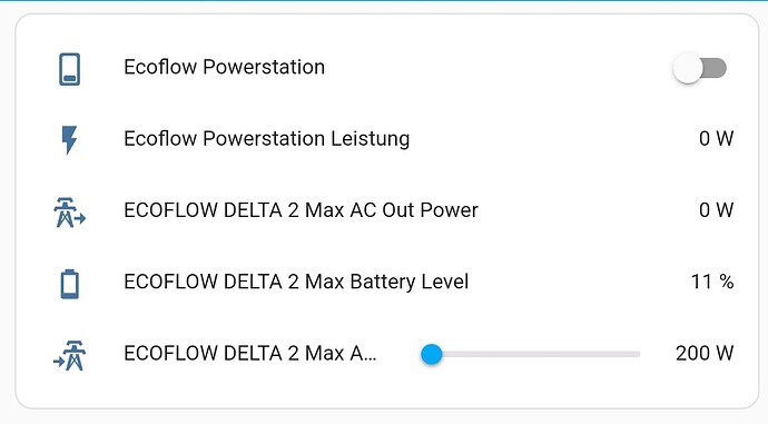

I installed “Ecoflow Cloud” to integrated my ECOFLOW DELTA 2 MAX.
The installation was successfull and I got every information about my Powerstation.
But I have an issue to change the charging level. As you see on the picture, when my powerstation is charging I have the possibility to regulate it in HA, but the powerstation has no reaction.
Also when I change the configuration at the ECOFLOW App, I don’t see the change in HA.
I anybody have an idea why it don’t work?

I have the same issue……no solution?
I have the same problem but it was because my unit was set to fast charge (with the physical button). Once I set it to slow charging I was able to change the AC input power again via the app and also via HA.
I have the latest firmware installed (v1.0.0.178) and I use this integration: GitHub - tolwi/hassio-ecoflow-cloud: EcoFlow Cloud Integration for Home Assistant
I’m new to EcoFlow, but from what I understand, if you’ve set up scheduled tasks (for charging or discharging), the Delta 2 Max will automatically operate in passthrough mode outside those scheduled hours. That might also explain why you’re unable to change the AC charging input power during those times. However, you should be able to adjust the input power while you’re within the scheduled AC charging window.
