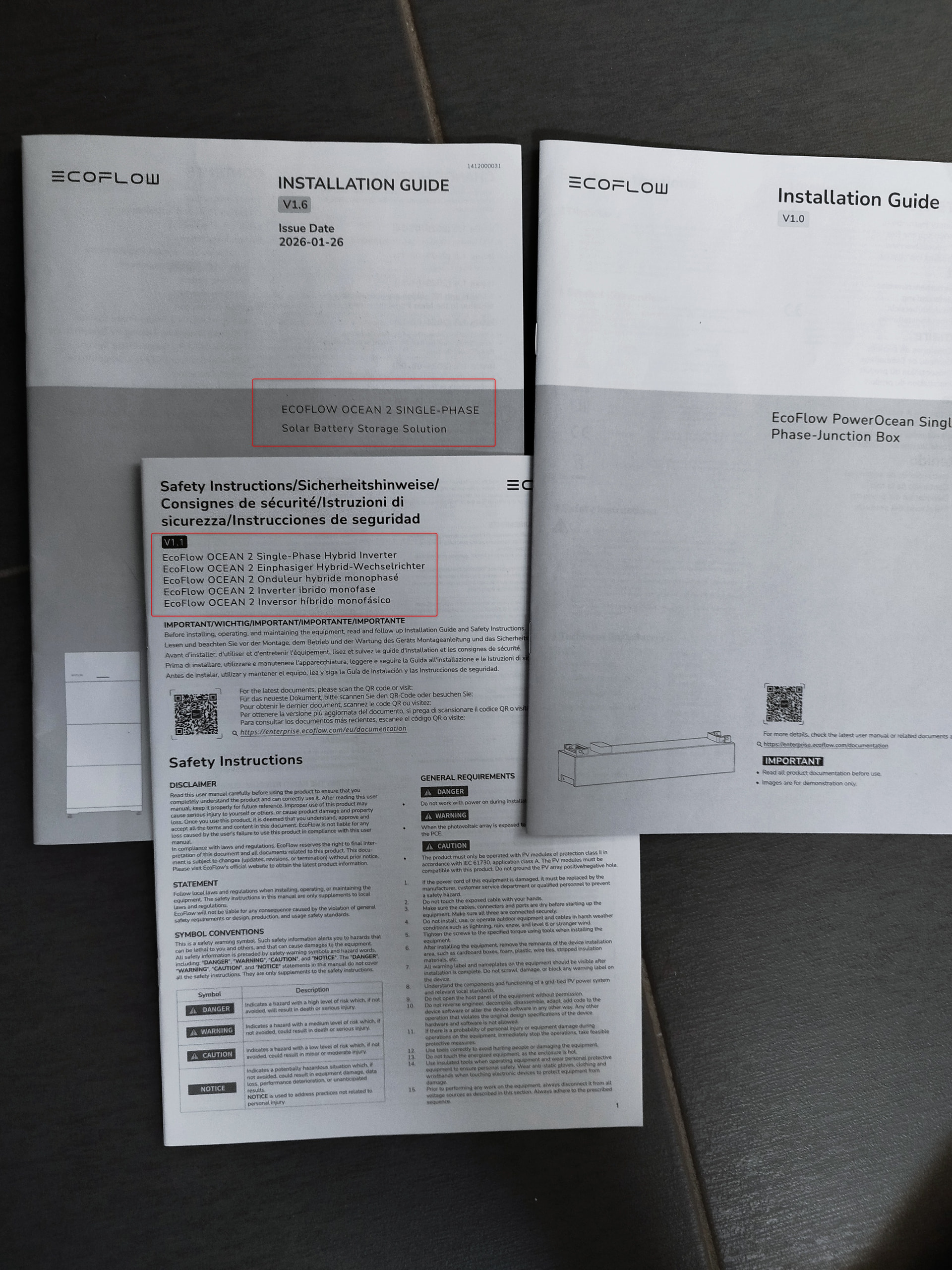

Edit: my serial start with J32
The OCean 2 starts with RE11.. are you sure you have the new Ocean 2?

The model that was installed appears to be an HD-PA-6K-S2.
