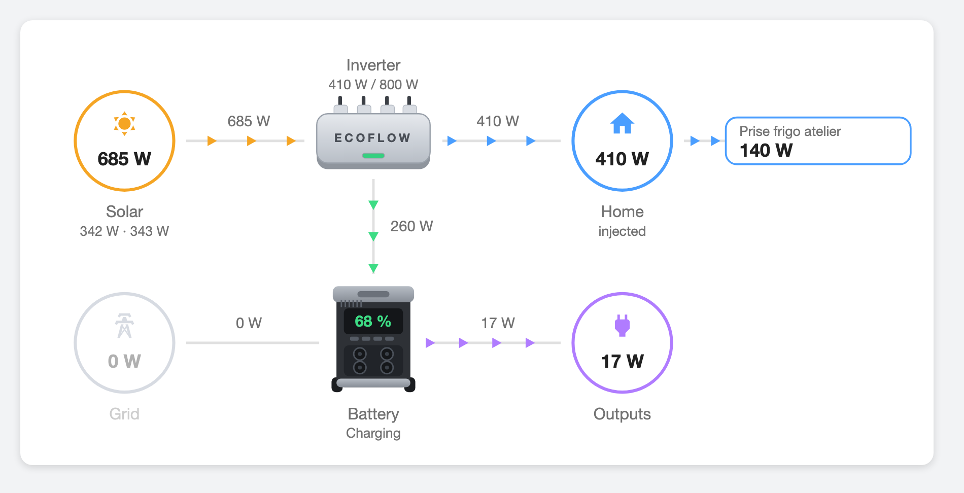

This card draws what is actually there:
Solar  →  PowerStream  →  Home (injected)               ↕Grid   →   Battery     →  Outputs
Five flows, and only the inverter to battery link is bidirectional.
What it does:
  • One signed sensor drives the battery link. Negative charges, positive discharges, and the arrow flips direction and colour with it. There is an invert option if your integration signs it the other way.
  • The PowerStream and the power station are drawn in SVG, theme aware and scaling to any width. The status LED reproduces the colour code from the PowerStream manual, and the station carries its state of charge on its own display. The three states the integration does not expose, pairing, warning and error, are deliberately never shown rather than guessed.
  • Household loads. List your metered plugs and they appear as chips off the home node, each on its own branch. The branch only animates while the inverter is actually injecting, so a load running on grid power still reports its watts without pretending the injection feeds it.
  • Flows are made of arrowheads travelling along the line and rotated to follow it, so a still screenshot carries direction. A dashes mode is available. Reduced motion freezes the arrowheads in place, still readable.
