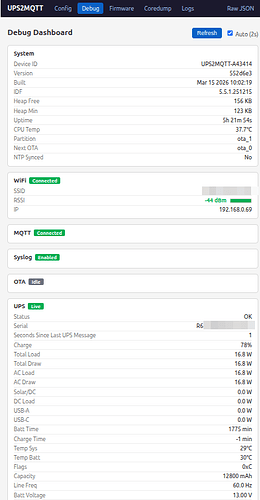

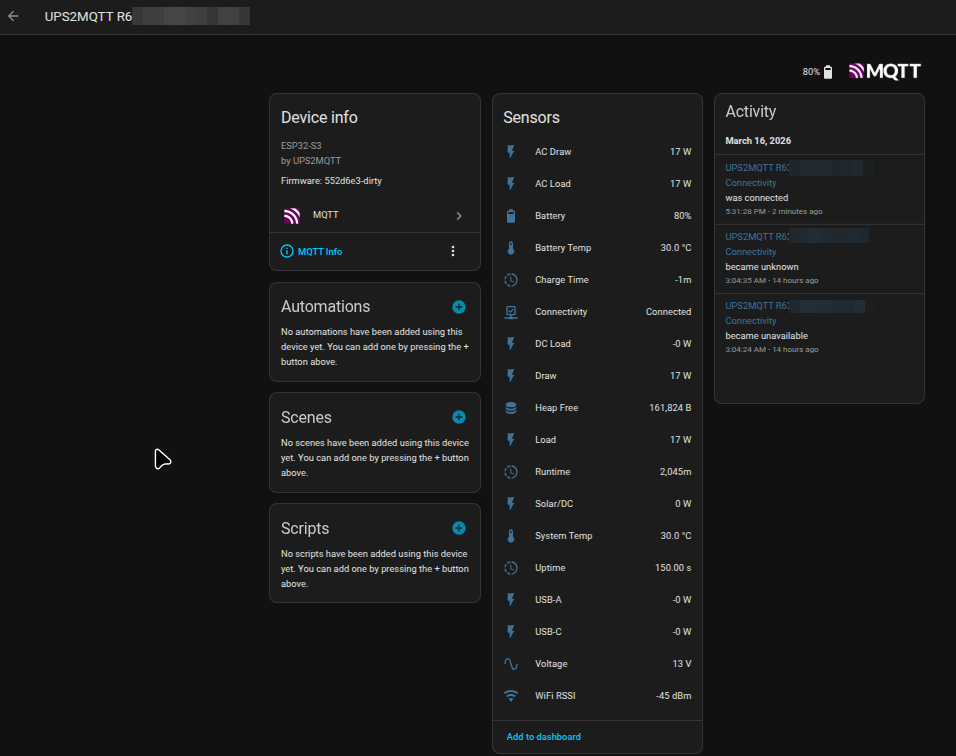

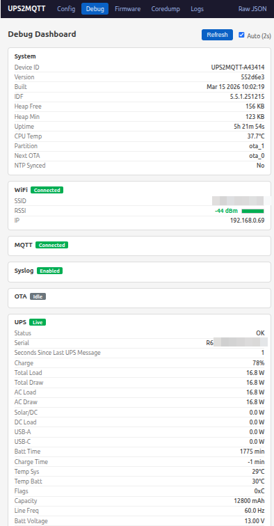

Not sure why I’m sharing this, it’s a bit niche. I was struggling to get the official API working with my Ecoflow account, I think i registered in a different country and have given up trying to sort that out. Instead I took another approach to go completely offline.

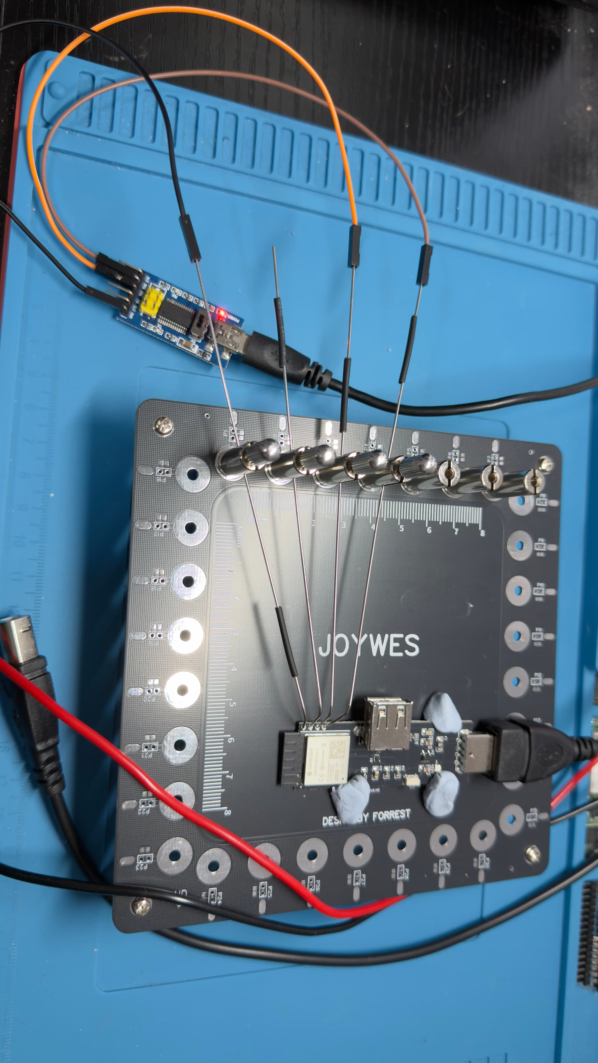

I have designed my own PCB which takes the telemetry from the USB Type-B port on the back of the River 3 Plus and sends it over WiFi to my HA MQTT service, which Home Assistant can make use of. Probably a bit over the top to be honest as it’s always plugged in, always at 80% charge and always drawing ~17 watts.
Some images below of the PCB and dashboards.
