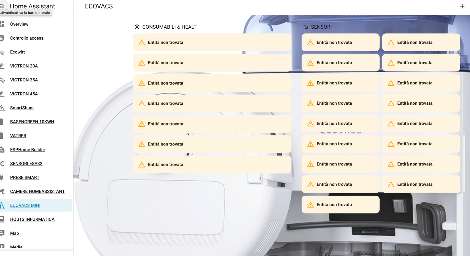

Hello everyone, I read that ecovacs has changed some bees and therefore HA can not connect cloud branches to ecovacs , at least that’s what I understood . In your opinion ? Will he be reinstated? Or do I have to remove it?
Same here, my logs are showing:
Logger: deebot_client.authentication
Bron: runner.py:289
Eerst voorgekomen: 25 juli 2026 om 17:07:12 (463 gebeurtenissen)
Laatst gelogd: 20:15:23
call to https://gl-be-api.ecovacs.com/v1/private/be/EN/xxxxxxxxxx/global_e/1.6.3/google_play/1/user/login failed with {'code': '1013', 'msg': 'Please update to the latest version to continue.', 'time': 1785261359846, 'data': None, 'success': False}
I have no idea where to report this.
