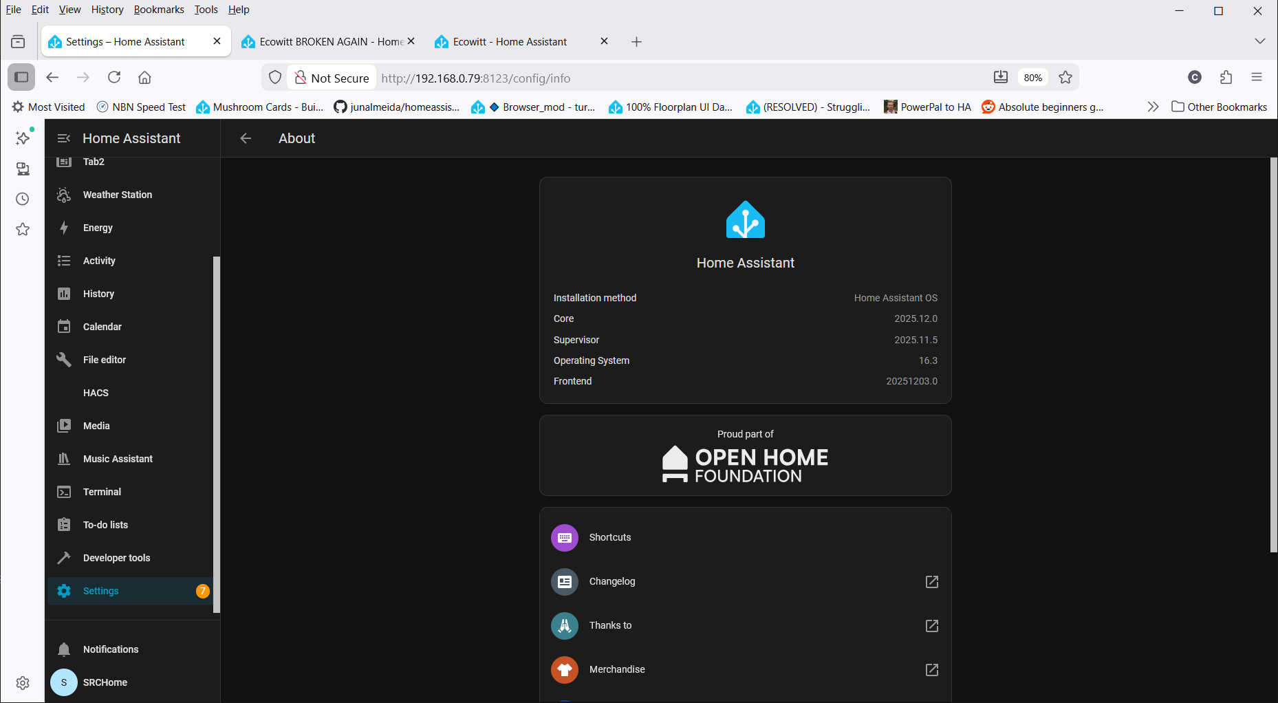

HA core: 2025.11.2
Ecowitt GW2000a firmware: 13b

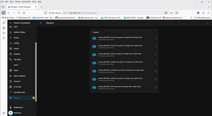

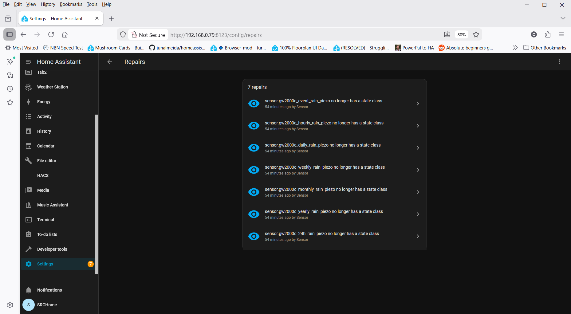

Just updated the Core of HA to 2025.12.0, and ended up with seven repairs needed on the Ecowitt integration. Anyone else had this issue with this new core update?
Yes. Issues have been opened on Github.
Link here, for those who want to follow along the discussion:
[update: adding “state_class: measurement” to the affected entities in configuration.yaml seems to work, resulting in no further errors.
