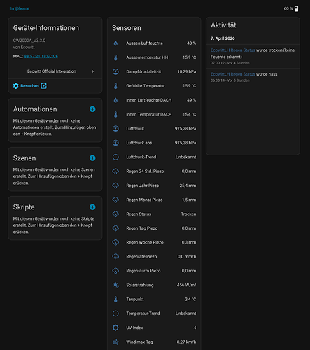

Nope, everything from my Ecowitt Official Integration is up and running with the latest HA update…
Here the official ECOWITT integration works without problems on the latest version of HA
