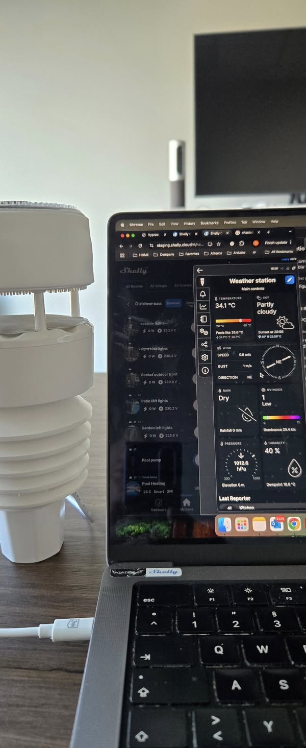

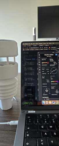

Soon Wittboy powered by Shelly will be available, which will not require a hub to communicate with HA.
Do you know if I will be able to upgrade an existing Wittboy to run the Shelly integration?
I’m not generally opposed to keep running the GW1200 as it also doubles as a room temp/humidity sensor, but I’d consider it nonetheless.
This new Wittboy will not work with Shelly integration only with BTHome or ZHA/Z2M, no WiFi on board.
This is a hardware difference so old Wittboys will still need a hub.
Thanks for the added detail (-: BTHome is also a great option!
Yes, I think it will be a very cool device. I also want to buy one so I’m eagerly waiting for availability :wink:
