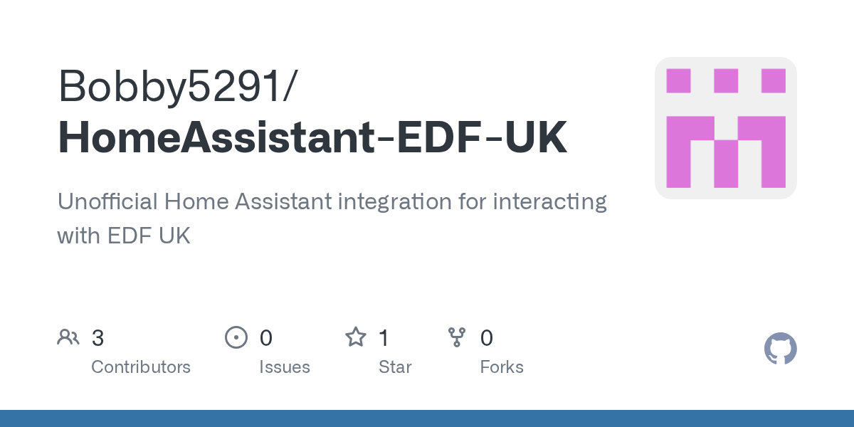

I have created an integration for EDF UK that lets you access data such as current tariff standing charges and smart meter telemetry using EDF new open API
