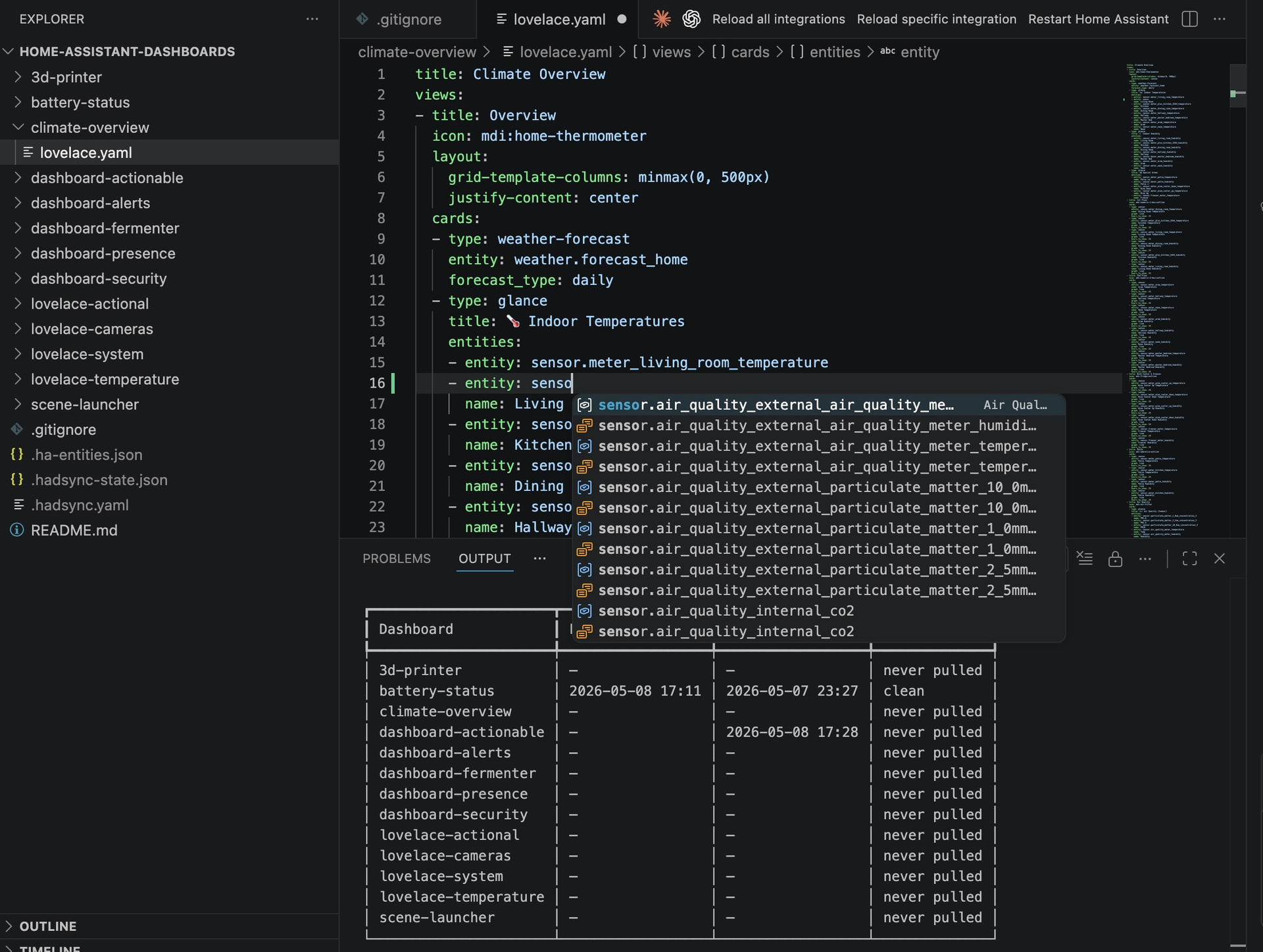

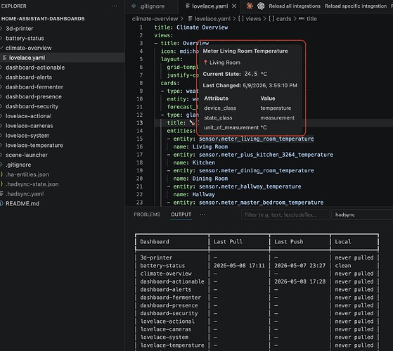

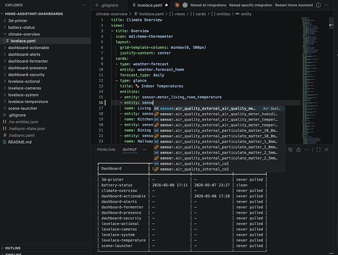

Another screenshot for Visual Code plugin: Combined with the Home Assistant Config Helper extension, the editor gains live entity state awareness — completions show friendly names from your real HA instance, and validation catches unknown or removed entity IDs before they ever reach your dashboard:
