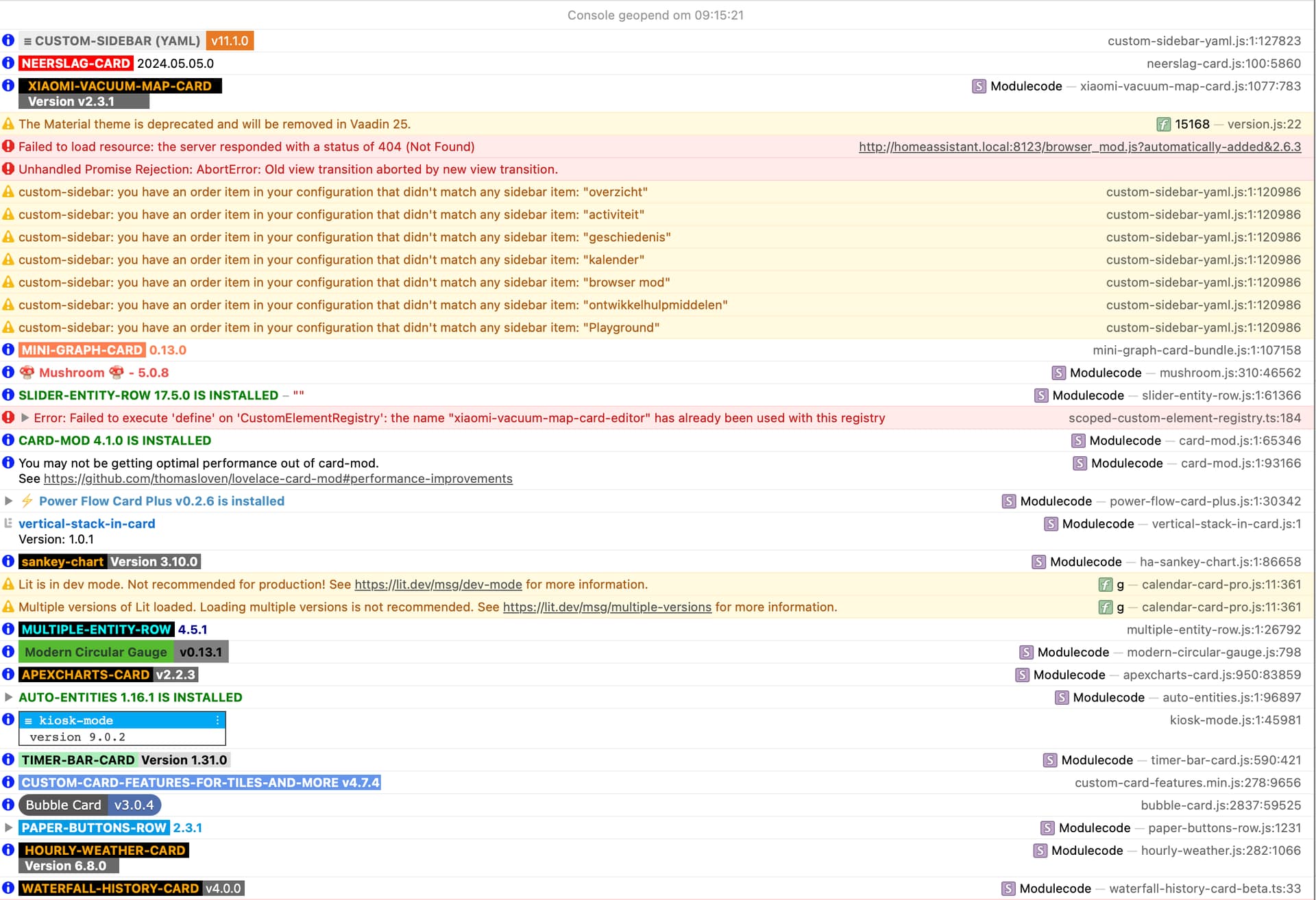

Good tip. And I did, it’s as colorful as my Christmas tree… but I am not sure what to do…

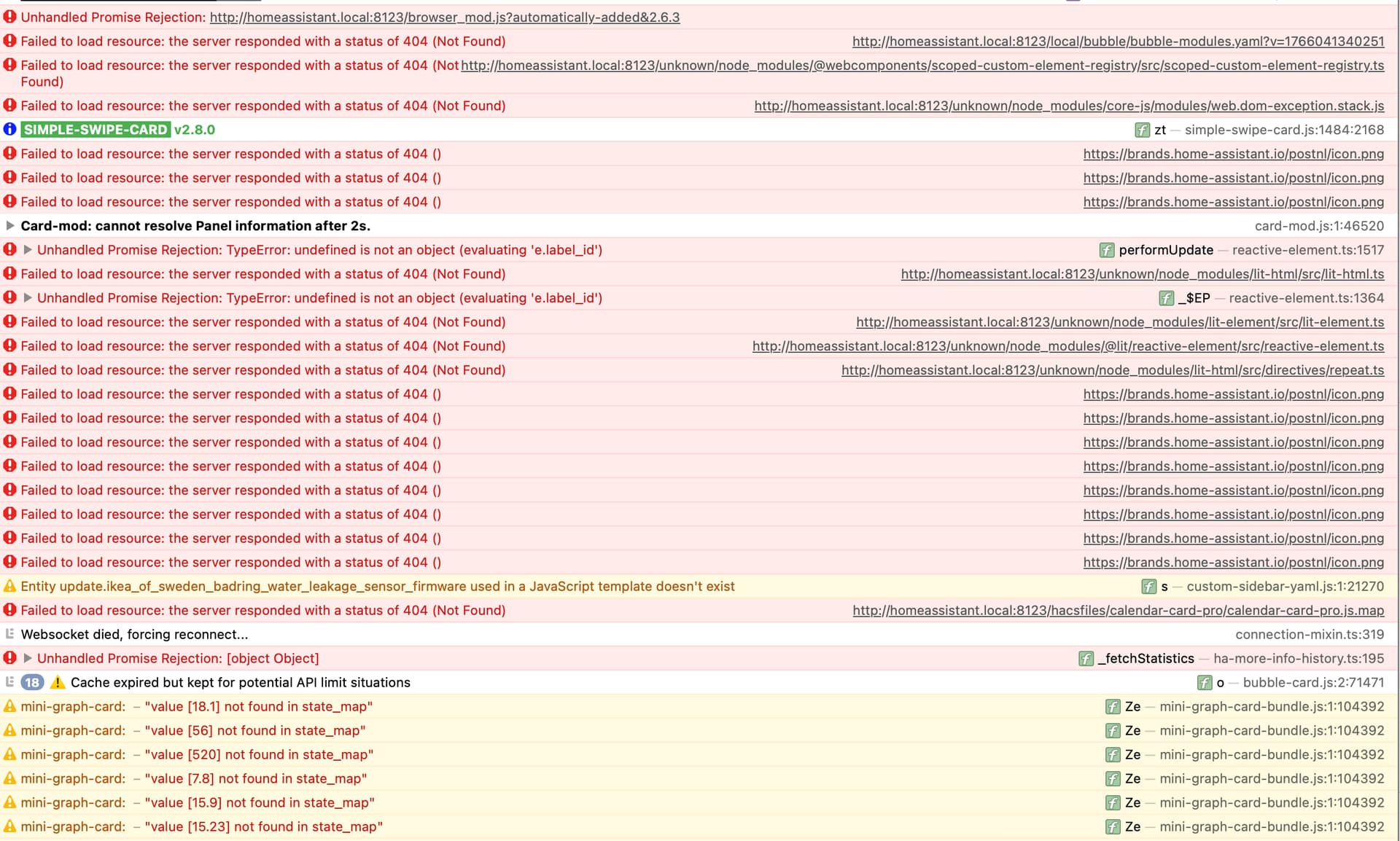

This is the output. The list of mini-graph goes on.

That is a huge amount of custom cards. Simplify.
You also appear to have network issues. Lots of unreachable resources.
