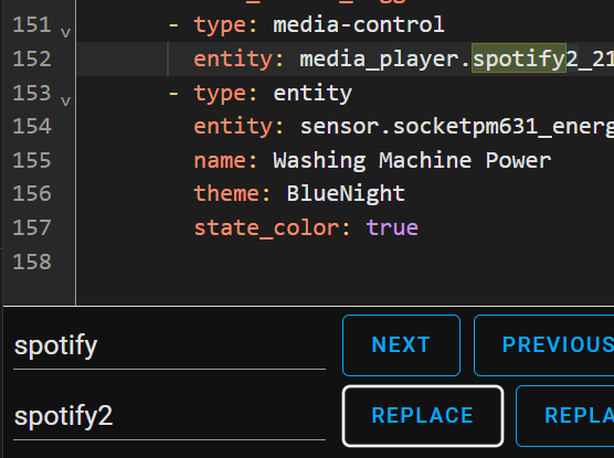

Also when I adjust a dashboard and I go to the “raw configuration editor” and search for something via CTRL+F, the view doesn’t jump to that line.

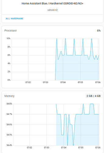

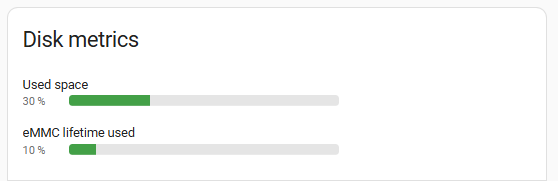

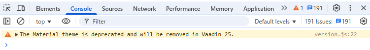

Start with checking available memory, disk space, memory swap, memory processor load, presence of errors /warnings in HA log and a browser console.
Restarted HA

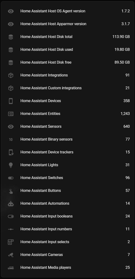

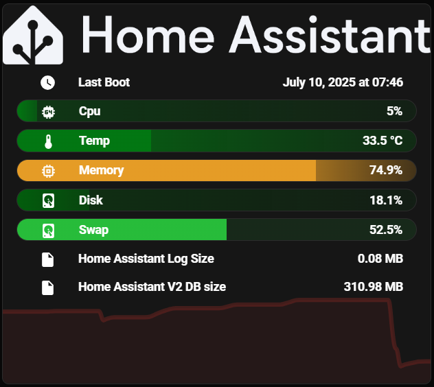

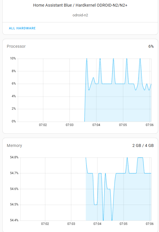

Processor, memory and disk space seems OK :

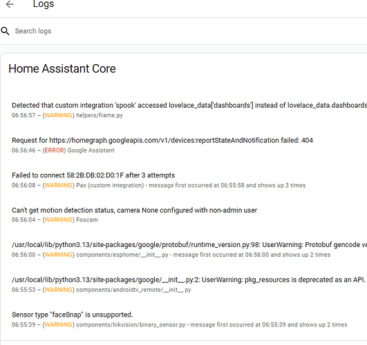

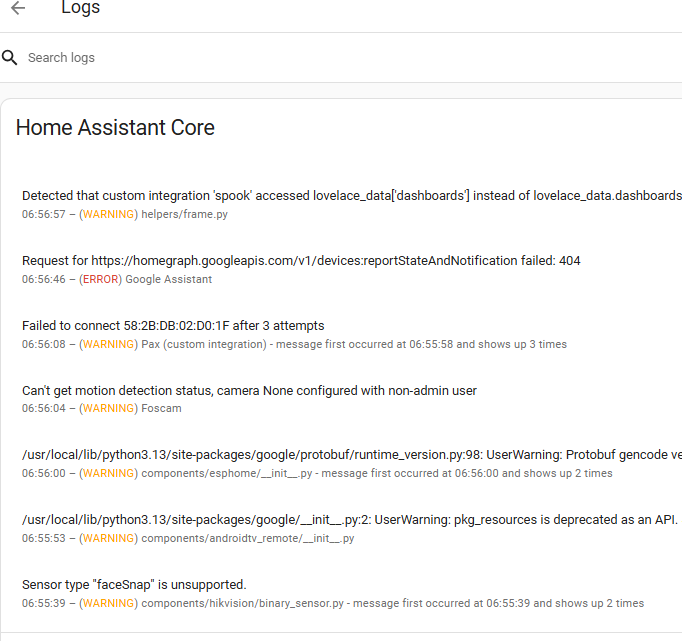

Nothing special in the log :

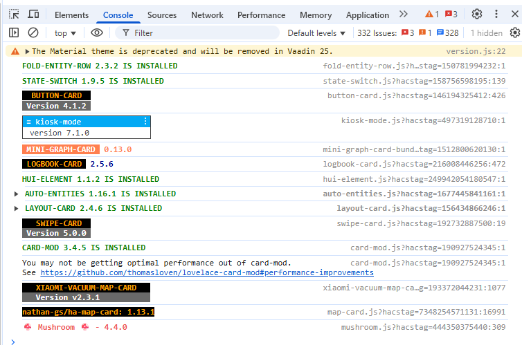

Browser console can be shown in code inspector in chrome, other browsers have similar tools.

It seems to find the string I’m searching for - I tried that with a careful ‘Search & Replace’ - but the editor doesn’t jump to the respective line to show it to me.

Search & Replace works perfectly fine here - first click of Replace takes me to the string I’m interested in. Second click replaces the string.

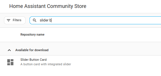

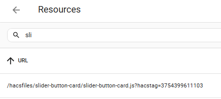

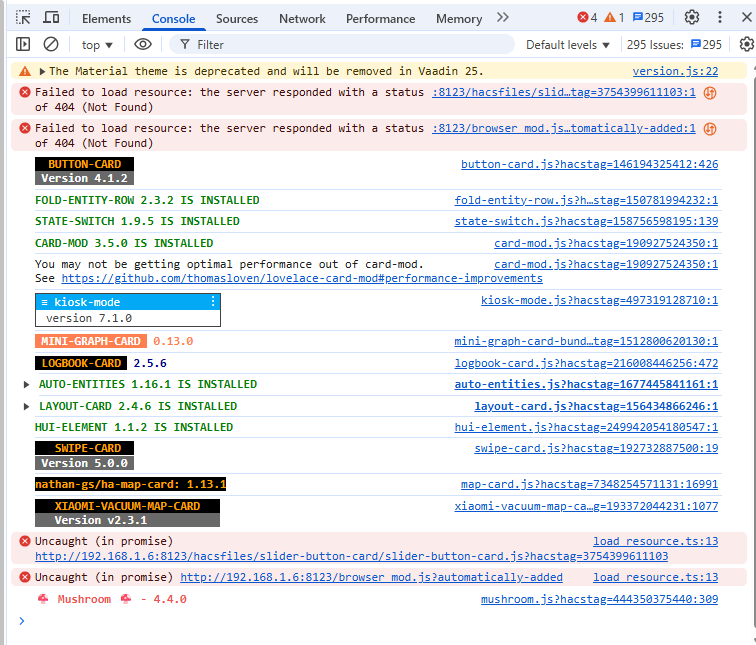

Seems there is a problem with the slider button card and browser mod.
I don’t have (anymore) the slider-button-card in hacs :
But found a reference in resources, so I deleted it :
And restarted HA.
When calling the script I get this :
Seems a lot better, but still takes 10 seconds to load the automation.

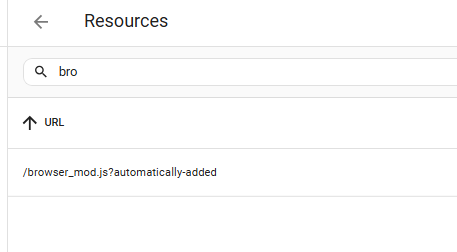

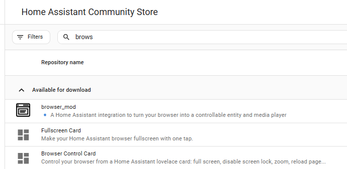

Remove browser- mod for testing.
And update card-mod.
Same here, I don’t have it anymore :
But I see it in the resources, so I deleted it :
Now 5-6 seconds to load :slight_smile:
Card-mod version is already v3.5.0
But after deleting my browser data (except cookies) the problem is back ? So I restarted ha again and now it’s OK again ? :crossed_fingers:
Downgrade your version of v3.5.0 to v3.4.5. There was many problems with v3.5.0
Did the downgrade. Restarted ha, deleted data from browser, restarted my laptop…automation needs about 38 seconds to load :disappointed_relieved:
Remove mushroom for test.
And you still have errors in console.
