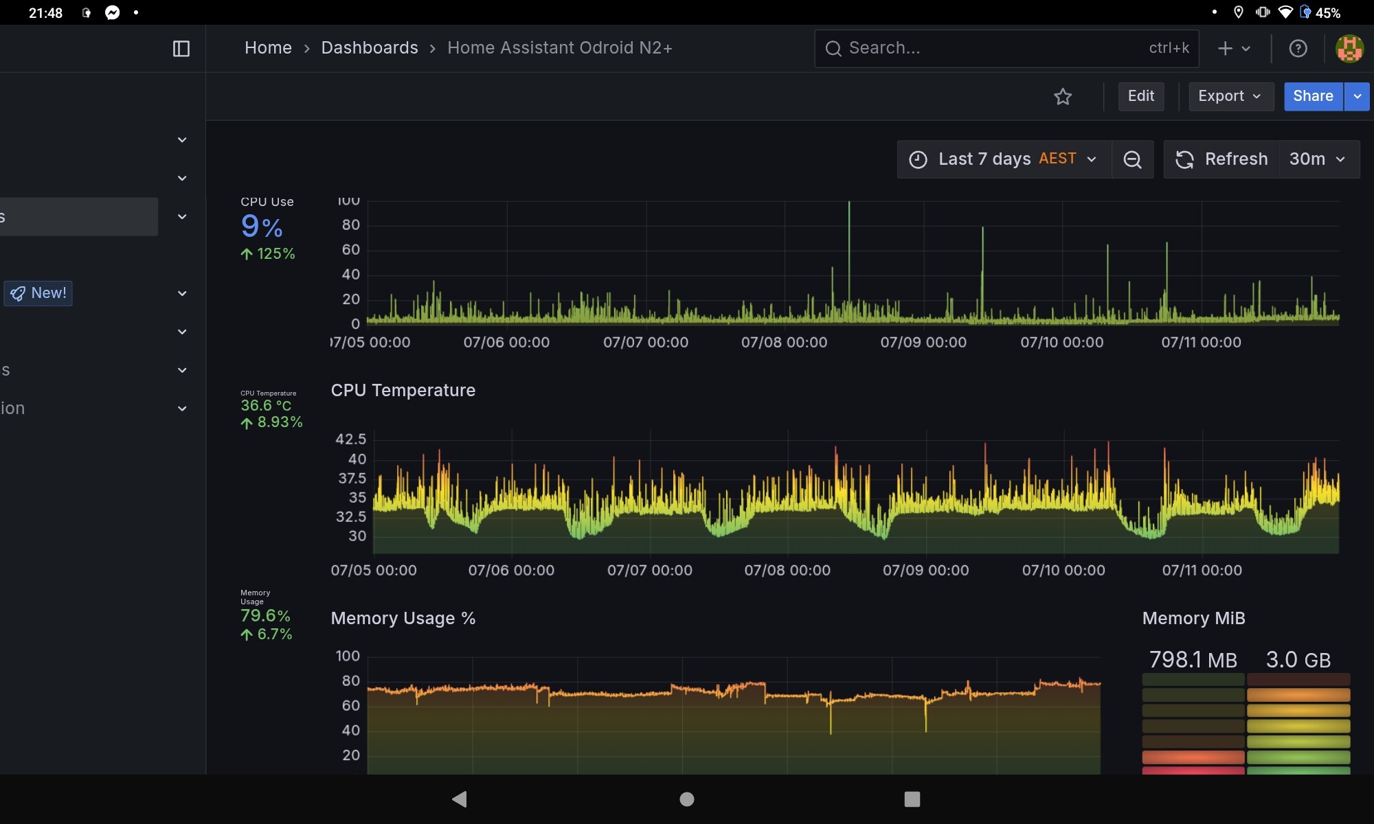

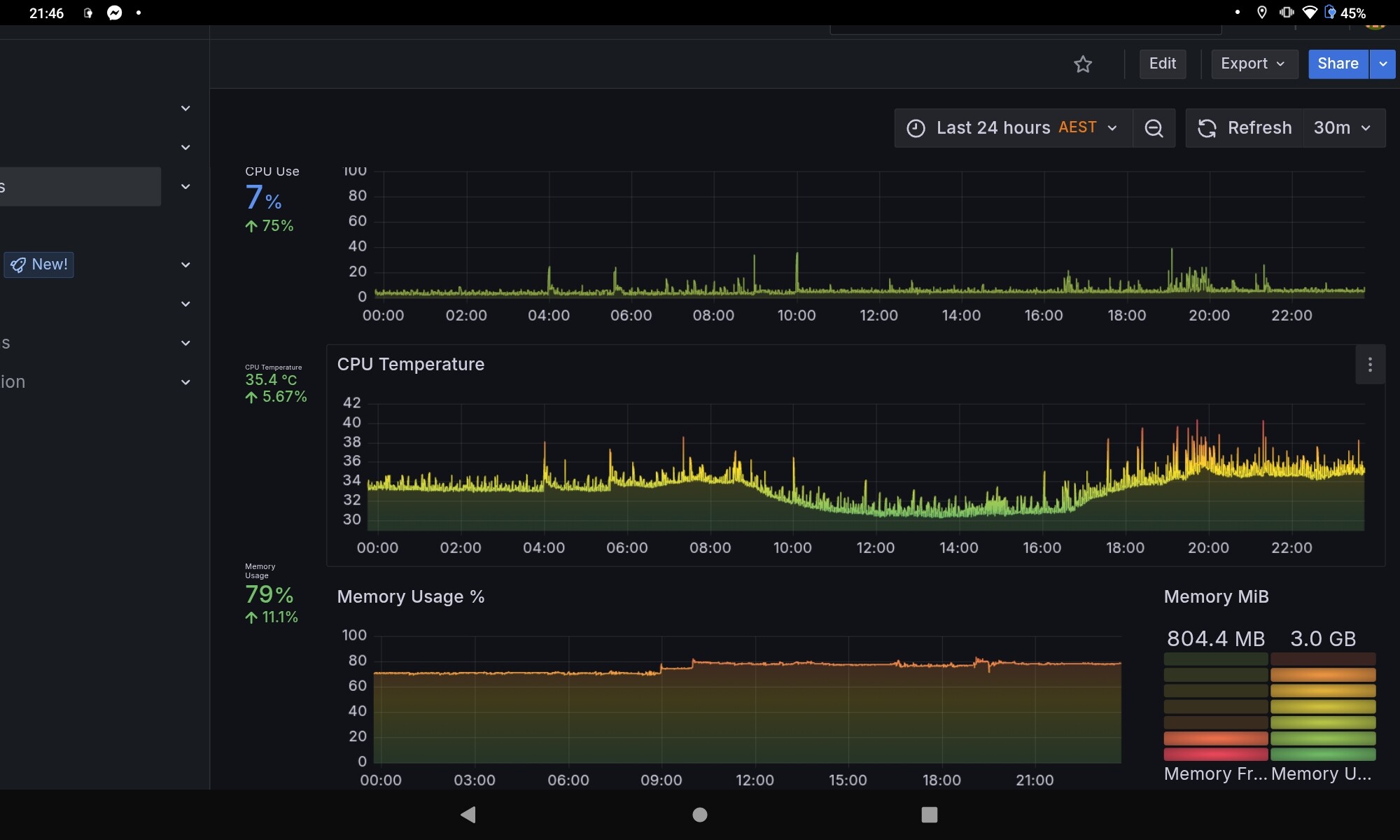

And still the question posted above about a processor load… assume some process like python consumes a lot of cpu.
His processor load of 10% spikes seems pretty typical for an Odroid N2+
This is mine in the last 24hrs.
And past 7 days

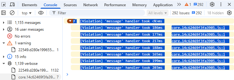

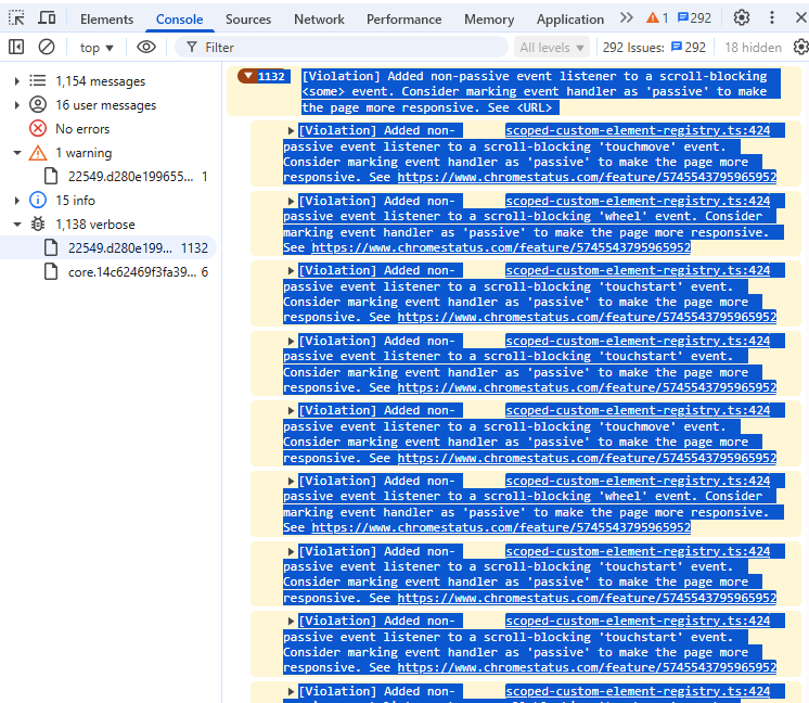

I had my console open when I called the automation. Suddenly these ‘verbose’ run up !
So that’s the reason, now the solution ??
Just installed 2025.9.1 and the problem is gone ! :grinning:
