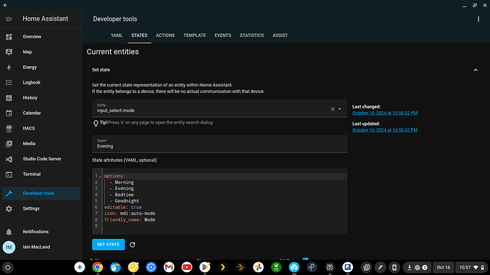

This appears to have changed again, or I had a bug… I could not get the settings to show for the input_select, and was unable to edit it following any suggestions here.
In the end, I went to develop options, clicked on the states tab, filtered for my input_select and then modified it from that screen.
After a restart this went back to previous settings, I am not sure how to change input select options for a helper made through UI.

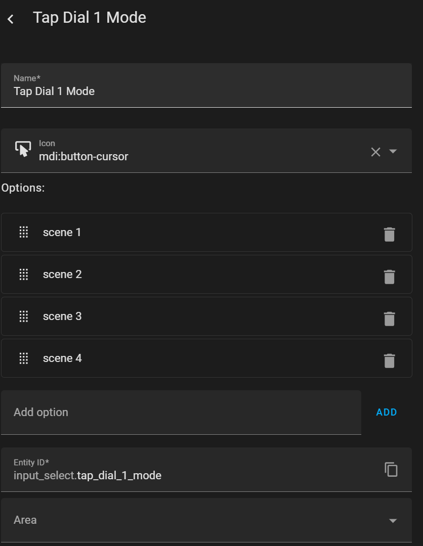

Not sure which specific helper you’re referring to, but the settings on my input select allows me to add, remove and reorder everything in the UI without needing to mess around with hidden files:
