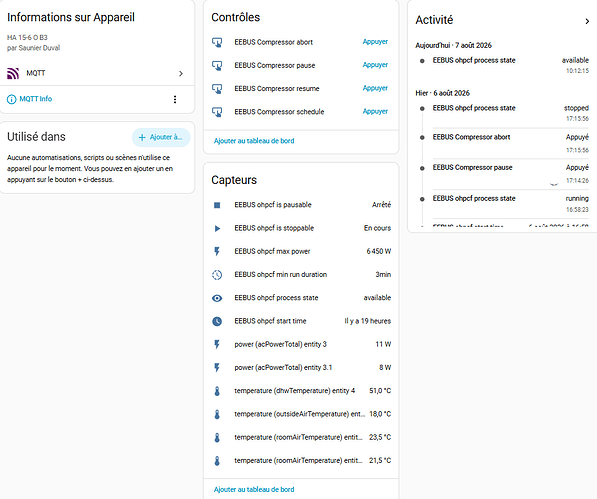

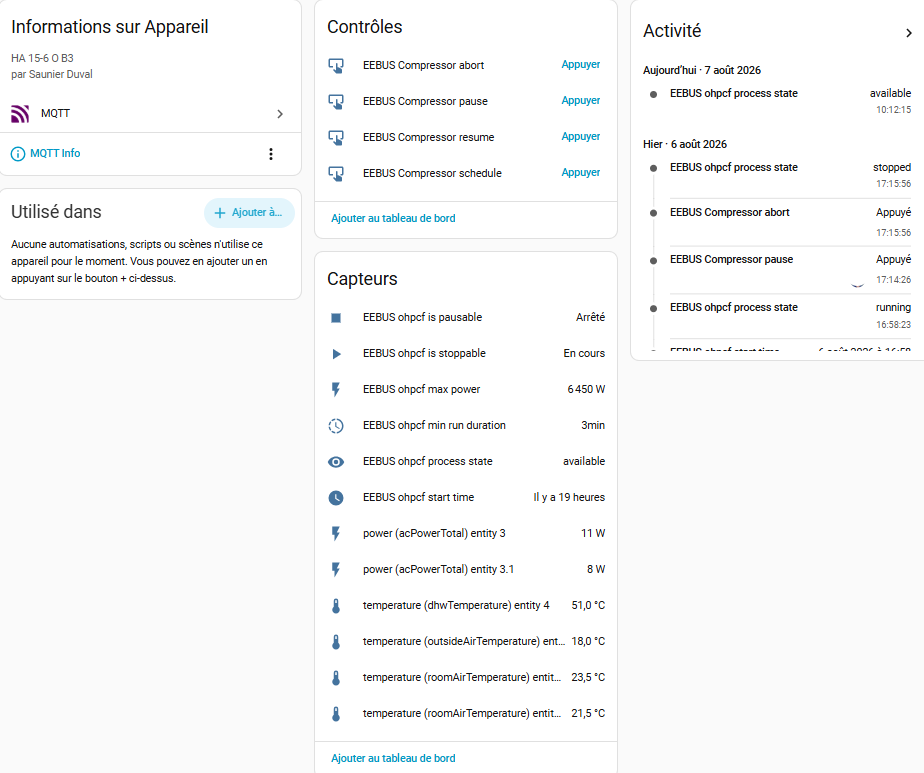

Thanks for this. I have it working. What do the sensors “power (acPowerTotal) entity 3” and “power (acPowerTotal) entity 3.1” relate to as I am a bit confused.
Entity 3 corresponds to the total instantaneous power consumption, while entity 3.1 represents the instantaneous power consumption of the outdoor unit only.
So, for example, when the outdoor unit starts running, you should see a value on 3.1 and a value on 3, where 3 is the sum of 3.1 plus the rest of the system’s consumption.
To get the energy consumption in kWh, you need to add the integration called “Integral Sensor” and apply it to entity 3.
