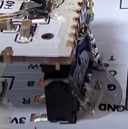

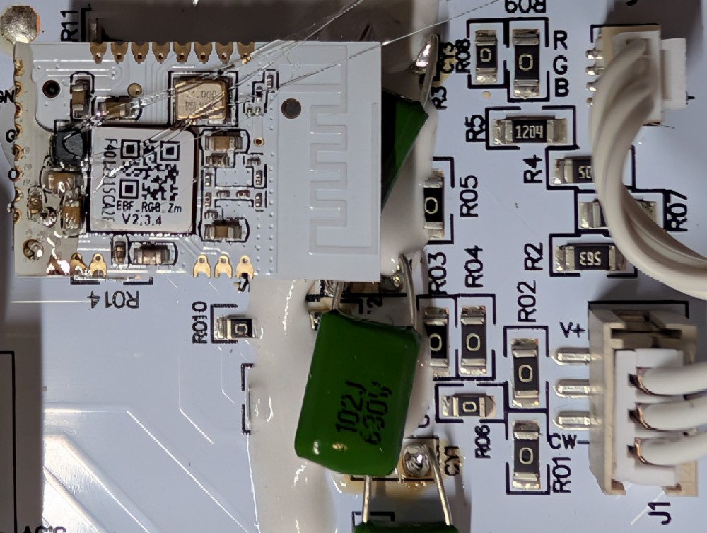

I opened the light and it looks like it’s not that difficulty to add an additional controller:
I probably will attach an ESP32-C6 which I already successfully tested before with the RGB Zigbee light example.
Hey. Wondering if it’s possible to just disable the RGB physically and easily? Do you know how to do that?
