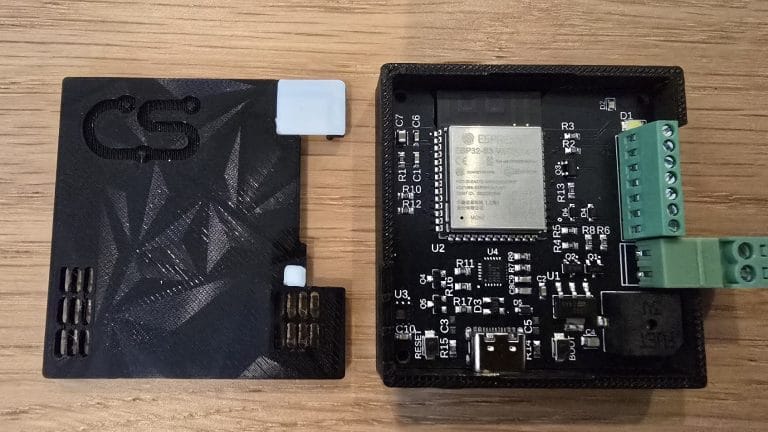

Here is another product that looks interesting. It seems to have great instructions:
RATgdo then. It was an open source project, so you would then see the one on the CircuitSetup as a derivative product.
