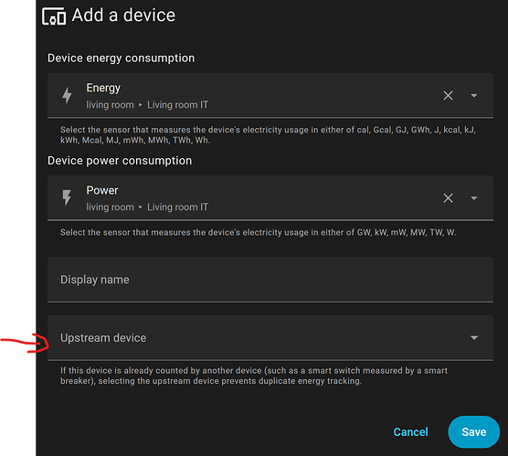

I have generated the power sensor below and would like to use this as an upstream device (see screenshot from energy dashboard).

In the developer tools the sensor shows the values it should and updates. But I cannot select it from the drop down menu in the energy dashboard.
What am I missing??
