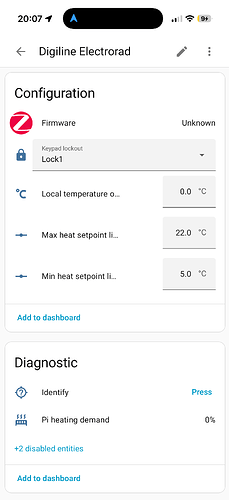

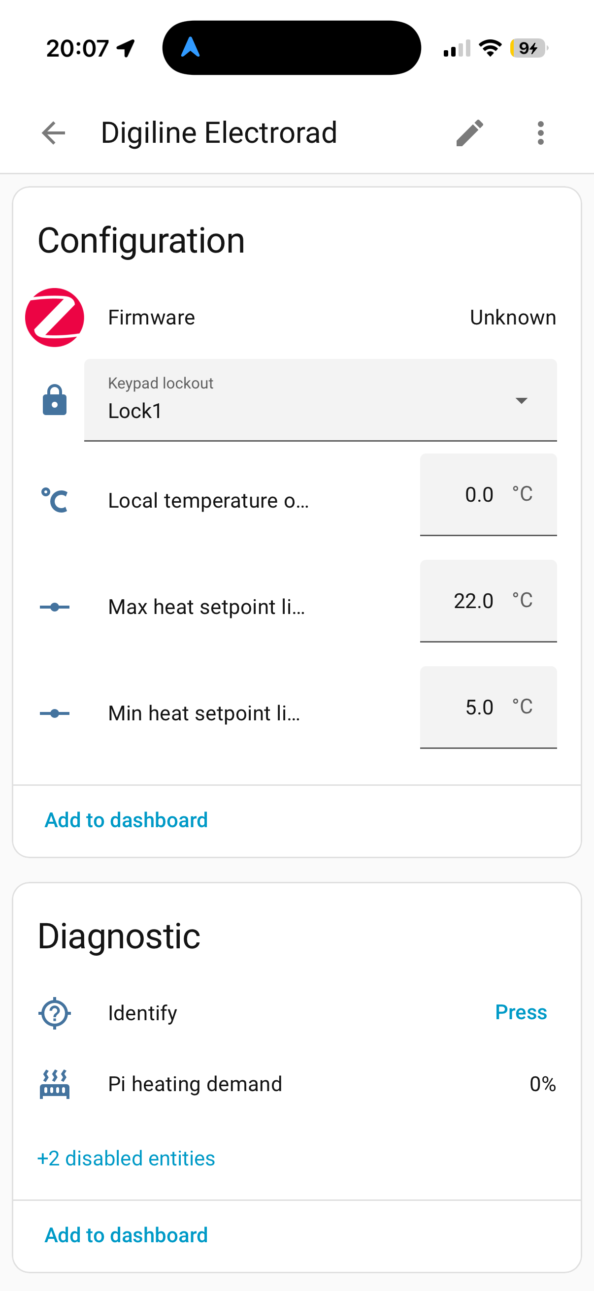

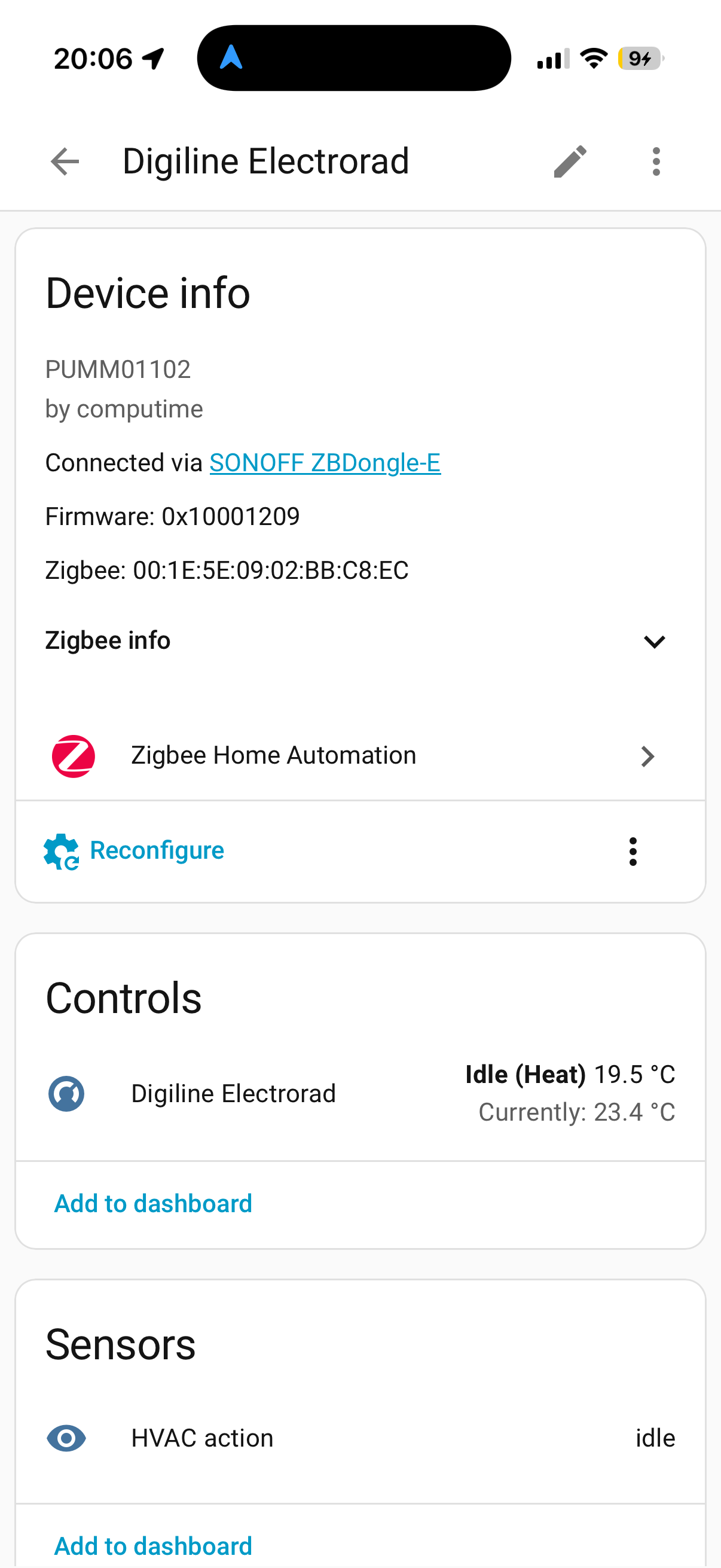

So, Electorad’s Digiline Zigbee worked just fine! All I needed was to be able to control the target temperature at different time intervals and it’s more than good enough for that:
I’d happily recommend it if you need a Zigbee connected electric radiator.
