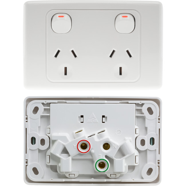

I’m not sure what power outlets are like in your country, or John’s, but here in my country the outlet switches are integrated into the socket. So you can’t break out the switch contacts for connection to the Shelly.
Just something to keep in mind if using relay modules.

As @tom_l above has pointed out, sockets have integrated switches, meaning that modules like Shelly are out of the question. You will run into the issue where turning on a relay via HA will do nothing because the physical switch is off, or trying to turn on the physical switch but getting no power because the relay module is switched off.
Basically, the only scenarios where modules will work for you is to switch stuff off - turning them on will require both the relay and the switch to be on.

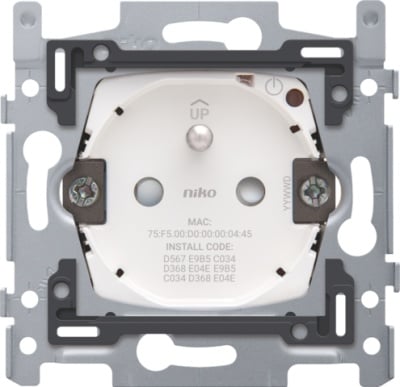

If you are redoing it anyway I would not got any thing based on wireless tech (WiFi, zigbee or whatever…) there are options with wired connections which are way more stable (and also not that expensive)…
See www.immo-vernetzer.de (sorry, in German only)
Well, the main problem with wired solutions is “bulkness” - devices are way bigger than wireless ones, especially if you include rj45 connector/socket. Also price difference is not that small. When you have a bunch of them it adds up to usually already over-budgeted renovation.
But, as you said, they are more stable, that’s true.
I think that if i’d renovate i would still draw some sort of signal cable (utp, i guess) with power ones to each socket. You never know when it comes handy.
why do u need utp to power socket?
Just in case… :grin:
you never know what module you’ll install in a certain hole… basically it doesn’t have to be utp, it can be any small signal cable, but if it’s utp there’s a chance to put ethernet module inside instead wifi (for example).
I guess it’s the part of “better safe than sorry”, or in this case: better to have unused cable inside than draw it in later, when power cables are already inside and you have all nicely finished.
Not at all, check the link…. You can use the same switches and sockets you had before (it’s a 1:1 wiring to a central control unit)
