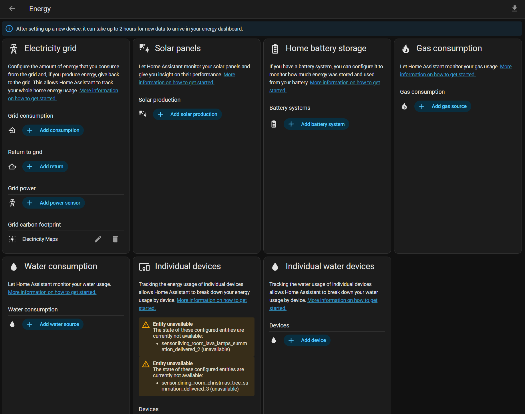

This is what the Energy Dashboard looks like:

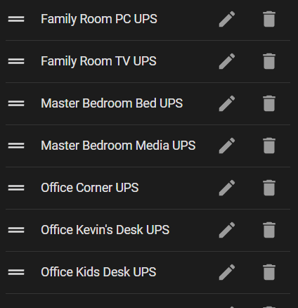

And while a couple devices are offline, I have a bunch that aren’t:
I used to have that dashboard showing; even last month! Not sure what changed in the latest version, but it’s all gone now :frowning:.
Is there something special I have to do to get the old Energy dashboard to show? I was hoping to checkout those realtime stats!
Since .12 when I go to http://homeassistant.local:8123/energy it redirects me to http://homeassistant.local:8123/config/energy?historyBack=1. So like you, I also only see the configuration page.
