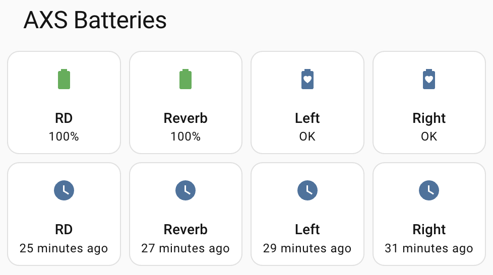

My bike has electronic shifting (SRAM AXS), which is great until the derailleur battery dies mid-ride. The two official ways to check it are the SRAM phone app, which you open while standing next to the bike, and the head unit, which tells you mid-ride when it is already too late. I wanted to know before I kit up, and I wanted Home Assistant to notify me the way it does about smoke detector batteries, so I built esphome-sram-axs.

Finding your serials is the first flash. Discovery is always on, with no flag and no phone app: flash the example config as-is (the placeholder serials are fine), leave esphome logs running, wake the bike, and every component you haven’t configured yet announces itself once:

Per component you get voltage in mV, percent for the pack components, the status string for coin cells, RSSI, and last-seen.
