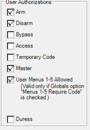

I figured it out. In the ELKRP the Bypass option was checked for the user. I unchecked that and it works now.
