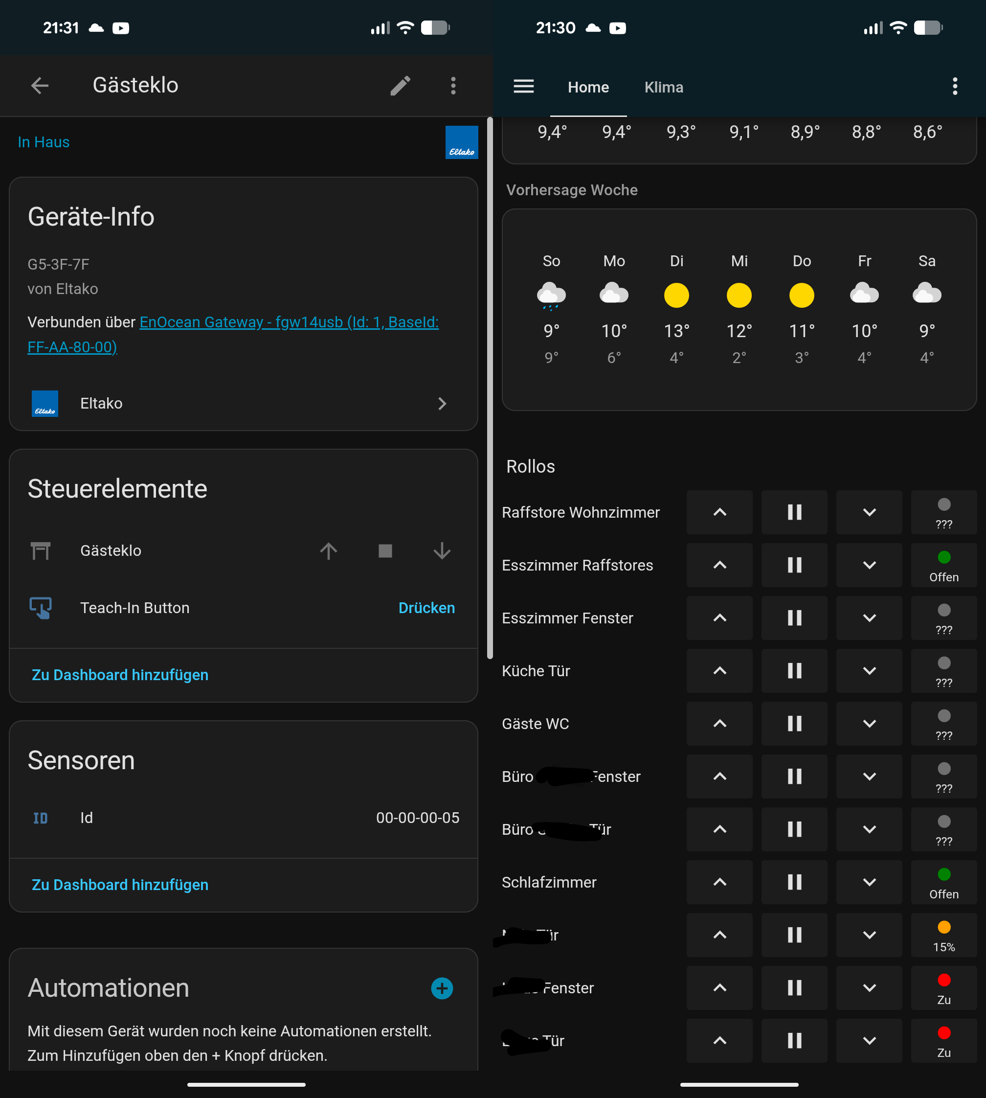

Unfortunately, I am very new to home assistant. I am currently switching my control center from myhomeControl (Bootup) to home assistant because my old PC crashed.
I am using FAM14 and FGW14 (IMPORTANT: not FGW14-USB) but via a COM cable that is connected to HA with an adapter to USB. And, of course, a few actors (see configuration).
I have installed everything so far, HACS and the plugin, I have read the configuration via Enocean Device Manager (eo_man), and clicked “Write HA sender to devices.”
When I then save the configuration, I get the following message: "invalid literal for int() with base 16: 00-00-B0-01 do you want to try to continue
I decided to continue for the time being.

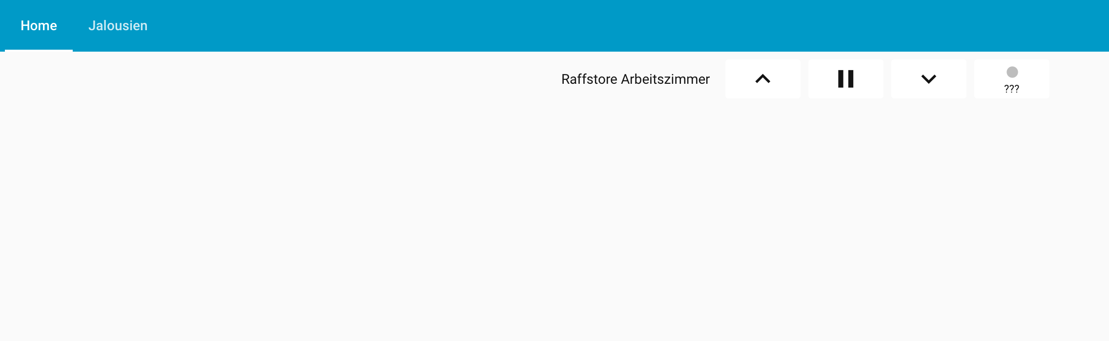

My problem is that I can control the lights on and off (very quickly), but unfortunately HA does not show the current status of the lights, and I cannot move my blinds either.
When starting HA, the following errors appear in the log
Logger: homeassistant.components.cover
Quelle: helpers/entity_platform.py:676
Integration: Abdeckung ([Dokumentation](https://www.home-assistant.io/integrations/cover), [Probleme](https://github.com/home-assistant/core/issues?q=is%3Aissue+is%3Aopen+label%3A%22integration%3A+cover%22))
Erstmals aufgetreten: 14:21:49 (14 Vorkommnisse)
Zuletzt protokolliert: 14:21:49
Error adding entity cover.eltako_gw_1_00_00_00_20 for domain cover with platform eltako
Error adding entity cover.eltako_gw_1_00_00_00_21 for domain cover with platform eltako
Error adding entity cover.eltako_gw_1_00_00_00_22 for domain cover with platform eltako
Error adding entity cover.eltako_gw_1_00_00_00_23 for domain cover with platform eltako
Error adding entity cover.eltako_gw_1_00_00_00_24 for domain cover with platform eltako
  File "/usr/src/homeassistant/homeassistant/helpers/entity_platform.py", line 676, in _async_add_entities
    await self._async_add_entity(
        entity, False, entity_registry, config_subentry_id
  File "/usr/src/homeassistant/homeassistant/helpers/entity_platform.py", line 1002, in _async_add_entity
    await entity.add_to_platform_finish()
  File "/usr/src/homeassistant/homeassistant/helpers/entity.py", line 1380, in add_to_platform_finish
    await self.async_added_to_hass()
  File "/config/custom_components/eltako/device.py", line 99, in async_added_to_hass
    self.load_value_initially(latest_state)
  File "/config/custom_components/eltako/cover.py", line 120, in load_value_initially
    raise e
  File "/config/custom_components/eltako/cover.py", line 88, in load_value_initially
    self._attr_current_cover_position = latest_state.attributes['current_position']
KeyError: 'current_position'
and one more:
Logger: eltako
Quelle: custom_components/eltako/gateway.py:253
Integration: Eltako ([Dokumentation](https://github.com/grimmpp/home-assistant-eltako), [Probleme](https://github.com/grimmpp/home-assistant-eltako/issues))
Erstmals aufgetreten: 14:21:49 (3 Vorkommnisse)
Zuletzt protokolliert: 14:38:36
EnOcean Gateway - fgw14usb (Id: 1) (FF-B0-FB-80): Maybe have wrong device id configured!
EnOcean Gateway - fam14 (Id: 2) (FF-B0-FB-80): Maybe have wrong device id configured!

Thanks so much!
I can actually control the Shutter with your template, using the up an down buttons.
But the status keeps staying grey with the question marks.
FAM14 is on BA4, so there should be feedback telegrams.
