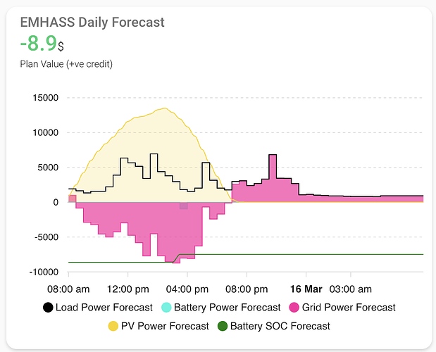

  "pv_power_forecast": [
    7.4181, 9.0889, 10.5273, 11.7604, 12.7256, 13.5107, 14.0035, 14.2905, 14.3557, 14.1663, 13.756, 13.1713, 12.2564, 11.1387, 9.7234, 7.7384, 5.5771, 3.6349, 1.7682, 0.3907,
    0.0287, 0, 0, 0, 0, 0, 0, 0, 0, 0, 0, 0, 0, 0, 0, 0, 0, 0, 0, 0, 0, 0, 0, 0, 0.2146, 1.0774, 2.6719, 4.2955
I use W instead of kW, also for the battery settings. Don’t know if that’s the issue what you see.
Thank you so much! That was definitely an error!
It’s still not reporting any battery optimisations. I have battery configuration in Watts, and soc_init and soc_final as a value between 0-1.
  "battery_charge_efficiency": 0.95,
  "battery_charge_power_max": 4997,
  "battery_discharge_efficiency": 0.95,
  "battery_discharge_power_max": 5000,
  "battery_dynamic_max": 0.9,
  "battery_dynamic_min": -0.9,
  "battery_maximum_state_of_charge": 0.99,
  "battery_minimum_state_of_charge": 0.05,
  "battery_nominal_energy_capacity": 10000,
  "battery_target_state_of_charge": 0.1,
Any clue?
It almost feels like the battery is not configured / enabled in the settings. Or the Forbid charging battery from or from the grid is turned on. What settings under Battery have you configured.
Yes it seems that way, very odd. Here’s the config:
  "set_nocharge_from_grid": false,
  "set_nodischarge_to_grid": false,
  "set_total_pv_sell": false,
  "set_use_battery": true,
  "set_use_pv": true,
(full config here)

  "battery_target_state_of_charge": 1,
  "compute_curtailment": false,
  "continual_publish": true,
  "costfun": "profit",
  "delta_forecast_daily": 1,
  "end_timesteps_of_each_deferrable_load": [
    0,
    0,
    0,
    0,
    0
  "historic_days_to_retrieve": 2,
  "inverter_is_hybrid": true,
  "load_cost_forecast_method": "csv",
  "load_forecast_method": "naive",
  "load_negative": false,
  "load_offpeak_hours_cost": 0.1419,
  "load_peak_hour_periods": {
    "period_hp_1": [
        "start": "02:54"
        "end": "15:24"
    "period_hp_2": [
        "start": "17:24"
        "end": "20:24"
  "load_peak_hours_cost": 0.1907,
  "logging_level": "INFO",
  "lp_solver": "default",
  "lp_solver_path": "empty",
  "maximum_power_from_grid": 9000,
  "maximum_power_to_grid": 9000,
  "method_ts_round": "nearest",
  "modules_per_string": [
    16
  "nominal_power_of_deferrable_loads": [
    2000,
    1000,
    1000,
    1000,
    1000
  "number_of_deferrable_loads": 5,
  "operating_hours_of_each_deferrable_load": [
    2,
    1,
    1,
    1,
    2
  "optimization_time_step": 60,
  "photovoltaic_production_sell_price": 0.1419,
  "production_price_forecast_method": "csv",
  "pv_inverter_model": [
    "Fronius_International_GmbH__Fronius_Primo_5_0_1_208_240__240V_"
  "pv_module_model": [
    "CSUN_Eurasia_Energy_Systems_Industry_and_Trade_CSUN295_60M"
  "sensor_linear_interp": [
    "sensor.total_dc_power",
    "sensor.power_load_no_var_loads"
  "sensor_power_load_no_var_loads": "sensor.power_load_no_var_loads",
  "sensor_power_photovoltaics": "sensor.total_dc_power",
  "sensor_replace_zero": [
  "set_battery_dynamic": true,
  "set_deferrable_load_single_constant": [
    false,
    false,
    false,
    false,
    false
  "set_deferrable_startup_penalty": [
    0,
    0,
    0,
    0,
    0
  "set_nodischarge_to_grid": true,
  "set_use_pv": false,
  "set_zero_min": true,
  "start_timesteps_of_each_deferrable_load": [
    0,
    0,
    0,
    0,
    0
  "strings_per_inverter": [
    1
  "surface_azimuth": [
    205
  "surface_tilt": [
    30
  "treat_deferrable_load_as_semi_cont": [
    true,
    true,
    true,
    true,
    false
  "weather_forecast_method": "csv",
  "weight_battery_charge": 1,
  "weight_battery_discharge": 1
In config I am using the these rest commands
# run by script
emhass_naive_mpc_optim_script:
  url: http://localhost:5000/action/naive-mpc-optim
  method: POST
  content_type: "application/json"
  payload: >
    { {{json}} }
# publish data via Rest command
publish_data2:
  url: http://localhost:5000/action/publish-data
  method: POST
  payload: "{}"
The script that I am using:
alias: EMHASS Naive MPC optim call
mode: single
variables:
  json_string: >
    {%- set nordpool=((state_attr('sensor.nordpool_kwh_fi_eur_6_10_0',
    'raw_today') | map(attribute='value') | list+
    state_attr('sensor.nordpool_kwh_fi_eur_6_10_0', 'raw_tomorrow') |
    map(attribute='value') | list))[now().hour:][:24] %} {%- set nordpool_sell =
    namespace(values=[]) %} {%- set nordpool_buy = namespace(values=[]) %} {%-
    for i in nordpool %}   {%- set
    nordpool_sell.values=nordpool_sell.values+[(((i)-(states('input_number.export_margnial')|float*0.01))
    |round(5),0)|max]%} {%- set
    nordpool_buy.values=nordpool_buy.values+[(i*((states('input_number.moms_skatt')|float/100)+1)+(states('input_number.import_marginal')|float*0.01)+(states('input_number.overforings_avgift_import')|float*0.01)+(states('input_number.elskatt')|float)*0.01)|round(5)]%}
    {%- endfor %} {%- set
    solcast=((state_attr('sensor.solcast_pv_forecast_forecast_today','detailedHourly')
    | map(attribute='pv_estimate') | map('multiply',1000) | map('int') | list +
    state_attr('sensor.solcast_pv_forecast_forecast_tomorrow', 'detailedHourly')
    list))[now().hour:][:24] %} {%- set soc_init =
    min(max((states('sensor.battery_level')|float(0)/100)|round(2),0.1),1)%}
    {%-set horizon = [nordpool_sell.values|length,
    nordpool_buy.values|length,solcast|length]|min %} "prediction_horizon": {{
    horizon }}, "soc_init":{{soc_init }} , "soc_final": 1,  "num_def_loads":
    6,   "def_total_hours":[3,1,1,1,1,1],   "P_deferrable_nom":
    [2000,1000,1100,1500,500,500],
    "treat_def_as_semi_cont":[true,true,true,true,false,false],
    "def_start_timestep":[0,0,0,0,0,0], "def_end_timestep":[12,12,12,12,6,6],
    "set_def_constant": [false,false,false,false,true,true],
    "load_cost_forecast":{{nordpool_buy.values}},  "prod_price_forecast":
    {{nordpool_sell.values}}, "pv_power_forecast":{{solcast}}, "alpha": 0.2,
    "beta": 0.8
sequence:
  - data:
      json: "{{ json_string }}"
    action: rest_command.emhass_naive_mpc_optim_script
And some automation to run everything:
alias: EMHASS mpc optim script
description: ""
triggers:
  - minutes: /5
    trigger: time_pattern
  - event: start
    trigger: homeassistant
conditions: []
actions:
  - delay:
      hours: 0
      minutes: 0
      seconds: 5
      milliseconds: 0
  - action: script.1694970038100
    data: {}
  - delay:
      hours: 0
      minutes: 0
      seconds: 15
      milliseconds: 0
  - data: {}
    action: rest_command.publish_data2
mode: single
And as I said before. In 10.6 everything is working fine… But not in 12.8
