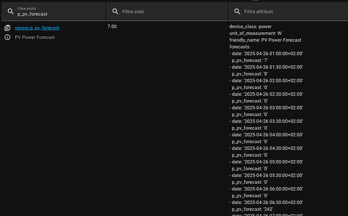

I’m not using the ml forecaster.
Just a simple naive MPC method, with PV power forecast coming from forecast.solar, which I manually pass to EMHASS.
p_pv_forecast is actually created by EMHASS
Did you changed the set_use_pv parameter to True?
Yes
