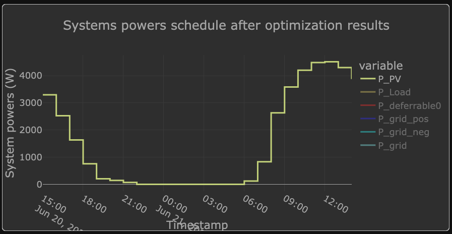

Hi everyone,
first of all: very nice but also very complex project.
I’m struggling with several aspects, but first I’d like to get my pv forecast right.
Right now I’m pretty off with it: 4kw vs 12kw in reality at peak.
My setup is: three strings (east, south, west) with 12,11,12 module each 450W, one inverter with nominal power 18kw (KACO blueplanet hybrid nh3).
Neither the modules nor the inverter is in the pvlib list, so I went for some Trina Solar modules with 465W and tried different configurations of inverters and strings_per_inverter.
Unfortunately I seem to misunderstand something because forecast is always far too little.

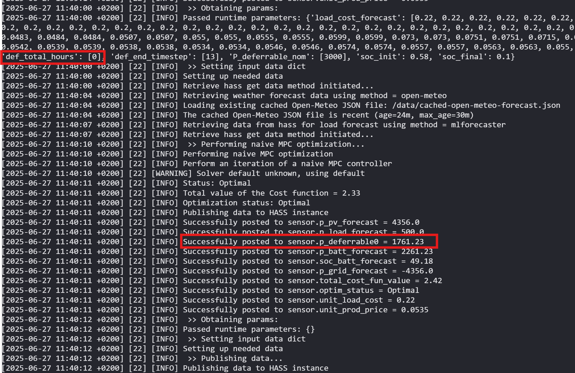

Thanks, that already improved it. However, optimization status is infeasible now.
[2025-06-21 15:55:38 +0200] [20] [INFO] >> Obtaining params:
[2025-06-21 15:55:38 +0200] [20] [INFO] Passed runtime parameters: {‘load_cost_forecast’: [0.18732, 0.19268, 0.26397, 0.31271, 0.34478, 0.3791, 0.38928, 0.36011, 0.33443, 0.32128, 0.31285, 0.30856, 0.3022, 0.29931, 0.29724, 0.27823, 0.22404, 0.19258, 0.19247, 0.17936, 0.14669, 0.11236, 0.07476, 0.09619], ‘def_total_hours’: [5]}
[2025-06-21 15:55:38 +0200] [20] [INFO] >> Setting input data dict
[2025-06-21 15:55:38 +0200] [20] [INFO] Setting up needed data
[2025-06-21 15:55:38 +0200] [20] [INFO] Retrieving weather forecast data using method = open-meteo
[2025-06-21 15:55:38 +0200] [20] [INFO] Loading existing cached Open-Meteo JSON file: /data/cached-open-meteo-forecast.json
[2025-06-21 15:55:38 +0200] [20] [INFO] The cached Open-Meteo JSON file is recent (age=2m, max_age=30m)
[2025-06-21 15:55:39 +0200] [20] [INFO] Retrieving data from hass for load forecast using method = naive
[2025-06-21 15:55:39 +0200] [20] [INFO] Retrieve hass get data method initiated…
[2025-06-21 15:55:41 +0200] [20] [INFO] EMHASS server online, serving index.html…
[2025-06-21 15:55:45 +0200] [20] [INFO] >> Performing dayahead optimization…
[2025-06-21 15:55:45 +0200] [20] [INFO] Performing day-ahead forecast optimization
[2025-06-21 15:55:45 +0200] [20] [INFO] Perform optimization for the day-ahead
[2025-06-21 15:55:45 +0200] [20] [WARNING] Solver default unknown, using default
[2025-06-21 15:55:45 +0200] [20] [INFO] Status: Infeasible
[2025-06-21 15:55:45 +0200] [20] [INFO] Total value of the Cost function = -859.72
[2025-06-21 15:55:45 +0200] [20] [INFO] Optimization status: Infeasible
I just realized that this was yesterdays status.
Today I get an optimal optimization status. Only thing that has changed is “def_total_hours”. Yesterday it was 5, today it is 3.
Is there a reason behind this??

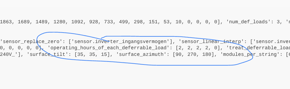

Why do I get infeasible here?
[2025-07-19 13:15:01 +0200] [21] [INFO] Perform an iteration of a naive MPC controller
[2025-07-19 13:15:01 +0200] [21] [DEBUG] Battery usage enabled. Initial SOC: 0.73, Final SOC: 0.24
[2025-07-19 13:15:01 +0200] [21] [DEBUG] Processing deferrable load 0
[2025-07-19 13:15:01 +0200] [21] [DEBUG] Load 0 is standard/non-thermal.
[2025-07-19 13:15:01 +0200] [21] [DEBUG] Load 0: Using total timesteps constraint: 8
[2025-07-19 13:15:01 +0200] [21] [DEBUG] Load 0: Standard load constraints set.
[2025-07-19 13:15:01 +0200] [21] [DEBUG] Deferrable load 0: Proposed optimization window: -14 --> 10
[2025-07-19 13:15:01 +0200] [21] [DEBUG] Deferrable load 0: Validated optimization window: 0 --> 10
[2025-07-19 13:15:01 +0200] [21] [DEBUG] Processing deferrable load 1
[2025-07-19 13:15:01 +0200] [21] [DEBUG] Load 1 is standard/non-thermal.
[2025-07-19 13:15:01 +0200] [21] [DEBUG] Load 1: Using total timesteps constraint: 2
[2025-07-19 13:15:01 +0200] [21] [DEBUG] Load 1: Standard load constraints set.
[2025-07-19 13:15:01 +0200] [21] [DEBUG] Deferrable load 1: Proposed optimization window: -2 --> 16
[2025-07-19 13:15:01 +0200] [21] [DEBUG] Deferrable load 1: Validated optimization window: 0 --> 16
[2025-07-19 13:15:01 +0200] [21] [DEBUG] Processing deferrable load 2
[2025-07-19 13:15:01 +0200] [21] [DEBUG] Deferrable load 2: Proposed optimization window: 2 --> 16
[2025-07-19 13:15:01 +0200] [21] [DEBUG] Deferrable load 2: Validated optimization window: 2 --> 16
[2025-07-19 13:15:01 +0200] [21] [INFO] Status: Infeasible
Can it be that ‘operating_timesteps_of_each_deferrable_load’ doesn’t work in EMHASS?
Can you show your inputs and configuration settings from earlier in the logs?
Here is some more info:
[2025-07-19 13:15:01 +0200] [21] [INFO]  >> Obtaining params:
[2025-07-19 13:15:01 +0200] [21] [INFO] Passed runtime parameters: {'entity_save': 'True', 'publish_prefix': 'mpc_', 'prediction_horizon': 22, 'pv_power_forecast': [3194, 5304, 5169, 4791, 4331, 3836, 3334, 2852, 2384, 1942, 1478, 1009, 661, 433, 260, 131, 46, 9, 0, 0, 0, 0, 0, 0, 0, 0, 0, 0, 0, 0, 0, 0, 0, 0, 23, 86, 197, 358, 556, 759, 962, 1168, 1390, 1650, 1895, 2065, 2175, 2248, 2318, 2400, 2425, 2352, 2210, 2032, 1863, 1689, 1489, 1280, 1092, 928, 733, 499, 298, 151, 53, 10, 0, 0, 0, 0], 'num_def_loads': 3, 'nominal_power_of_deferrable_loads': [2150, 2000, 0], 'operating_timesteps_of_each_deferrable_load': [8, 2, 0], 'treat_deferrable_load_as_semi_cont': [False, False, False], 'set_deferrable_load_single_constant': [True, True, True], 'def_start_timestep': [-14, -2, 2], 'def_end_timestep': [10, 16, 16], 'def_current_state': [True, True, False], 'soc_init': 0.73, 'soc_final': 0.24, 'load_cost_forecast': [0.1511, 0.1511, 0.1511, 0.1511, 0.1534, 0.1534, 0.1845, 0.1845, 0.242, 0.242, 0.229, 0.229, 0.2548, 0.2548, 0.2781, 0.2781, 0.2696, 0.2696, 0.2638, 0.2638, 0.2564, 0.2564], 'prod_price_forecast': [-0.0091, -0.0091, -0.0091, -0.0091, -0.0068, -0.0068, 0.0225, 0.0225, 0.0768, 0.0768, 0.0645, 0.0645, 0.0888, 0.0888, 0.1108, 0.1108, 0.1028, 0.1028, 0.0973, 0.0973, 0.0903, 0.0903], 'alpha': 0.2, 'beta': 0.428, 'load_power_forecast': [0, 400, 1200, 900, 800, 500, 200, 200, 300, 200, 400, 300, 200, 800, 800, 400, 500, 400, 500, 0, 200, 500, 600, 400, 400, 500, 400, 400, 400, 500, 400, 600, 500, 600, 600, 400, 300, 300, 300, 400, 200, 500, 300, 300, 300, 400, 300, 200], 'weight_battery_charge': 0.005, 'weight_battery_discharge': 0.052, 'set_deferrable_startup_penalty': [10, 5, 5]}
[2025-07-19 13:15:01 +0200] [21] [INFO]  >> Setting input data dict
[2025-07-19 13:15:01 +0200] [21] [INFO] Setting up needed data
[2025-07-19 13:15:01 +0200] [21] [DEBUG] Initialized Optimization with retrieve_hass_conf: {'optimization_time_step': Timedelta('0 days 00:30:00'), 'historic_days_to_retrieve': 10, 'sensor_power_photovoltaics': 'sensor.inverter_ingangsvermogen', 'sensor_power_photovoltaics_forecast': 'sensor.p_pv_forecast', 'sensor_power_load_no_var_loads': 'sensor.power_load_no_var_loads', 'load_negative': False, 'set_zero_min': True, 'sensor_replace_zero': ['sensor.inverter_ingangsvermogen'], 'sensor_linear_interp': ['sensor.inverter_ingangsvermogen', 'sensor.power_load_no_var_loads'], 'method_ts_round': 'first', 'continual_publish': False, 'hass_url': 'http://supervisor/core/api', 'long_lived_token': 'b831d4028007f708c07528140a5b454a67afe558752f96782cb577fe1ac48c7d04ca414c245138d39c2eac88e9713d33f399fa1d7498a651', 'time_zone': <DstTzInfo 'Europe/Brussels' LMT+0:18:00 STD>, 'Latitude': 50.789456233171535, 'Longitude': 5.592577457427979, 'Altitude': 110}
[2025-07-19 13:15:01 +0200] [21] [DEBUG] Optimization configuration: {'costfun': 'self-consumption', 'logging_level': 'DEBUG', 'set_use_pv': True, 'set_use_adjusted_pv': False, 'adjusted_pv_regression_model': 'LassoRegression', 'adjusted_pv_solar_elevation_threshold': 10, 'set_use_battery': True, 'number_of_deferrable_loads': 3, 'nominal_power_of_deferrable_loads': [2150, 2000, 0], 'minimum_power_of_deferrable_loads': [0, 0, 0, 0, 0], 'operating_hours_of_each_deferrable_load': [2, 2, 2, 2, 0], 'treat_deferrable_load_as_semi_cont': [False, False, False], 'set_deferrable_load_single_constant': [True, True, True], 'set_deferrable_startup_penalty': [10, 5, 5], 'delta_forecast_daily': Timedelta('1 days 00:00:00'), 'load_forecast_method': 'list', 'load_cost_forecast_method': 'list', 'load_peak_hours_cost': 0.1907, 'load_offpeak_hours_cost': 0.1419, 'production_price_forecast_method': 'list', 'photovoltaic_production_sell_price': 0.065, 'set_total_pv_sell': False, 'lp_solver': 'COIN_CMD', 'lp_solver_path': '/usr/bin/cbc', 'lp_solver_timeout': 45, 'num_threads': 0, 'set_nocharge_from_grid': False, 'set_nodischarge_to_grid': False, 'set_battery_dynamic': True, 'battery_dynamic_max': 0.85, 'battery_dynamic_min': -0.5, 'weight_battery_discharge': 0.052, 'weight_battery_charge': 0.005, 'weather_forecast_method': 'list', 'open_meteo_cache_max_age': 30, 'start_timesteps_of_each_deferrable_load': [-14, -2, 2], 'end_timesteps_of_each_deferrable_load': [10, 16, 16], 'load_peak_hour_periods': {'period_hp_1': [{'start': '08:00'}, {'end': '17:00'}], 'period_hp_2': [{'start': '08:00'}, {'end': '17:00'}]}, 'operating_timesteps_of_each_deferrable_load': [8, 2, 0], 'def_current_state': [True, True, False]}
[2025-07-19 13:15:01 +0200] [21] [DEBUG] Plant configuration: {'maximum_power_from_grid': 4000, 'maximum_power_to_grid': 6000, 'pv_module_model': ['JA_Solar_JAM72S01_385_PR', 'JA_Solar_JAM72S01_385_PR', 'JA_Solar_JAM72S01_385_PR'], 'pv_inverter_model': ['Huawei_Technologies_Co___Ltd___SUN2000_9KTL_USL0__240V_', 'Huawei_Technologies_Co___Ltd___SUN2000_9KTL_USL0__240V_', 'Huawei_Technologies_Co___Ltd___SUN2000_9KTL_USL0__240V_'], 'surface_tilt': [35, 35, 15], 'surface_azimuth': [90, 270, 180], 'modules_per_string': [6, 6, 13], 'strings_per_inverter': [1, 1, 1], 'inverter_is_hybrid': True, 'compute_curtailment': True, 'battery_discharge_power_max': 5000, 'battery_charge_power_max': 5000, 'battery_discharge_efficiency': 1, 'battery_charge_efficiency': 0.95, 'battery_nominal_energy_capacity': 15000, 'battery_minimum_state_of_charge': 0.12, 'battery_maximum_state_of_charge': 1, 'battery_target_state_of_charge': 0.12}
[2025-07-19 13:15:01 +0200] [21] [DEBUG] Solver configuration: lp_solver=COIN_CMD, lp_solver_path=/usr/bin/cbc
[2025-07-19 13:15:01 +0200] [21] [DEBUG] Number of threads: 2
[2025-07-19 13:15:01 +0200] [21] [INFO] Total value of the Cost function = -1.77
[2025-07-19 13:15:01 +0200] [21] [DEBUG] Deferrable load operating hours: [0, 0, 0, 0, 0]
[2025-07-19 13:15:01 +0200] [21] [DEBUG] Deferrable load timesteps: [8, 2, 0]
[2025-07-19 13:15:01 +0200] [21] [DEBUG] Deferrable load start timesteps: [-14, -2, 2]
[2025-07-19 13:15:01 +0200] [21] [DEBUG] Deferrable load end timesteps: [10, 16, 16]
[2025-07-19 13:15:01 +0200] [21] [DEBUG] Selected cost function type: self-consumption
[2025-07-19 13:15:01 +0200] [21] [DEBUG] Solver selected: COIN_CMD
[2025-07-19 13:15:01 +0200] [21] [INFO] Optimization status: Infeasible

I think all is in there: passed runtime parameters + config. I can’t find the issue, if I use operating_hours_of_each_deferrable_load with these settings, all runs well. 30 min optimization, mpc running every 5 min.
My (uneducated guess) is that the negative start-timestamp could be causing this. Looking at the help files it looks like a negative value automatically gets replaced with a 0 and basically means start this period now. Maybe the system is unable to get all your deferrable loads between the time you run it and the end period. Are you always supplying negative values, or are they dynamically trying to show that it was supposed to start -14 timeslots (7 hrs) ago?
The way I do it is always start my loads at 0 or a positive value, and finish at 0 or a positive value. The end time is calculated at each run and gradually reduces as I get closer to the end time. Though I do use operating_hours_of_each_deferrable_load rather than operating_timesteps_of_each_deferrable_load
Another idea is that it looks like you have 3 deferrable loads, but in some of the supplied data you include 5x values (i.e. 'operating_hours_of_each_deferrable_load': [2, 2, 2, 2, 0]). Maybe try dropping those down to just the 3…
I tried reducing deferrables from 5 in the config to 3, no result.
Below you can see an experiment with ‘hours’ setting and ‘timesteps’ setting for load 1. Running window of 3h (6 timesteps)
Only thing I changed was passing operating_timesteps_of_each_deferrable_load in stead of operating_hours_of_each_deferrable_load.
Timesteps give infeasible, Hours give optimal.
It seems negative are not a problem, as you said, it gets corrected, but maybe I am wrong here.

Timesteps is a relatively new feature, so maybe it hasn’t had much robust testing…
Do you have operating hours set in your EMHASS config and are setting operating timesteps in the runtime command?
If so I think you need to set operating hours in EMHASS config to 0.
I set operating hours to zero now and to 3 deferrables in EMHASS config(which are the deferrables I have)
'number_of_deferrable_loads': 3, 'nominal_power_of_deferrable_loads': [2150, 2000, 3000], 'minimum_power_of_deferrable_loads': [0, 0, 0], 'operating_hours_of_each_deferrable_load': [0, 0, 0]
With this result:
[2025-07-21 12:17:59 +0200] [21] [INFO] Perform an iteration of a naive MPC controller
[2025-07-21 12:17:59 +0200] [21] [DEBUG] Battery usage enabled. Initial SOC: 0.66, Final SOC: 0.24
[2025-07-21 12:17:59 +0200] [21] [DEBUG] Processing deferrable load 0
[2025-07-21 12:17:59 +0200] [21] [DEBUG] Deferrable load 0: Proposed optimization window: -12 --> 12
[2025-07-21 12:17:59 +0200] [21] [DEBUG] Deferrable load 0: Validated optimization window: 0 --> 12
[2025-07-21 12:17:59 +0200] [21] [DEBUG] Processing deferrable load 1
[2025-07-21 12:17:59 +0200] [21] [DEBUG] Load 1 is standard/non-thermal.
[2025-07-21 12:17:59 +0200] [21] [DEBUG] Load 1: Using total timesteps constraint: 6
[2025-07-21 12:17:59 +0200] [21] [DEBUG] Load 1: Standard load constraints set.
[2025-07-21 12:17:59 +0200] [21] [DEBUG] Deferrable load 1: Proposed optimization window: 0 --> 10
[2025-07-21 12:17:59 +0200] [21] [DEBUG] Deferrable load 1: Validated optimization window: 0 --> 10
[2025-07-21 12:17:59 +0200] [21] [DEBUG] Processing deferrable load 2
[2025-07-21 12:17:59 +0200] [21] [DEBUG] Deferrable load 2: Proposed optimization window: 4 --> 10
[2025-07-21 12:17:59 +0200] [21] [DEBUG] Deferrable load 2: Validated optimization window: 4 --> 10
[2025-07-21 12:17:59 +0200] [21] [INFO] Status: Infeasible
[2025-07-21 12:17:59 +0200] [21] [INFO] Total value of the Cost function = 1.58
[2025-07-21 12:17:59 +0200] [21] [DEBUG] Deferrable load operating hours: [0, 0, 0]
[2025-07-21 12:17:59 +0200] [21] [DEBUG] Deferrable load timesteps: [0, 6, 0]
[2025-07-21 12:17:59 +0200] [21] [DEBUG] Deferrable load start timesteps: [-12, 0, 4]
[2025-07-21 12:17:59 +0200] [21] [DEBUG] Deferrable load end timesteps: [12, 10, 10]
[2025-07-21 12:17:59 +0200] [21] [DEBUG] Selected cost function type: self-consumption
[2025-07-21 12:17:59 +0200] [21] [DEBUG] Solver selected: COIN_CMD
[2025-07-21 12:17:59 +0200] [21] [INFO] Optimization status: Infeasible
And this is with ‘hour’ steps:
[2025-07-21 12:20:01 +0200] [21] [INFO] Perform an iteration of a naive MPC controller
[2025-07-21 12:20:01 +0200] [21] [DEBUG] Battery usage enabled. Initial SOC: 0.66, Final SOC: 0.24
[2025-07-21 12:20:01 +0200] [21] [DEBUG] Processing deferrable load 0
[2025-07-21 12:20:01 +0200] [21] [DEBUG] Deferrable load 0: Proposed optimization window: -12 --> 12
[2025-07-21 12:20:01 +0200] [21] [DEBUG] Deferrable load 0: Validated optimization window: 0 --> 12
[2025-07-21 12:20:01 +0200] [21] [DEBUG] Processing deferrable load 1
[2025-07-21 12:20:01 +0200] [21] [DEBUG] Load 1 is standard/non-thermal.
[2025-07-21 12:20:01 +0200] [21] [DEBUG] Load 1: Using total hours constraint: 3
[2025-07-21 12:20:01 +0200] [21] [DEBUG] Load 1: Standard load constraints set.
[2025-07-21 12:20:01 +0200] [21] [DEBUG] Deferrable load 1: Proposed optimization window: 0 --> 10
[2025-07-21 12:20:01 +0200] [21] [DEBUG] Deferrable load 1: Validated optimization window: 0 --> 10
[2025-07-21 12:20:01 +0200] [21] [DEBUG] Processing deferrable load 2
[2025-07-21 12:20:01 +0200] [21] [DEBUG] Deferrable load 2: Proposed optimization window: 4 --> 10
[2025-07-21 12:20:01 +0200] [21] [DEBUG] Deferrable load 2: Validated optimization window: 4 --> 10
[2025-07-21 12:20:01 +0200] [21] [INFO] Status: Optimal
[2025-07-21 12:20:01 +0200] [21] [INFO] Total value of the Cost function = 1.61
[2025-07-21 12:20:01 +0200] [21] [DEBUG] Deferrable load operating hours: [0, 3, 0]
[2025-07-21 12:20:01 +0200] [21] [DEBUG] Deferrable load timesteps: None
[2025-07-21 12:20:01 +0200] [21] [DEBUG] Deferrable load start timesteps: [-12, 0, 4]
[2025-07-21 12:20:01 +0200] [21] [DEBUG] Deferrable load end timesteps: [12, 10, 10]
[2025-07-21 12:20:01 +0200] [21] [DEBUG] Selected cost function type: self-consumption
And this is the result with ‘timesteps’ but no deferrable scheduled:
[2025-07-21 12:27:19 +0200] [21] [INFO] Perform an iteration of a naive MPC controller
[2025-07-21 12:27:19 +0200] [21] [DEBUG] Battery usage enabled. Initial SOC: 0.67, Final SOC: 0.24
[2025-07-21 12:27:19 +0200] [21] [DEBUG] Processing deferrable load 0
[2025-07-21 12:27:19 +0200] [21] [DEBUG] Deferrable load 0: Proposed optimization window: -12 --> 12
[2025-07-21 12:27:19 +0200] [21] [DEBUG] Deferrable load 0: Validated optimization window: 0 --> 12
[2025-07-21 12:27:19 +0200] [21] [DEBUG] Processing deferrable load 1
[2025-07-21 12:27:19 +0200] [21] [DEBUG] Deferrable load 1: Proposed optimization window: 0 --> 10
[2025-07-21 12:27:19 +0200] [21] [DEBUG] Deferrable load 1: Validated optimization window: 0 --> 10
[2025-07-21 12:27:19 +0200] [21] [DEBUG] Processing deferrable load 2
[2025-07-21 12:27:19 +0200] [21] [DEBUG] Deferrable load 2: Proposed optimization window: 4 --> 10
[2025-07-21 12:27:19 +0200] [21] [DEBUG] Deferrable load 2: Validated optimization window: 4 --> 10
[2025-07-21 12:27:19 +0200] [21] [INFO] Status: Optimal
[2025-07-21 12:27:19 +0200] [21] [INFO] Total value of the Cost function = 1.35
[2025-07-21 12:27:19 +0200] [21] [DEBUG] Deferrable load operating hours: [0, 0, 0]
[2025-07-21 12:27:19 +0200] [21] [DEBUG] Deferrable load timesteps: [0, 0, 0]
[2025-07-21 12:27:19 +0200] [21] [DEBUG] Deferrable load start timesteps: [-12, 0, 4]
[2025-07-21 12:27:19 +0200] [21] [DEBUG] Deferrable load end timesteps: [12, 10, 10]
[2025-07-21 12:27:19 +0200] [21] [DEBUG] Selected cost function type: self-consumption
[2025-07-21 12:27:19 +0200] [21] [DEBUG] Solver selected: COIN_CMD
[2025-07-21 12:27:19 +0200] [21] [INFO] Optimization status: Optimal

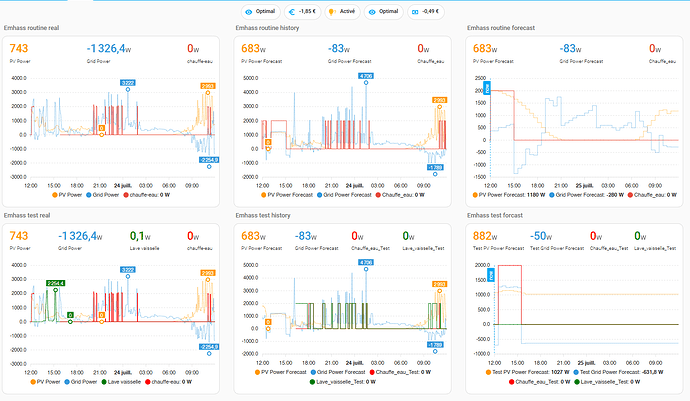

Dear Community,
First of all thank you for this wonderful project.
I work with emhass since one year and a half for optimization of my thermodynamic water heater and it work very well.
Now i want to include a second system my dishwasher. For this i have created an other mpc (test_mpc) and i encountered this error only on the test-mpc
[2025-07-24 11:54:23 +0200] [25] [DEBUG] Solver configuration: lp_solver=default, lp_solver_path=empty
[2025-07-24 11:54:23 +0200] [25] [DEBUG] Number of threads: 4
[2025-07-24 11:54:23 +0200] [25] [INFO] Retrieve hass get data method initiated…
[2025-07-24 11:54:23 +0200] [25] [DEBUG] prepare_data self.var_list=[‘sensor.power_load_no_var_loads’, ‘sensor.onduleur_huawei_active_power_in_watt’]
[2025-07-24 11:54:23 +0200] [25] [DEBUG] prepare_data var_load=sensor.power_load_no_var_loads
[2025-07-24 11:54:23 +0200] [25] [DEBUG] prepare_data load_negative=False
[2025-07-24 11:54:23 +0200] [25] [DEBUG] prepare_data set_zero_min=True
[2025-07-24 11:54:23 +0200] [25] [DEBUG] prepare_data var_replace_zero=[‘sensor.power_load_no_var_loads’, ‘sensor.onduleur_huawei_active_power_in_watt’]
[2025-07-24 11:54:23 +0200] [25] [DEBUG] prepare_data var_interp=[‘sensor.power_load_no_var_loads’, ‘sensor.onduleur_huawei_active_power_in_watt’]
[2025-07-24 11:54:23 +0200] [25] [INFO] Retrieving weather forecast data using method = solar.forecast
[2025-07-24 11:54:26 +0200] [25] [ERROR] Exception on /action/naive-mpc-optim [POST]
File “/app/.venv/lib/python3.12/site-packages/flask/app.py”, line 1511, in wsgi_app
response = self.full_dispatch_request()
File “/app/.venv/lib/python3.12/site-packages/flask/app.py”, line 919, in full_dispatch_request
rv = self.handle_user_exception(e)
File “/app/.venv/lib/python3.12/site-packages/flask/app.py”, line 917, in full_dispatch_request
rv = self.dispatch_request()
File “/app/.venv/lib/python3.12/site-packages/flask/app.py”, line 902, in dispatch_request
return self.ensure_sync(self.view_functions[rule.endpoint])(**view_args) # type: ignore[no-any-return]
File “/app/src/emhass/web_server.py”, line 411, in action_call
input_data_dict = set_input_data_dict(
File “/app/src/emhass/command_line.py”, line 378, in set_input_data_dict
df_weather = fcst.get_weather_forecast(
File “/app/src/emhass/forecast.py”, line 562, in get_weather_forecast
“ts”: list(data_raw[“result”][“watts”].keys()),
It result that the timeline seems shorten compare to what i ask does anyone has an idea ?
I give you some screenshot about the result of mpc and test_mpc
Dear @markpurcell
Could you please share to me how you manage to have mpc and mpc test working together ?
Thanks a lot
