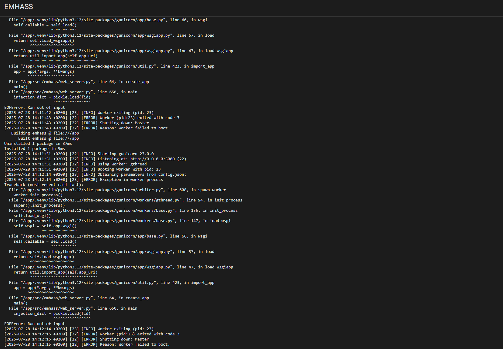

Yesterday may system stopt working with this errors. I do not no why.

It is not possible to start EMHASS anymore. I restarted Home assistant.
What can I do?

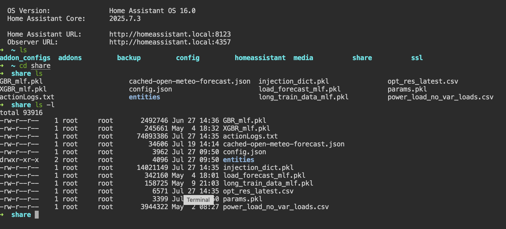

Erase injection_dict.pkl in you share folder and restart EMHASS
I’m not that familliar with EMHASS. Where can I find that file?
Open terminal in HA and go to your share directory (hope you set it up)

Erased injection_dict.pkl file. EMHASS is still not starting.
After removing and reinstallation everything is working fine.

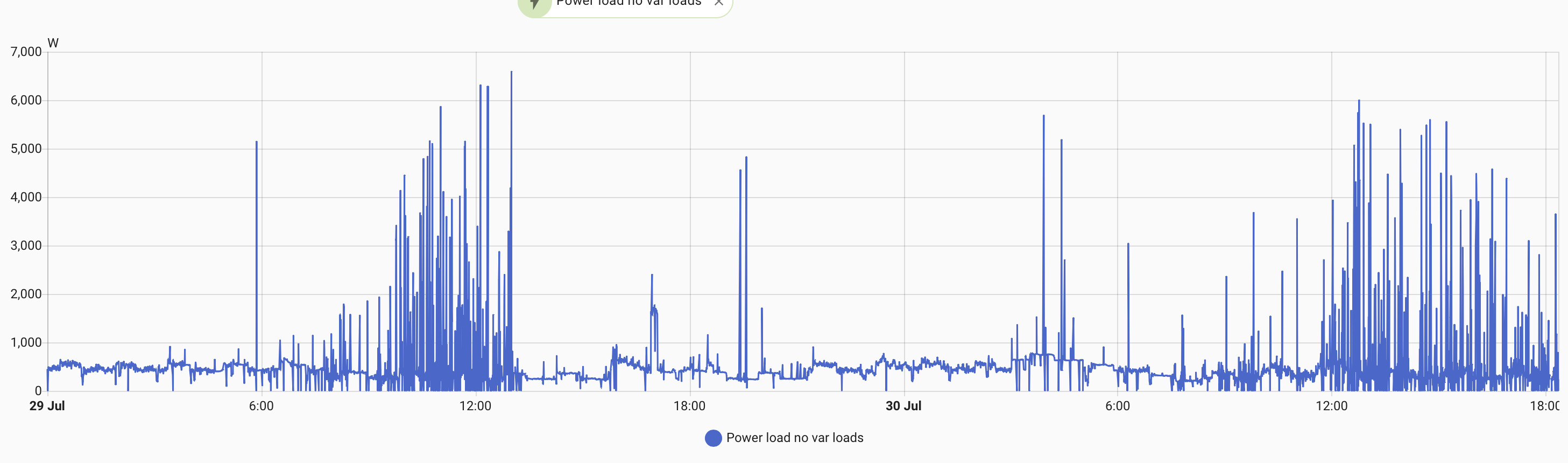

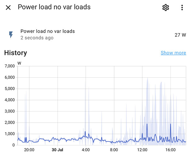

How do you guys measure ā€˜power no var loads’? At the moment I use the Huawei integration and calculate the ’ power no var loads ', but if data come slow or are unavailable I get strange readings, it seems that HA does some statistic on the data.
But if use ā€˜Show more’ I get this:
Using MLforecaster gives a very bad fit because of all these spikes I think?
Will a direct measurement be more robust? Like Aeotec Home Energy Meter 8? Any advice?
For my solar generation data I do a filter to clear out some of those spikes, and use the filtered data in EMHASS. Maybe that’d help with your power no vars too:

I tried that also, but still a lot of spikes.

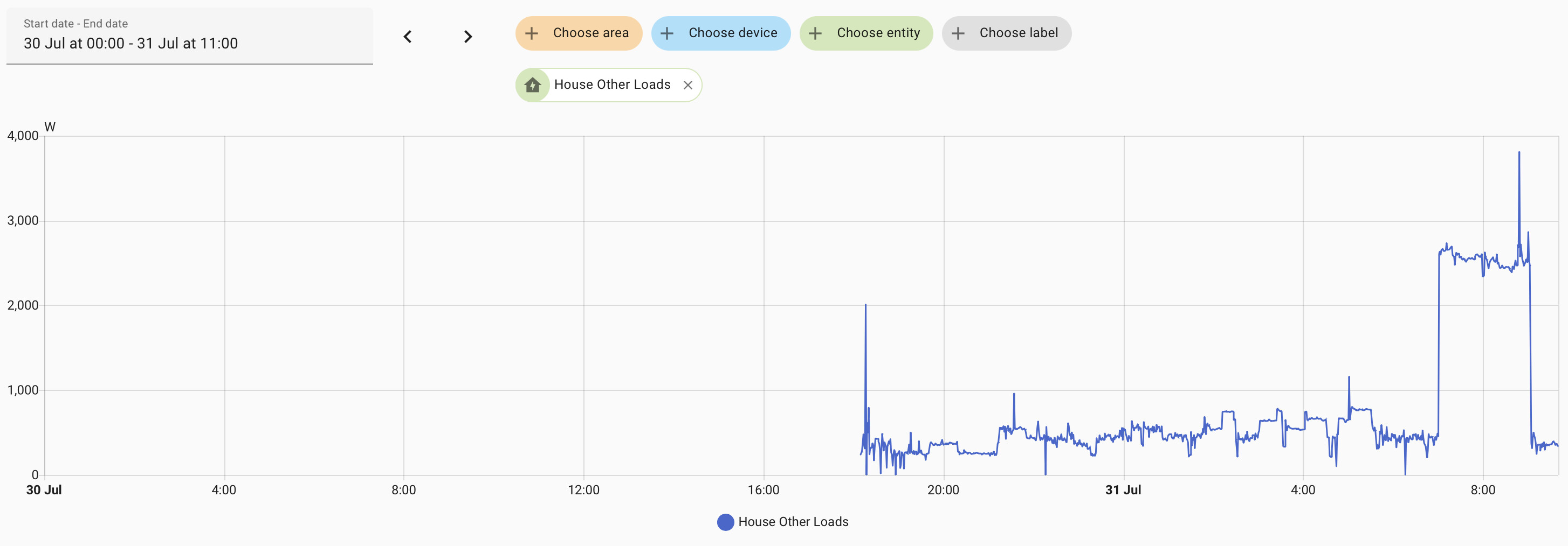

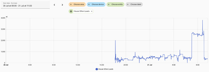

Now I am trying this:
  - trigger:
      - platform: time_pattern
        minutes: "/1"  # Update every 1 minute
    sensor:
      - name: "House Other Loads"
        unique_id: house_other_loads
        unit_of_measurement: "W"
        icon: mdi:home-lightning-bolt
        state: >
          {% set inverter = states('sensor.inverter_werkelijk_vermogen') | float(0) %}
          {% set grid = states('sensor.power_meter_vermogen') | float(0) %}
          {% set dryer = states('sensor.waskeuken_wasdroger_waskeuken_618_power') | float(0) %}
          {% set washer = states('sensor.waskeuken_wasmachine_waskeuken_611_power') | float(0) %}
          {% set phev = states('sensor.garage_phev_switch_803_power') | float(0) %}
          {% set house_load = inverter - grid %}
          {% set var_loads = dryer + washer + phev %}
          {% set other_loads = house_load - var_loads %}
          {{ (other_loads if other_loads > 0 else 0) | round(1) }}
This sensor logs data every minute, up till now it’s much better, spikes I can’t prevent.:

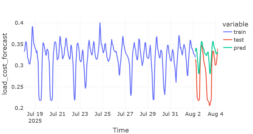

Unfortunately I always get negative R2 scores. Anybody else experienced this issue?
Here is a Debug log from the load cost forecast:
[2025-08-04 07:38:40 +0200] [23] [INFO] Passed runtime parameters: {'historic_days_to_retrieve': 17, 'model_type': 'load_cost_forecast', 'var_model': 'sensor.nordpool_kwh_ger_eur_3_10_0', 'sklearn_model': 'KNeighborsRegressor', 'num_lags': 48, 'split_date_delta': '48h', 'perform_backtest': 'False'}
[2025-08-04 07:38:40 +0200] [23] [INFO]  >> Setting input data dict
[2025-08-04 07:38:40 +0200] [23] [INFO] Setting up needed data
[2025-08-04 07:38:40 +0200] [23] [DEBUG] Initialized Optimization with retrieve_hass_conf: {'optimization_time_step': Timedelta('0 days 00:30:00'), 'historic_days_to_retrieve': 17, 'sensor_power_photovoltaics': 'sensor.total_dc_power', 'sensor_power_photovoltaics_forecast': '', 'sensor_power_load_no_var_loads': 'sensor.load_power', 'load_negative': False, 'set_zero_min': True, 'sensor_replace_zero': ['sensor.total_dc_power'], 'sensor_linear_interp': ['sensor.load_power'], 'method_ts_round': 'first', 'continual_publish': False, 'hass_url': 'http://supervisor/core/api', 'long_lived_token': '', 'time_zone': <DstTzInfo 'Europe/Berlin' LMT+0:53:00 STD>, 'Latitude': XX.XXXXX, 'Longitude': XX.XXXXX, 'Altitude': XXX, 'solcast_api_key': 'XXX', 'solcast_rooftop_id': 'XXX'}
[2025-08-04 07:38:40 +0200] [23] [DEBUG] Optimization configuration: {'costfun': 'self-consumption', 'logging_level': 'DEBUG', 'set_use_pv': True, 'set_use_adjusted_pv': False, 'adjusted_pv_regression_model': 'LassoRegression', 'adjusted_pv_solar_elevation_threshold': 10, 'set_use_battery': True, 'number_of_deferrable_loads': 5, 'nominal_power_of_deferrable_loads': [600, 400, 450, 3500, 2000], 'minimum_power_of_deferrable_loads': [0, 0, 0, 1440, 0], 'operating_hours_of_each_deferrable_load': [0, 0, 0, 0, 0], 'treat_deferrable_load_as_semi_cont': [True, True, True, False, True], 'set_deferrable_load_single_constant': [True, True, True, False, True], 'set_deferrable_startup_penalty': [0, 0, 0, 0, 0], 'delta_forecast_daily': Timedelta('1 days 00:00:00'), 'load_forecast_method': 'mlforecaster', 'load_cost_forecast_method': 'hp_hc_periods', 'load_peak_hours_cost': 0.354, 'load_offpeak_hours_cost': 0.354, 'production_price_forecast_method': 'constant', 'photovoltaic_production_sell_price': 0.084, 'set_total_pv_sell': False, 'lp_solver': 'COIN_CMD', 'lp_solver_path': '/usr/bin/cbc', 'lp_solver_timeout': 45, 'num_threads': 0, 'set_nocharge_from_grid': False, 'set_nodischarge_to_grid': True, 'set_battery_dynamic': False, 'battery_dynamic_max': 0.9, 'battery_dynamic_min': -0.9, 'weight_battery_discharge': 1, 'weight_battery_charge': 1, 'weather_forecast_method': 'solcast', 'open_meteo_cache_max_age': 30, 'start_timesteps_of_each_deferrable_load': [0, 0, 0, 0, 0], 'end_timesteps_of_each_deferrable_load': [0, 0, 0, 0, 0], 'load_peak_hour_periods': {'period_hp_1': [{'start': '00:00'}, {'end': '00:00'}]}}
[2025-08-04 07:38:40 +0200] [23] [DEBUG] Plant configuration: {'maximum_power_from_grid': 22000, 'maximum_power_to_grid': 6000, 'pv_module_model': ['CSUN_Eurasia_Energy_Systems_Industry_and_Trade_CSUN295_60M'], 'pv_inverter_model': ['Sungrow_Power_Supply_Co___Ltd___SG60KU_M__480V_'], 'surface_tilt': [35], 'surface_azimuth': [165], 'modules_per_string': [14], 'strings_per_inverter': [1], 'inverter_is_hybrid': True, 'compute_curtailment': False, 'battery_discharge_power_max': 6000, 'battery_charge_power_max': 6000, 'battery_discharge_efficiency': 0.95, 'battery_charge_efficiency': 0.95, 'battery_nominal_energy_capacity': 9600, 'battery_minimum_state_of_charge': 0.05, 'battery_maximum_state_of_charge': 1, 'battery_target_state_of_charge': 1}
[2025-08-04 07:38:40 +0200] [23] [DEBUG] Solver configuration: lp_solver=COIN_CMD, lp_solver_path=/usr/bin/cbc
[2025-08-04 07:38:40 +0200] [23] [DEBUG] Number of threads: 2
[2025-08-04 07:38:40 +0200] [23] [INFO] Retrieve hass get data method initiated...
[2025-08-04 07:38:40 +0200] [23] [DEBUG] sensor:sensor.nordpool_kwh_ger_eur_3_10_0 retrieved Dataframe count: 27, on day: 2025-07-18 00:00:00+00:00. This is less than freq value passed: 0 days 00:30:00
[2025-08-04 07:38:40 +0200] [23] [DEBUG] sensor:sensor.nordpool_kwh_ger_eur_3_10_0 retrieved Dataframe count: 30, on day: 2025-07-19 00:00:00+00:00. This is less than freq value passed: 0 days 00:30:00
[2025-08-04 07:38:40 +0200] [23] [DEBUG] sensor:sensor.nordpool_kwh_ger_eur_3_10_0 retrieved Dataframe count: 27, on day: 2025-07-20 00:00:00+00:00. This is less than freq value passed: 0 days 00:30:00
[2025-08-04 07:38:40 +0200] [23] [DEBUG] sensor:sensor.nordpool_kwh_ger_eur_3_10_0 retrieved Dataframe count: 30, on day: 2025-07-21 00:00:00+00:00. This is less than freq value passed: 0 days 00:30:00
[2025-08-04 07:38:40 +0200] [23] [DEBUG] sensor:sensor.nordpool_kwh_ger_eur_3_10_0 retrieved Dataframe count: 27, on day: 2025-07-22 00:00:00+00:00. This is less than freq value passed: 0 days 00:30:00
[2025-08-04 07:38:40 +0200] [23] [DEBUG] sensor:sensor.nordpool_kwh_ger_eur_3_10_0 retrieved Dataframe count: 27, on day: 2025-07-23 00:00:00+00:00. This is less than freq value passed: 0 days 00:30:00
[2025-08-04 07:38:40 +0200] [23] [DEBUG] sensor:sensor.nordpool_kwh_ger_eur_3_10_0 retrieved Dataframe count: 27, on day: 2025-07-24 00:00:00+00:00. This is less than freq value passed: 0 days 00:30:00
[2025-08-04 07:38:40 +0200] [23] [DEBUG] sensor:sensor.nordpool_kwh_ger_eur_3_10_0 retrieved Dataframe count: 27, on day: 2025-07-25 00:00:00+00:00. This is less than freq value passed: 0 days 00:30:00
[2025-08-04 07:38:40 +0200] [23] [DEBUG] sensor:sensor.nordpool_kwh_ger_eur_3_10_0 retrieved Dataframe count: 30, on day: 2025-07-26 00:00:00+00:00. This is less than freq value passed: 0 days 00:30:00
[2025-08-04 07:38:40 +0200] [23] [DEBUG] sensor:sensor.nordpool_kwh_ger_eur_3_10_0 retrieved Dataframe count: 27, on day: 2025-07-27 00:00:00+00:00. This is less than freq value passed: 0 days 00:30:00
[2025-08-04 07:38:40 +0200] [23] [DEBUG] sensor:sensor.nordpool_kwh_ger_eur_3_10_0 retrieved Dataframe count: 36, on day: 2025-07-28 00:00:00+00:00. This is less than freq value passed: 0 days 00:30:00
[2025-08-04 07:38:40 +0200] [23] [DEBUG] sensor:sensor.nordpool_kwh_ger_eur_3_10_0 retrieved Dataframe count: 30, on day: 2025-07-29 00:00:00+00:00. This is less than freq value passed: 0 days 00:30:00
[2025-08-04 07:38:40 +0200] [23] [DEBUG] sensor:sensor.nordpool_kwh_ger_eur_3_10_0 retrieved Dataframe count: 27, on day: 2025-07-30 00:00:00+00:00. This is less than freq value passed: 0 days 00:30:00
[2025-08-04 07:38:40 +0200] [23] [DEBUG] sensor:sensor.nordpool_kwh_ger_eur_3_10_0 retrieved Dataframe count: 30, on day: 2025-07-31 00:00:00+00:00. This is less than freq value passed: 0 days 00:30:00
[2025-08-04 07:38:40 +0200] [23] [DEBUG] sensor:sensor.nordpool_kwh_ger_eur_3_10_0 retrieved Dataframe count: 34, on day: 2025-08-01 00:00:00+00:00. This is less than freq value passed: 0 days 00:30:00
[2025-08-04 07:38:40 +0200] [23] [DEBUG] sensor:sensor.nordpool_kwh_ger_eur_3_10_0 retrieved Dataframe count: 31, on day: 2025-08-02 00:00:00+00:00. This is less than freq value passed: 0 days 00:30:00
[2025-08-04 07:38:40 +0200] [23] [DEBUG] sensor:sensor.nordpool_kwh_ger_eur_3_10_0 retrieved Dataframe count: 42, on day: 2025-08-03 00:00:00+00:00. This is less than freq value passed: 0 days 00:30:00
[2025-08-04 07:38:40 +0200] [23] [INFO]  >> Performing a machine learning forecast model fit...
[2025-08-04 07:38:40 +0200] [23] [INFO] Performing a forecast model fit for load_cost_forecast
[2025-08-04 07:38:40 +0200] [23] [INFO] Training a KNeighborsRegressor model
[2025-08-04 07:38:41 +0200] [23] [INFO] Elapsed time for model fit: 0.030734539031982422
[2025-08-04 07:38:41 +0200] [23] [INFO] Prediction R2 score of fitted model on test data: -0.41213566715192806
[2025-08-04 07:38:41 +0200] [23] [DEBUG] saved model to /share/load_cost_forecast_mlf.pkl
and here is the plot:
I already deleted the pkl-file but still the same issue.
Thanks in advance!
You probably need more data, 2 weeks is not a lot for a ML-model.
Adjust your HA recorder settings to retain more.
I keep 30 days, and the model is still way off.
I haven’t tried saving more.
I got these results for the PV forecast with 8 days data:
[INFO] PV adjust Training metrics: RMSE = 1417.9528530229886, R2 = 0.662969382420331
According to chatgtp this is ā€˜reasonable’, but I don’t know if it is better than the standard approach and if the data requirement is totally different than for a load forecast.
I just rerun the model-fit for load cost and load power.
I currently have 21 days for load cost and 10 days of data for load power (had to recreate the sensor…).
For load cost I got an R2 score of 0.41 and for load power of -0.66.
Updated my recorder to held 60 days of data and will observe, if I get better results.
Thanks!
