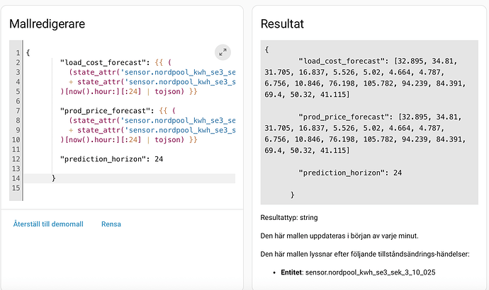

I can’t see the data your rest command is posting. I think the prediction horizon you are using is wrong (just guessing without looking closely). Prediction horizon needs to match the data length of norepools forecasts or solcast forecast, which ever is the shortest. So if you have 24 tariff values from Nordpool and thats the shortest list then your prediction horizon needs to be 24.
If your data values vary for some reason your prediction horizon needs to vary.

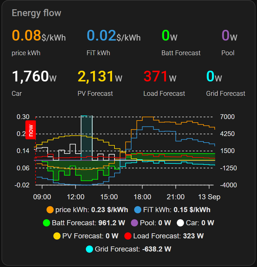

In my case Amber (my version of Nordpool) publishes a 24-hour Forecast starting at 12:30 each day with 48 by 30 minute forecasts until 03:30 after which the forecasts stop. So, between 03:30 and 12:30 you have a decreasing number from 48 forecasts. At 12:00 you have the smallest number of forecasts 12:00-03:30 which is 31 by 30 minute forecasts. This applies to the data produced by the amber2MQTT integration. This decreasing horizon is passed to EMHASS in the API call by testing the number of elements in one of the sensors and pass that to EMHASS in the API post as the “prediction_horizon”. To manage this changing prediction horizon I have to use this:
 {#-- Calculate prediction horizon as the shortest data length --#}
  "prediction_horizon": {{
    [prod_price_forecast | length,
     load_cost_forecast | length,
     pv_power_forecast | length,
     load_power_forecast | length] | min -1
So that my prediction horizon is always the smalest number of predictions I have for all the data dictionaries.

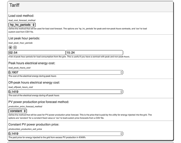

Also, I think you need to set your time steps correctly in EMHASS config.
Optimization steps per minute (timesteps):
optimization_time_step
Is this 15 minutes for you? This would mean you need 96 elements for 24 hours?

Is Amber users have two prediction horizons, 30 and 5 minutes time steps with the 30 min data varying from 31 to 48 and the 5 min varying from 12 and 6 I think.
But we stick to the 30 min time step and simply prefix the data with the current 5 min forecast so the system can react to what is happening right now. This is what the alpha and beta values are for if you look at the samples I posted above. These setting tell the system to take notice of the now value. That’s probably too much information but there you go.
@jorbor I had a similar experience with settings not being saved after I had changed the folder path where EMHASS data will be stored (see davidusb sccreenshot above). I managed to get it working by changing back to default and then totally remove and reinstall EMHASS
In the GUI there is no parameter for “prediction horizion” as far as i can tell, but I have added the “prediction_horizon”: 24 in the rest_command to send to API together with the nordpool array.
I currently get 24 nordpool data points, so the timestep is set to 60min in GUI.
I still get the same logs.
Just listening to the rest_command respons in the dev.tools give the respons as above
Trying to run the dayahead optimization manually with no success. LOG as follows.

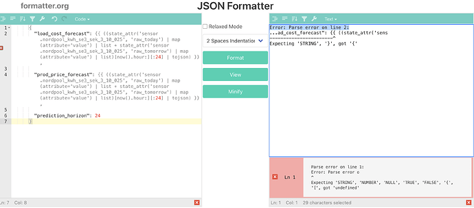

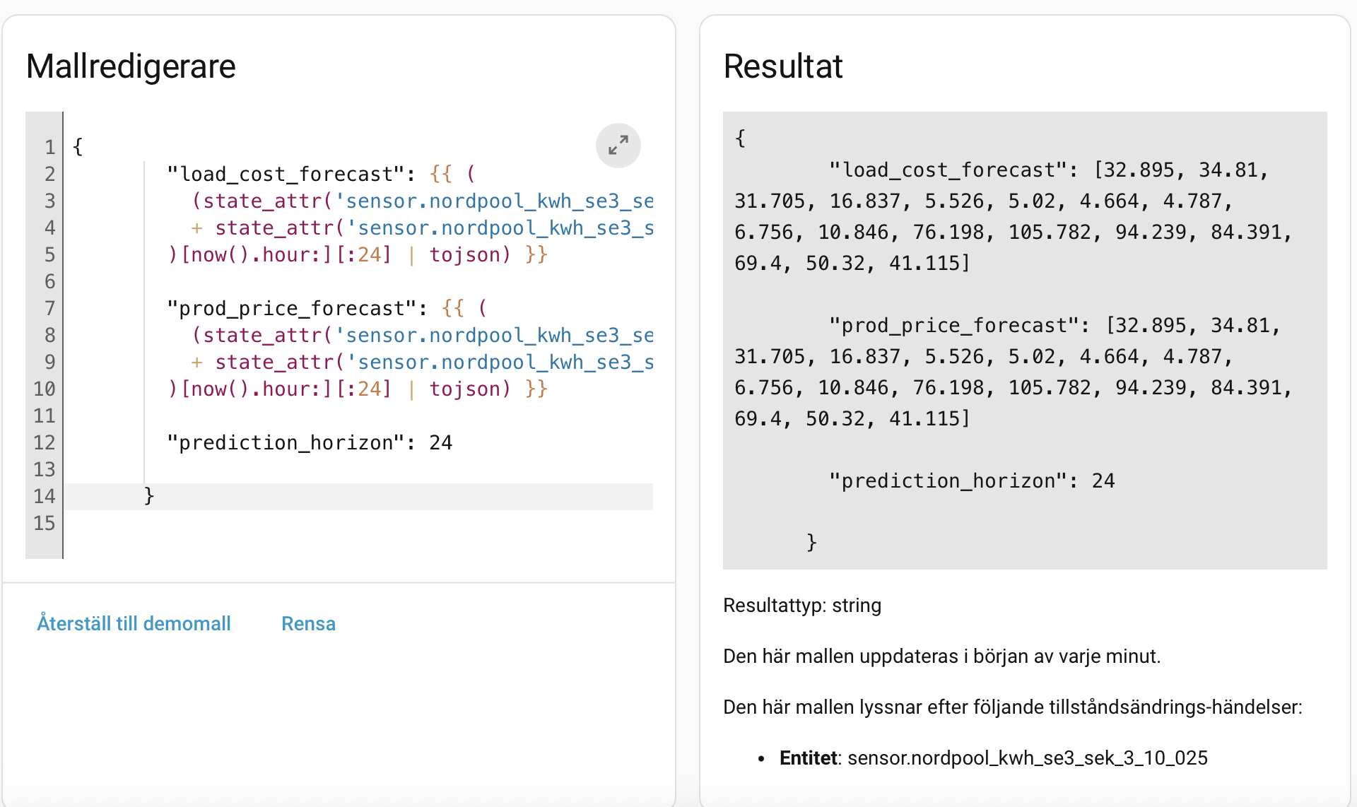

Without any understanding of this i wonder why the rest_command give the error status 500? Is this not the reason for not being able to run any optimization tasks? Code for rest_command now like this:
rest_command:
  trigger_nordpool_forecast:
    url: http://192.168.10.3:5000/action/dayahead-optim
    method: POST
    headers:
      Content-Type: "application/json"
    payload: >
        "load_cost_forecast": {{ (
          (state_attr('sensor.nordpool_kwh_se3_sek_3_10_025', 'raw_today') | map(attribute='value') | list
          + state_attr('sensor.nordpool_kwh_se3_sek_3_10_025', 'raw_tomorrow') | map(attribute='value') | list
        )[now().hour:][:24] | tojson) }},
        "prod_price_forecast": {{ (
        "prediction_horizon": 24
I also tried to run the API call as a shell_command, with same error and return from dev.tools:
stdout: "HTTP/1.1 500 INTERNAL SERVER ERROR\r\nServer: gunicorn\r\nDate: Wed, 10 Sep 2025 19:53:01 GMT\r\nConnection: keep-alive\r\nContent-Type: text/html; charset=utf-8\r\nContent-Length: 265\r\n\r\n<!doctype html>\n<html lang=en>\n<title>500 Internal Server Error</title>\n<h1>Internal Server Error</h1>\n<p>The server encountered an internal error and was unable to complete your request. Either the server is overloaded or there is an error in the application.</p>"
stderr: "% Total    % Received % Xferd  Average Speed   Time    Time     Time  Current\n                                 Dload  Upload   Total   Spent    Left  Speed\n\r  0     0    0     0    0     0      0      0 --:--:-- --:--:-- --:--:--     0\r100   418    0     0  100   418      0    347  0:00:01  0:00:01 --:--:--   347\r100   418    0     0  100   418      0    189  0:00:02  0:00:02 --:--:--   189\r100   418    0     0  100   418      0    130  0:00:03  0:00:03 --:--:--   130\r100   418    0     0  100   418      0     99  0:00:04  0:00:04 --:--:--    99\r100   683  100   265  100   418     59     94  0:00:04  0:00:04 --:--:--   154"
returncode: 0
Seems like the prebuitl image for Synology Docker is only at 0.10, so a year out of date. @davidusb any chance to update this?
There is no comma between prod_price_forecast and prediction_horizon.
That makes the JSON invalid.
Try this:
rest_command:
    url: "http://192.168.10.3:5000/action/dayahead-optim"
    method: POST
    headers:
    payload: >
        )[0:24] | tojson }},
I think there is also an issue with the load forecast data. This is the household consumption over the past 48 hours used as a forecast for the next 24 hours.

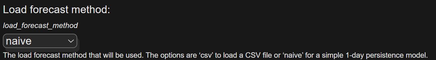

I think you have load_forecast_method set to ‘typical’? Should be like this:
And EMHASS will try to read the household load data our of the recorder database.
There may still be an issue with this setting.

But try setting load_forecast_method to naive first.

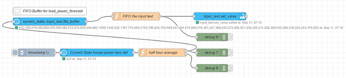

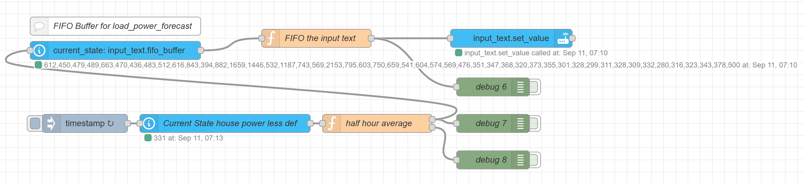

In the end I created a Node-Red flow that averages the home consumption every 30 mins and stores that is a string (a FIFO buffer)
FIFO the input text
// Get the values from the previous nodes
let fiFoBuffer = msg.payload.substring(msg.payload.indexOf(',') + 1);
let avgHousePower = flow.get("flowAvgHousePower");
let comerString = ","
// Combine values, and comer and create a string
let newValue = fiFoBuffer.concat(comerString.concat(avgHousePower));
// Set the payload to the new value
msg.payload = newValue;
return msg;
Half hour average
var sumHousePower = parseInt(flow.get("flowSumHousePower")) || 0;
var iterationCount = flow.get("flowIterationCount") || 0;
var avgHousePower = flow.get("flowAvgHousePower") || 0;
var msg1 = { payload: 0 };
iterationCount = iterationCount + 1;
sumHousePower += parseInt(msg.payload);
flow.set("flowSumHousePower", sumHousePower);
flow.set("flowIterationCount", iterationCount);
// Determine exit path based on iteration count
if (iterationCount < 30) {
    var msg2 = { payload: [iterationCount,sumHousePower] };
    return [null, msg2];
else {
    // Calculate average power consumption
    var averagePower = sumHousePower / 30;
    // Reset flow variables for the next 30 iterations
    sumHousePower = 0;
    iterationCount = 0;
    // Send the average power out the first exit
    msg1.payload = parseInt(averagePower);
    flow.set("flowAvgHousePower", msg1.payload.toString());
    return [msg1, null];
But that’s going a bit too far at this stage.
Yes, you were right, the load_forecast_method was set to typical.–> now changed to naive

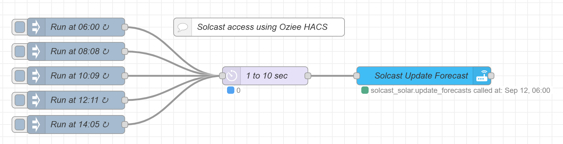

With solcast my free account is limited to 10 API calls per day. This is actually only 5 retrievals of data as each update_forecasts call from Home Assistant uses 2 API calls (one for pv_power_forecast and one for radiation/irradiance forecast). You can go to the trouble of setting up two rooftops and tricking the system into 20 API calls, but I’ve found 10 is ok for MPC method and definitely enough for dayahead as you typically only call the dayahead routine once per day anyway.
I don’t use the internal EMHASS configuration to retrieve this data because I set this flow up before it was available and I haven’t bothered falling back to the EMHASS internal set up.
I don’t know what the benefits of either might be?

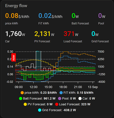

Now to monitor the forecast output in your dashboard many people use the Apex Chart HACS.
This is an example:
type: custom:apexcharts-card
experimental:
  color_threshold: true
graph_span: 16h
span:
  start: minute
now:
  show: true
  label: now
  color: red
yaxis:
  - id: first
    decimals: 2
    apex_config:
      forceNiceScale: true
  - id: second
    opposite: true
    min: -4000
    max: 7000
    decimals: 0
    apex_config:
header:
  show: true
  title: Energy flow
  show_states: true
  colorize_states: true
series:
  - entity: sensor.amber_30min_forecasts_general_price
    yaxis_id: first
    curve: stepline
    float_precision: 2
    show:
      in_header: after_now
    stroke_width: 1
    data_generator: |
      return entity.attributes.Forecasts.map((entry) => {
        return [new Date(entry.start_time), entry.advanced_price_predicted];
  - entity: sensor.amber_30min_forecasts_feed_in_price
    yaxis_id: first
    curve: stepline
    float_precision: 2
    show:
    stroke_width: 1
    data_generator: |
        return [new Date(entry.start_time), -entry.advanced_price_predicted];
  - entity: sensor.p_batt_forecast
    yaxis_id: second
    curve: stepline
    type: area
    show:
      in_header: before_now
    stroke_width: 1
    opacity: 0.2
    color: rgb(0,255,0)
    data_generator: |
      return entity.attributes.battery_scheduled_power.map((entry) => {
        return [new Date(entry.date), entry.p_batt_forecast];
  - entity: sensor.p_deferrable0
    yaxis_id: second
    curve: stepline
    stroke_width: 1
    show:
    data_generator: |
      return entity.attributes.deferrables_schedule.map((entry) => {
        return [new Date(entry.date), entry.p_deferrable0];
  - entity: sensor.p_deferrable1
    yaxis_id: second
    curve: stepline
    stroke_width: 1
    color: white
    show:
    data_generator: |
        return [new Date(entry.date), entry.p_deferrable1];
  - entity: sensor.p_pv_forecast
    yaxis_id: second
    curve: stepline
    show:
    stroke_width: 1
    color: rgb(255,215,0)
    data_generator: |
      return entity.attributes.forecasts.map((entry) => {
        return [new Date(entry.date), entry.p_pv_forecast];
  - entity: sensor.p_load_forecast
    yaxis_id: second
    curve: stepline
    show:
    stroke_width: 1
    color: rgb(255,0,0)
    data_generator: |
        return [new Date(entry.date), entry.p_load_forecast];
  - entity: sensor.p_grid_forecast
    yaxis_id: second
    curve: stepline
    opacity: 0.1
    color: rgb(0,255,255)
    type: area
    show:
    stroke_width: 1
    data_generator: |
        return [new Date(entry.date), entry.p_grid_forecast];

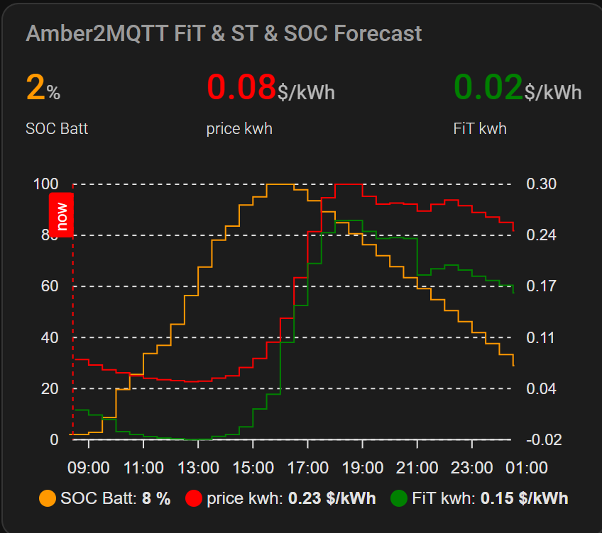

and
experimental:
graph_span: 16h
span:
  start: minute
now:
  show: true
  label: now
  color: red
yaxis:
  - id: first
    min: 0
    max: 100
    decimals: 0
    apex_config:
  - id: second
    opposite: true
    decimals: 2
    apex_config:
header:
  show: true
  title: Amber2MQTT FiT & ST & SOC Forecast
  show_states: true
series:
  - entity: sensor.soc_batt_forecast
    yaxis_id: first
    float_precision: 2
    curve: stepline
    show:
    stroke_width: 1
    data_generator: |
      return entity.attributes.battery_scheduled_soc.map((entry) => {
        return [new Date(entry.date), entry.soc_batt_forecast];
    yaxis_id: second
    float_precision: 2
    curve: stepline
    show:
    stroke_width: 1
    color: red
    data_generator: |
    yaxis_id: second
    float_precision: 2
    curve: stepline
    show:
    stroke_width: 1
    color: green
    data_generator: |
Only day ahead -

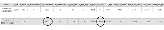

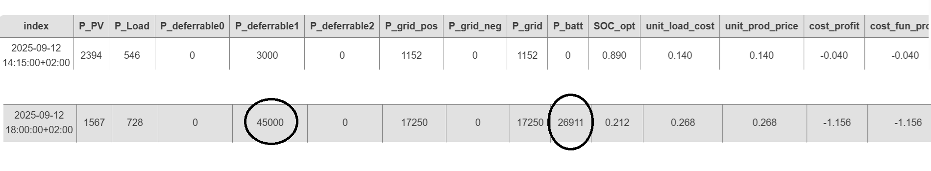

Hi! Does anyone else experience (luckily quite rare) extremely high deferrable load values? Result is Optimal, load is 3000W nominal, but I get this (latest version 0.13.4):
Also the battery is not capable of delivering that (and configured correctly)
Details of the log (not at the exact time as above image, but about 10 minutes before with similar end-result):
[2025-09-12 14:04:09 +0200] [10] [INFO] Perform an iteration of a naive MPC controller
[2025-09-12 14:04:09 +0200] [10] [DEBUG] Battery usage enabled. Initial SOC: 0.82, Final SOC: 0.05
[2025-09-12 14:04:09 +0200] [10] [DEBUG] Processing deferrable load 0
[2025-09-12 14:04:09 +0200] [10] [DEBUG] Deferrable load 0: Proposed optimization window: 0 --> 72
[2025-09-12 14:04:09 +0200] [10] [DEBUG] Deferrable load 0: Validated optimization window: 0 --> 72
[2025-09-12 14:04:09 +0200] [10] [DEBUG] Applying minimum power constraint for deferrable load 0: 6600 W
[2025-09-12 14:04:09 +0200] [10] [DEBUG] Processing deferrable load 1
[2025-09-12 14:04:09 +0200] [10] [DEBUG] Load 1 is standard/non-thermal.
[2025-09-12 14:04:09 +0200] [10] [DEBUG] Load 1: Using total hours constraint: 4
[2025-09-12 14:04:09 +0200] [10] [DEBUG] Load 1: Standard load constraints set.
[2025-09-12 14:04:09 +0200] [10] [DEBUG] Deferrable load 1: Proposed optimization window: 0 --> 16
[2025-09-12 14:04:09 +0200] [10] [DEBUG] Deferrable load 1: Validated optimization window: 0 --> 16
[2025-09-12 14:04:09 +0200] [10] [DEBUG] Applying minimum power constraint for deferrable load 1: 3000 W
[2025-09-12 14:04:09 +0200] [10] [DEBUG] Processing deferrable load 2
[2025-09-12 14:04:09 +0200] [10] [DEBUG] Deferrable load 2: Proposed optimization window: 0 --> 16
[2025-09-12 14:04:09 +0200] [10] [DEBUG] Deferrable load 2: Validated optimization window: 0 --> 16
[2025-09-12 14:04:09 +0200] [10] [DEBUG] Applying minimum power constraint for deferrable load 2: 1000 W
[2025-09-12 14:04:09 +0200] [10] [WARNING] Solver default unknown, using default
[2025-09-12 14:04:10 +0200] [10] [INFO] Status: Optimal
[2025-09-12 14:04:10 +0200] [10] [INFO] Total value of the Cost function = 1.03
[2025-09-12 14:04:10 +0200] [10] [DEBUG] Battery usage enabled. Initial SOC: 0.82, Final SOC: 0.05
[2025-09-12 14:04:10 +0200] [10] [DEBUG] Deferrable load operating hours: [0, 4, 0]
[2025-09-12 14:04:10 +0200] [10] [DEBUG] Deferrable load timesteps: None
[2025-09-12 14:04:10 +0200] [10] [DEBUG] Deferrable load start timesteps: [0, 0, 0]
[2025-09-12 14:04:10 +0200] [10] [DEBUG] Deferrable load end timesteps: [72, 16, 16]
[2025-09-12 14:04:10 +0200] [10] [DEBUG] Selected cost function type: profit
[2025-09-12 14:04:10 +0200] [10] [DEBUG] Solver selected: default
[2025-09-12 14:04:10 +0200] [10] [INFO] Optimization status: Optimal
[2025-09-12 14:04:11 +0200] [10] [INFO]  >> Obtaining params:
[2025-09-12 14:04:11 +0200] [10] [INFO] Passed runtime parameters: {}
[2025-09-12 14:04:11 +0200] [10] [INFO]  >> Setting input data dict
[2025-09-12 14:04:11 +0200] [10] [INFO] Setting up needed data
[2025-09-12 14:04:11 +0200] [10] [DEBUG] Initialized Optimization with retrieve_hass_conf: {'optimization_time_step': Timedelta('0 days 00:15:00'), 'historic_days_to_retrieve': 9, 'sensor_power_photovoltaics': 'sensor.deye_total_solar_power', 'sensor_power_photovoltaics_forecast': 'sensor.p_pv_forecast', 'sensor_power_load_no_var_loads': 'sensor.power_load_no_var_loads', 'load_negative': False, 'set_zero_min': True, 'sensor_replace_zero': [''], 'sensor_linear_interp': ['sensor.deye_total_solar_power', 'sensor.power_load_no_var_loads'], 'method_ts_round': 'first', 'continual_publish': False, 'hass_url': 'http://homeassistant:8123/', 'long_lived_token': 'eyJhbGciOiJIUzI1NiIsInR5cCI6IkpXVCJ9.eyJpc3MiOiJkYmE2N2Y5NTllNmQ0OWZkOTBjMmU4M2YyM2EyMzJmYiIsImlhdCI6MTcwMzcwMDQwNSwiZXhwIjoyMDE5MDYwNDA1fQ.W9kPfbHrV8kU1qbXFp6xiL3HIJEdJWWmFGbhFVnP2GE', 'time_zone': <DstTzInfo 'Europe/Amsterdam' LMT+0:18:00 STD>, 'Latitude': 45.83, 'Longitude': 6.86, 'Altitude': 4807.8}
[2025-09-12 14:04:11 +0200] [10] [DEBUG] Optimization configuration: {'costfun': 'profit', 'logging_level': 'DEBUG', 'set_use_pv': True, 'set_use_adjusted_pv': False, 'adjusted_pv_regression_model': 'LassoRegression', 'adjusted_pv_solar_elevation_threshold': 10, 'set_use_battery': True, 'number_of_deferrable_loads': 3, 'nominal_power_of_deferrable_loads': [6600, 3000, 1000], 'minimum_power_of_deferrable_loads': [6600, 3000, 1000], 'operating_hours_of_each_deferrable_load': [0, 0, 0], 'treat_deferrable_load_as_semi_cont': [True, True, True], 'set_deferrable_load_single_constant': [False, False, False], 'set_deferrable_startup_penalty': [0, 0, 0], 'delta_forecast_daily': Timedelta('1 days 00:00:00'), 'load_forecast_method': 'naive', 'load_cost_forecast_method': 'hp_hc_periods', 'load_peak_hours_cost': 0.1907, 'load_offpeak_hours_cost': 0.1419, 'production_price_forecast_method': 'constant', 'photovoltaic_production_sell_price': 0.1419, 'set_total_pv_sell': False, 'lp_solver': 'default', 'lp_solver_path': 'empty', 'lp_solver_timeout': 45, 'num_threads': 0, 'set_nocharge_from_grid': False, 'set_nodischarge_to_grid': False, 'set_battery_dynamic': False, 'battery_dynamic_max': 0.9, 'battery_dynamic_min': -0.9, 'weight_battery_discharge': 1, 'weight_battery_charge': 1, 'weather_forecast_method': 'csv', 'open_meteo_cache_max_age': 30, 'start_timesteps_of_each_deferrable_load': [0, 0, 0], 'end_timesteps_of_each_deferrable_load': [0, 0, 0], 'load_peak_hour_periods': {'period_hp_1': [{'start': '02:54'}, {'end': '15:24'}], 'period_hp_2': [{'start': '17:24'}, {'end': '20:24'}]}}
[2025-09-12 14:04:11 +0200] [10] [DEBUG] Plant configuration: {'maximum_power_from_grid': 17250, 'maximum_power_to_grid': 17250, 'pv_module_model': ['CSUN_Eurasia_Energy_Systems_Industry_and_Trade_CSUN295_60M'], 'pv_inverter_model': ['Fronius_International_GmbH__Fronius_Primo_5_0_1_208_240__240V_'], 'surface_tilt': [30], 'surface_azimuth': [205], 'modules_per_string': [15], 'strings_per_inverter': [2], 'inverter_is_hybrid': False, 'inverter_ac_output_max': 1000, 'inverter_ac_input_max': 1000, 'inverter_efficiency_dc_ac': 1, 'inverter_efficiency_ac_dc': 1, 'compute_curtailment': False, 'battery_discharge_power_max': 7680, 'battery_charge_power_max': 7680, 'battery_discharge_efficiency': 0.95, 'battery_charge_efficiency': 0.95, 'battery_nominal_energy_capacity': 9600, 'battery_minimum_state_of_charge': 0.05, 'battery_maximum_state_of_charge': 0.95, 'battery_target_state_of_charge': 0.1}

I can’t emphasise enough how important it is to make sure the output is valid JSON format. So focus on that first.
You can take the raw JINJA2 code out of the rest_command and past it into the developer tools template to test it.
You can also check the JSON by posting it manually into EMHASS. This can be done from any PC on your network.

testing the Jinja2 code in dev.tools template give:
(sorry for swedish UI. It says “this template is updated every minute”, “this template listens for the following entities”)
Question: you are not using CSV? I thought this array we created was put in a CSV in EMHASS? My misunderstanding probably. But in the EMHASS GUI there is only to choose from hp_hc periods or CSV. Should this be set to hp_hc? (have been set to CSV). Changed this to hp_hc, no difference, same error. Looks like this in GUI. Does it matter what is stated in GUI when trying to feed in with API post?

Regarding csv, I think it doesn’t matter, I used to have it hc-hc etc, but changed it to csv, but in the end, what you supply on the commandline seems to be the info used
The json.formatter.org is not happy. This is respons:
But testing the full rest_command.yaml in duck ai. claims it is valid. I am still clueless… :sweat_smile:
