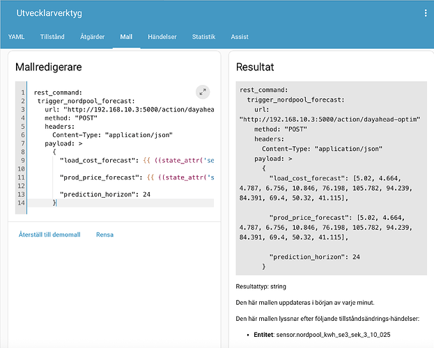

When I look at the output from your dev.tools template it doesn’t look like valid JSON. I believe this is your output? Is this what you are outputting?
"load_cost_forecast": [32.895, 34.81, 31.705, 16.837, 5.526, 5.02, 4.664, 4.787, 6.756, 10.846, 76.198, 105.782, 94.239, 84.391, 69.4, 50.32, 41.115]
"prod_price_forecast": [32.895, 34.81, 31.705, 16.837, 5.526, 5.02, 4.664, 4.787, 6.756, 10.846, 76.198, 105.782, 94.239, 84.391, 69.4, 50.32, 41.115]
"prediction_horizon": 24
Valid JSON requiures a comma at the end of each line except that last line.

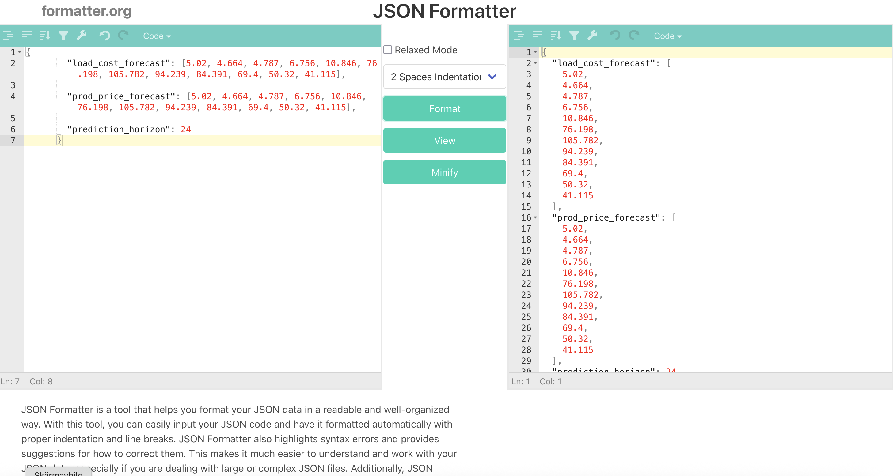

When I past this output into a JSON validator it comes back with this:
Parse error on line 2:
..., 50.32, 41.115]
"prod_price_forecast...
Expecting 'EOF', '}', ',', ']', got 'STRING'
Add some commas and I get this valid JSON:

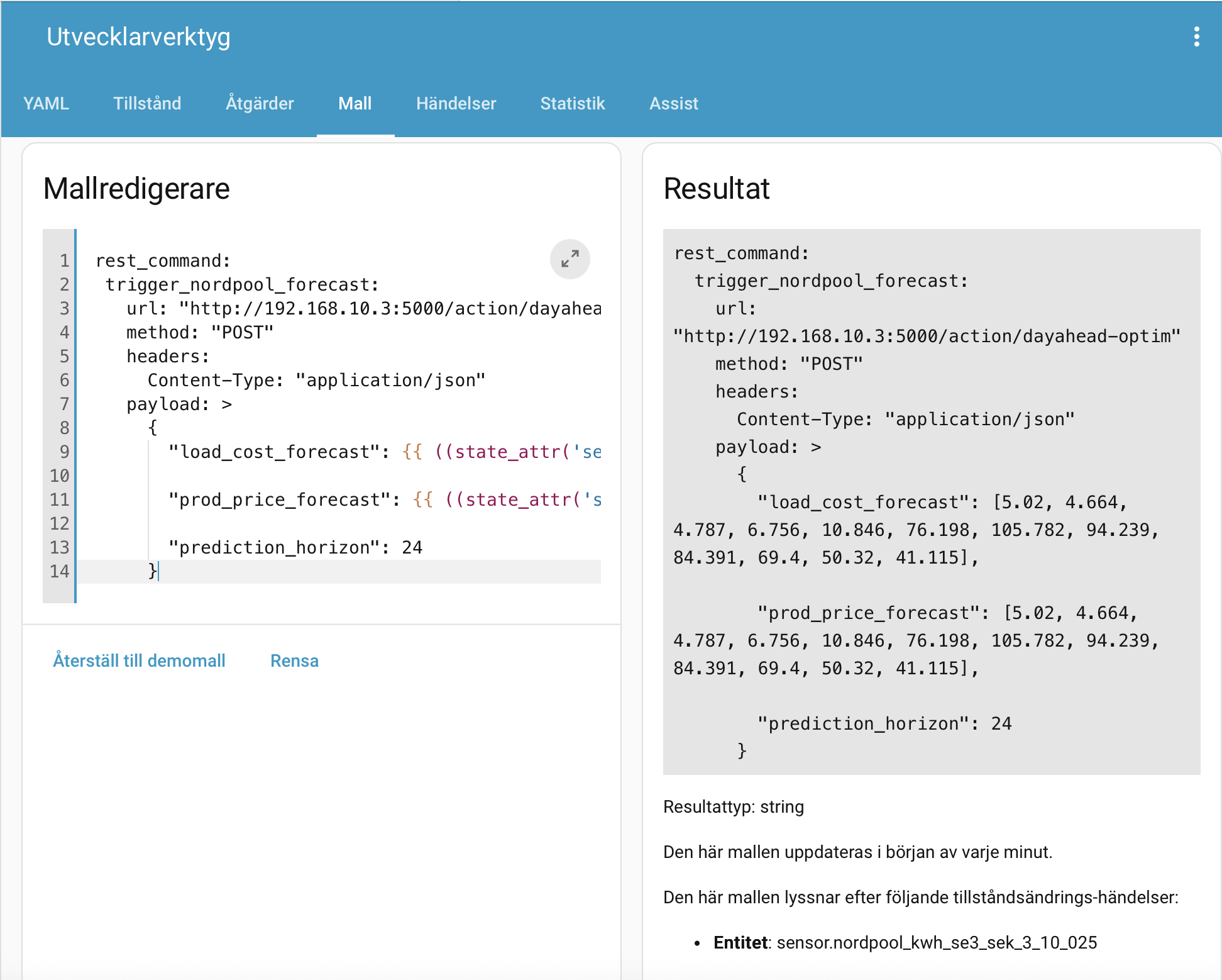

The commas are back in the template, and the dev.tools return this when running the whole template:
the commas are present at end of each array. But right now i only get 12 datapoints, probably because the Nordpool only updates once a day in afternoon (13.30 i think)

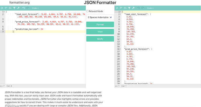

When i now post the json output from the dev.tool in the validator it looks legit?

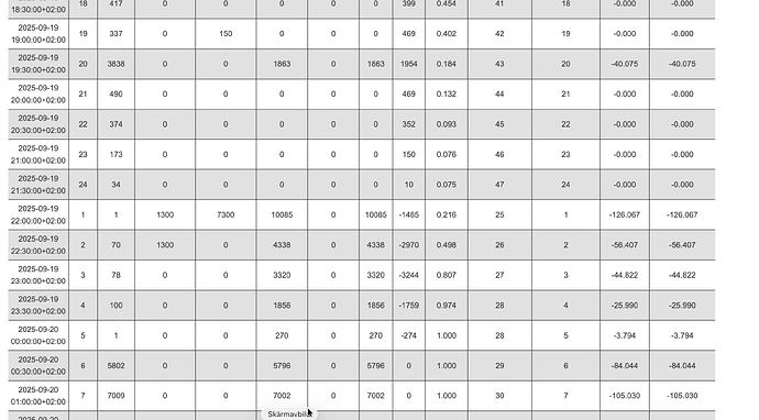

It looks like in the logs, that;

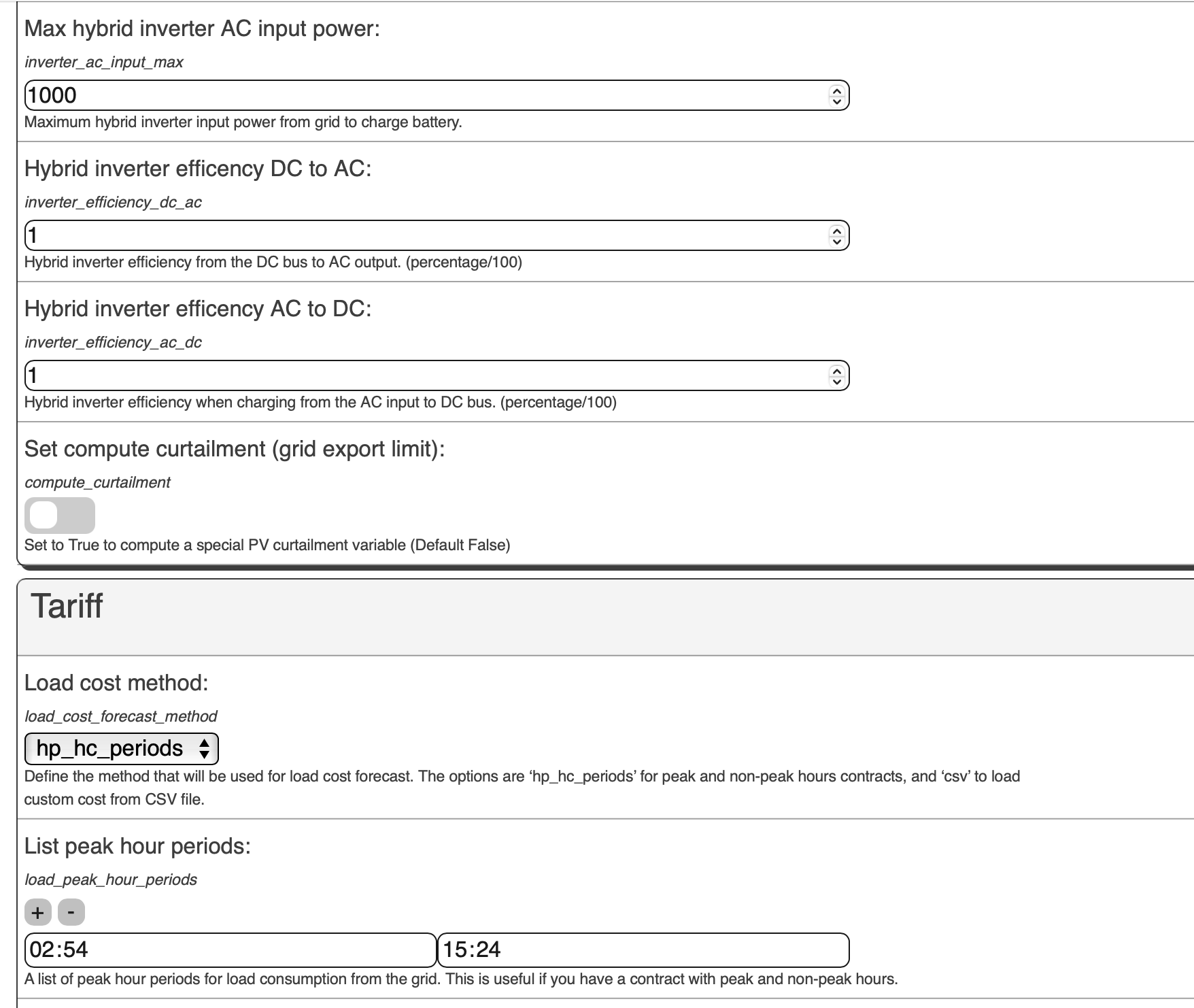

a) the nordpool data is not overwriting the “hp_hc periods”. Supported by the error 500 when running rest_command from dev.tools.
b) The day-ahead optimization does not give any result what so ever, even with the “hp_hc” prices shown in the log. Must be something else thats wrong in my setup too???

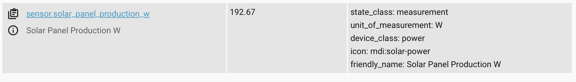

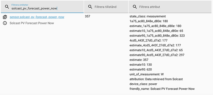

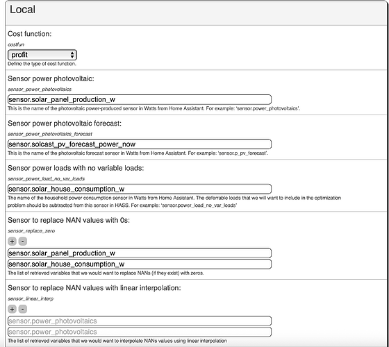

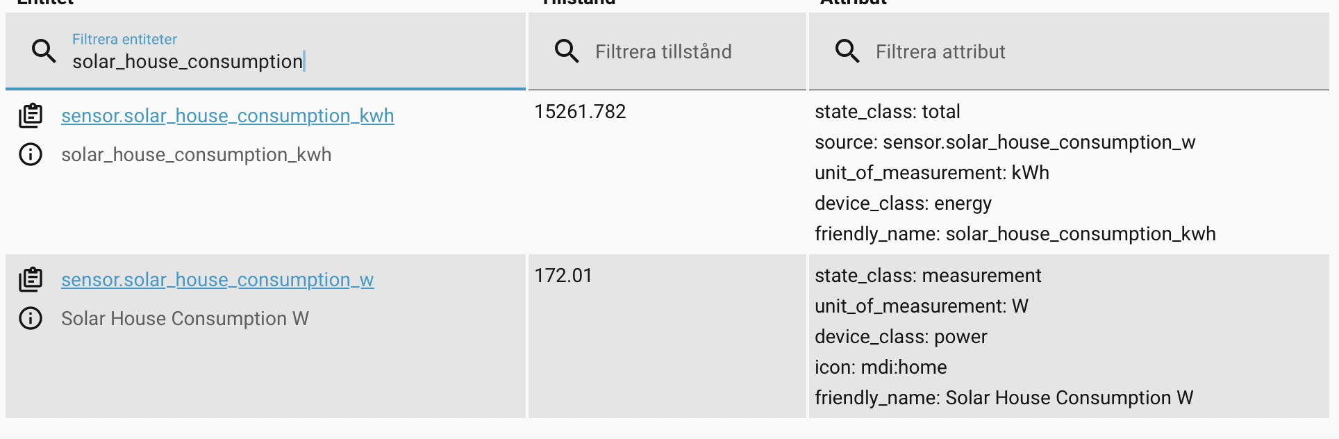

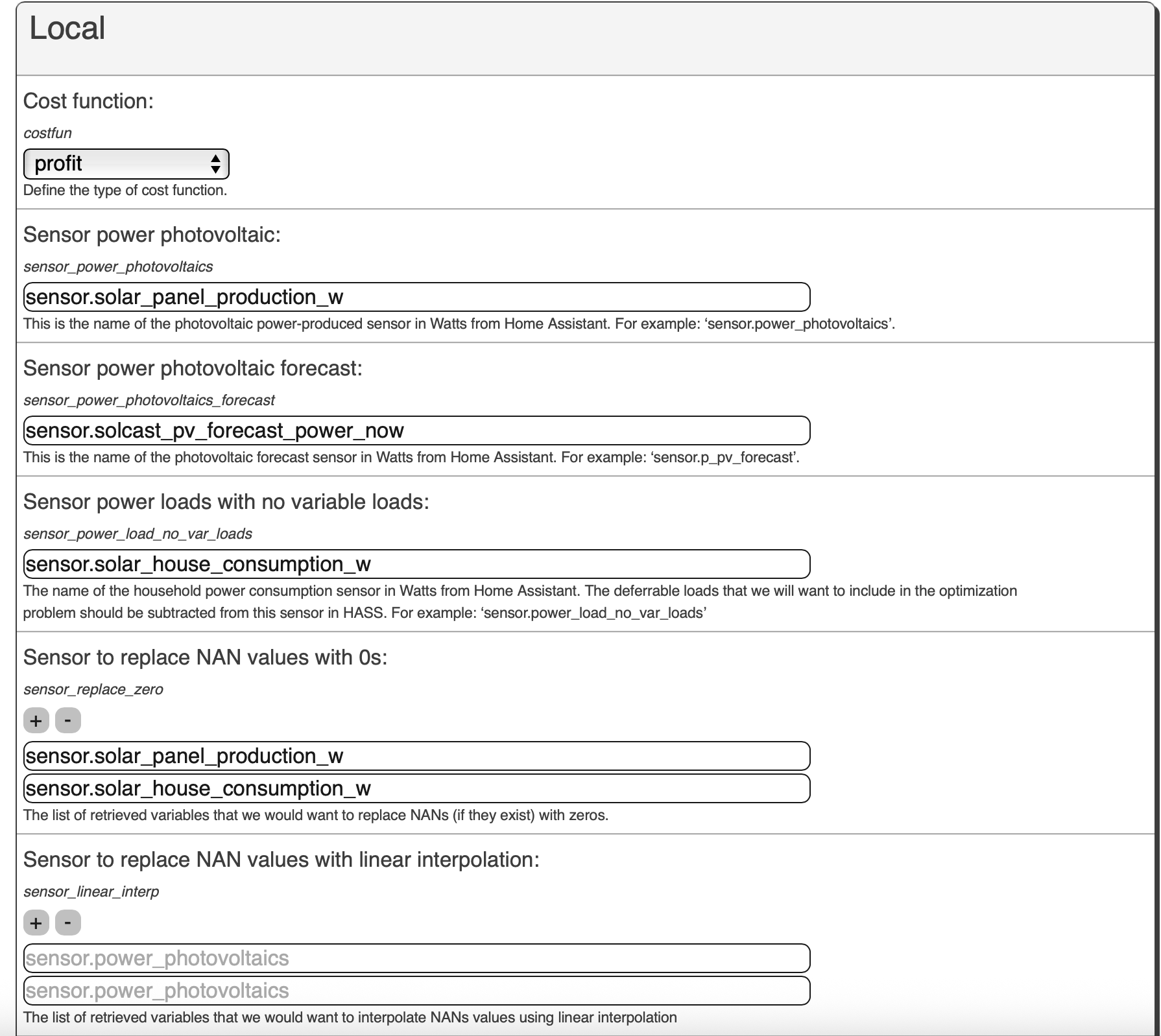

Closed down battery and PV to narrow down the problem. This is how setup now looks;

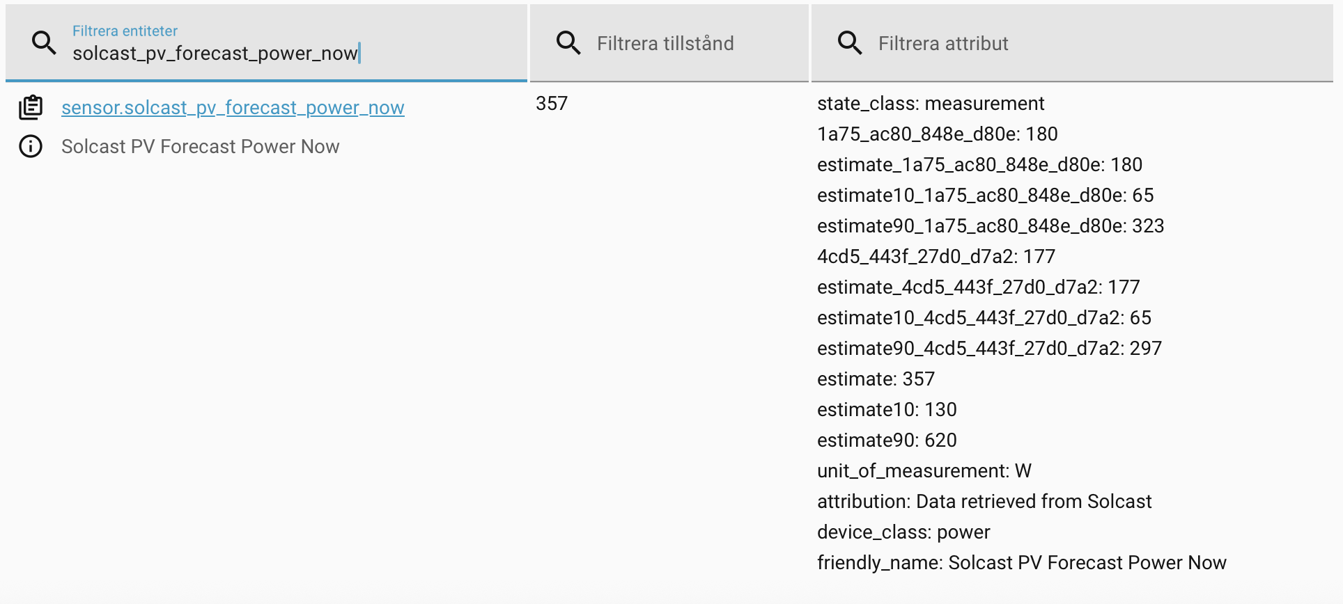

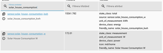

the sensor solar_panel_production_w is working;
as well as the solcast_pv_forecast_power_now:
and solar_house_consumption_w:

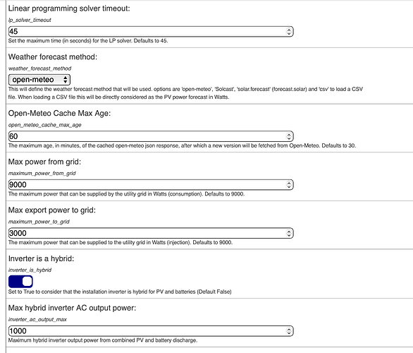

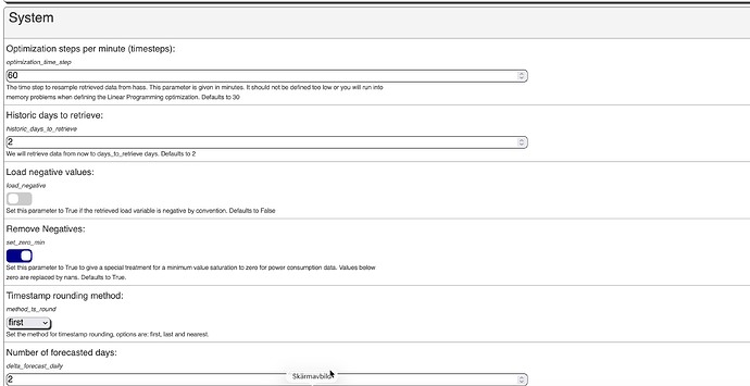

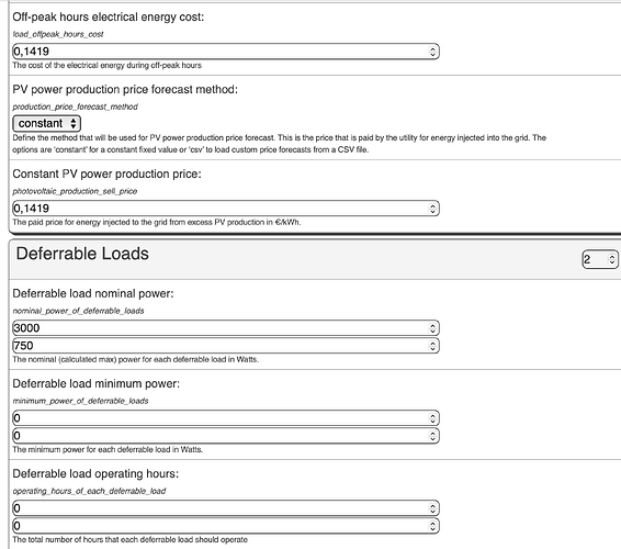

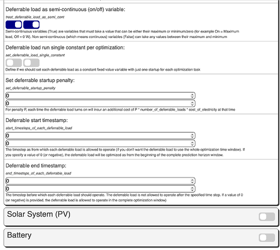

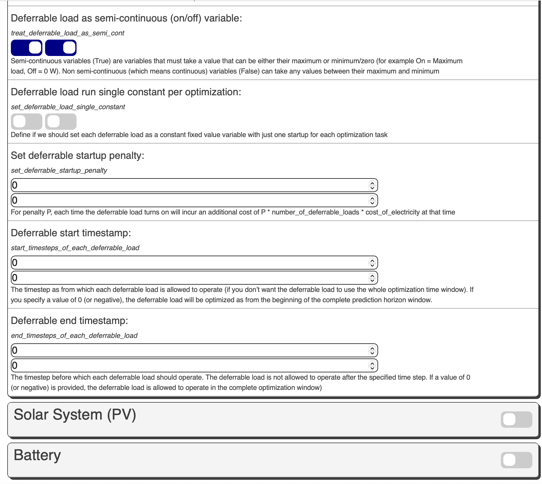

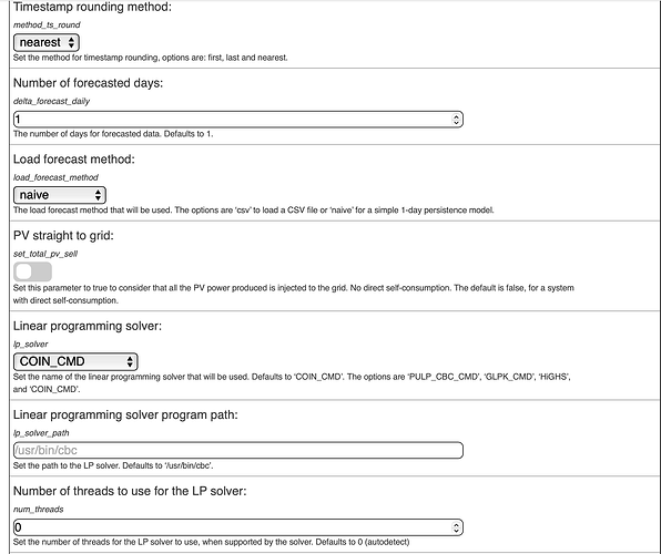

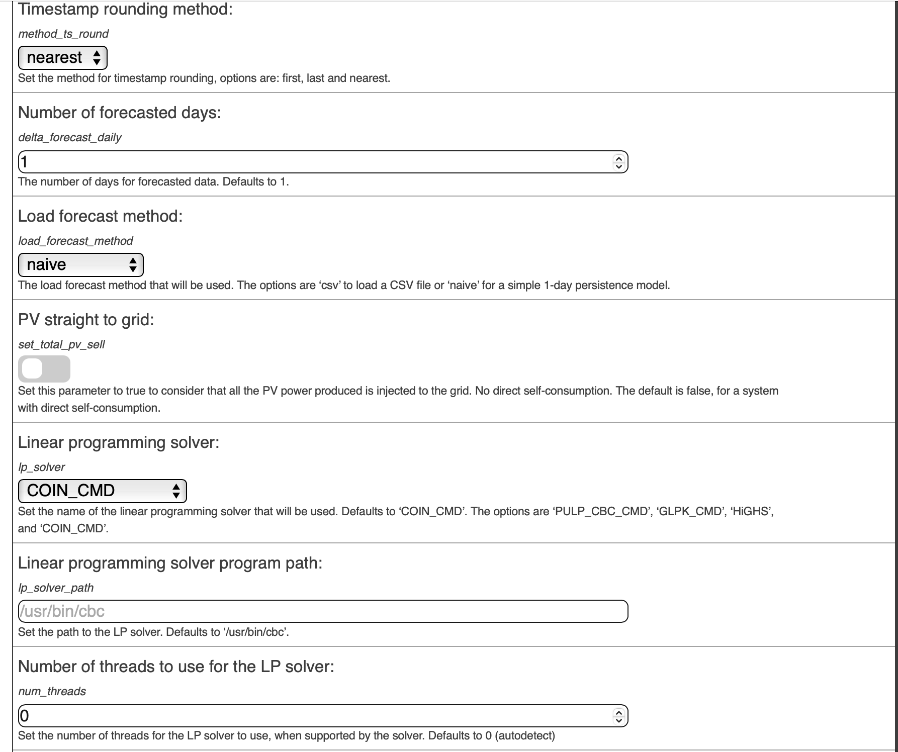

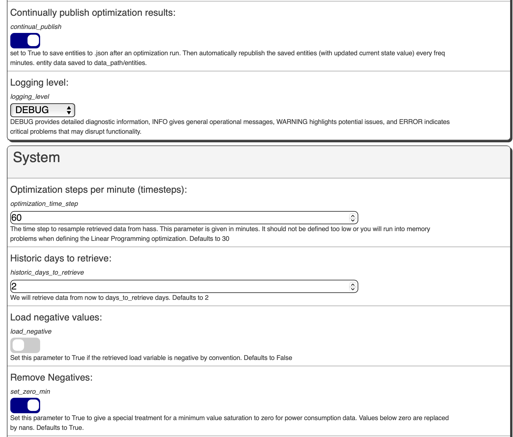

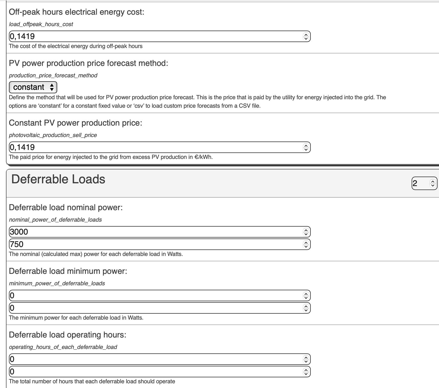

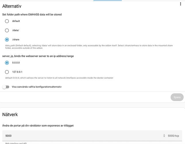

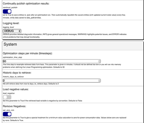

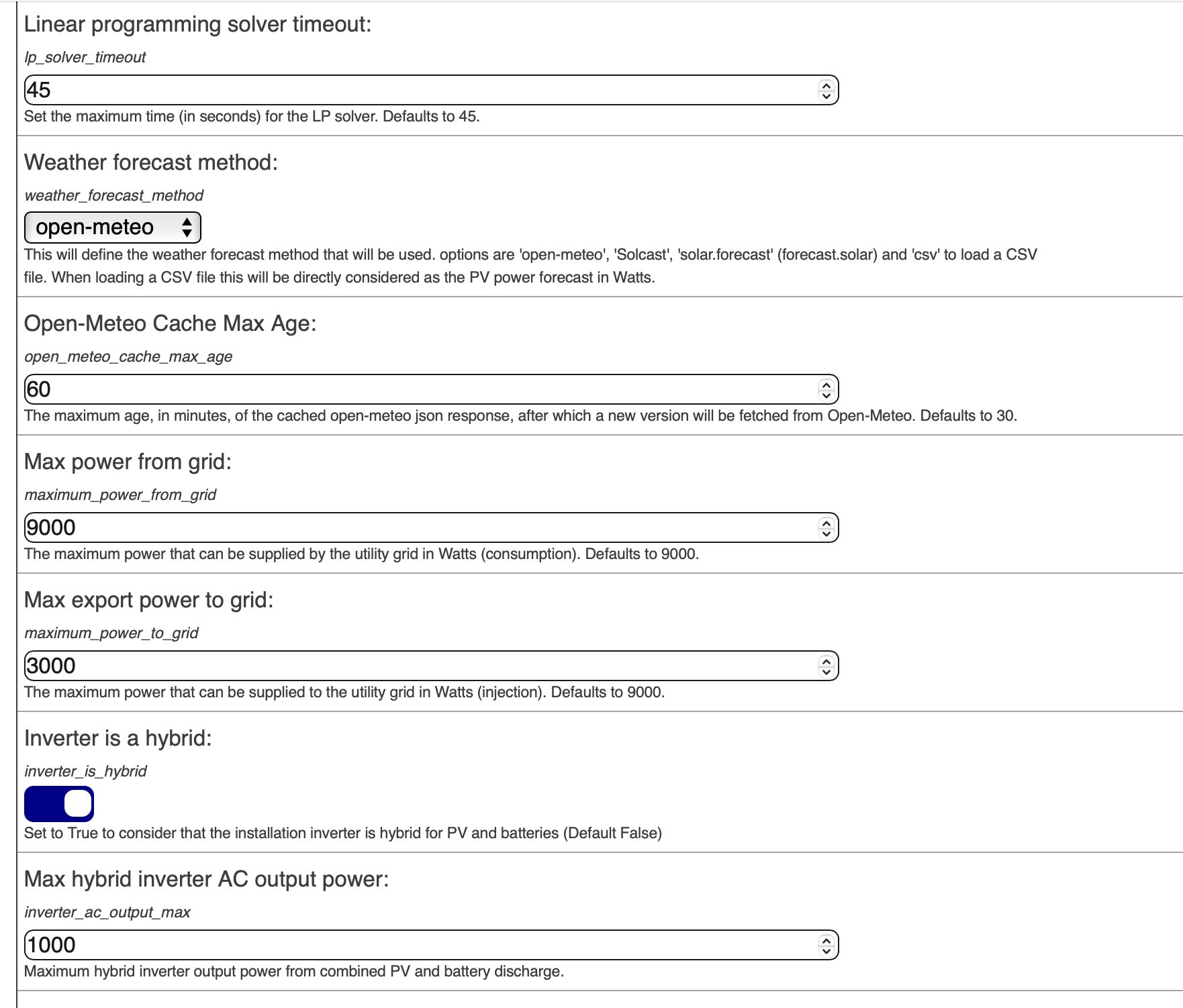

The config:
Could it be an error in automations.yaml like described here:
https://community.home-assistant.io/t/response-error-500/291887/11
Here’s another example of dynamic prediction horison template from Johan71 in this forum above:
"prediction_horizon":{{min(24, (((state_attr("sensor.nordpool_kwh_se3_sek_3_10_025", "raw_today")|map(attribute="value")|list + state_attr("sensor.nordpool_kwh_se3_sek_3_10_025", "raw_tomorrow") | map(attribute="value")| list)[now().hour:][:48]|list|length)))}},
However I think this is for a time slice of 30 minutes. Not sure what you are working with now? Has Nordpool moved to 15 minutes?
Anyway, looking at your configuration. This is my config:
  "adjusted_pv_regression_model": "LassoRegression",
  "adjusted_pv_solar_elevation_threshold": 10,
  "battery_charge_efficiency": 0.95,
  "battery_charge_power_max": 3300,
  "battery_discharge_efficiency": 0.9,
  "battery_discharge_power_max": 3300,
  "battery_dynamic_max": 0.9,
  "battery_dynamic_min": -0.9,
  "battery_maximum_state_of_charge": 1,
  "battery_minimum_state_of_charge": 0,
  "battery_nominal_energy_capacity": 13950,
  "battery_target_state_of_charge": 0,
  "compute_curtailment": false,
  "continual_publish": false,
  "costfun": "profit",
  "delta_forecast_daily": 1,
  "end_timesteps_of_each_deferrable_load": [
    0,
    0
  "historic_days_to_retrieve": 2,
  "inverter_is_hybrid": false,
  "load_cost_forecast_method": "hp_hc_periods",
  "load_forecast_method": "naive",
  "load_negative": false,
  "load_offpeak_hours_cost": 0.1419,
  "load_peak_hour_periods": {
    "period_hp_1": [
        "start": "02:54"
        "end": "15:24"
    "period_hp_2": [
        "start": "17:24"
        "end": "20:24"
  "load_peak_hours_cost": 0.1907,
  "logging_level": "INFO",
  "lp_solver": "COIN_CMD",
  "lp_solver_path": "empty",
  "lp_solver_timeout": 45,
  "maximum_power_from_grid": 14490,
  "maximum_power_to_grid": 9000,
  "method_ts_round": "first",
  "minimum_power_of_deferrable_loads": [
    0,
    0
  "modules_per_string": [
    17
  "nominal_power_of_deferrable_loads": [
    1300,
    7300
  "num_threads": 0,
  "number_of_deferrable_loads": 2,
  "open_meteo_cache_max_age": 30,
  "operating_hours_of_each_deferrable_load": [
    2,
    1
  "optimization_time_step": 30,
  "photovoltaic_production_sell_price": 0.1419,
  "production_price_forecast_method": "constant",
  "pv_inverter_model": [
    "Fronius_International_GmbH__Fronius_Primo_6_0_1_208_240__240V_"
  "pv_module_model": [
    "CSUN_Eurasia_Energy_Systems_Industry_and_Trade_CSUN295_60M"
  "sensor_linear_interp": [
    "sensor.house_power_consumption_less_deferrables"
  "sensor_power_load_no_var_loads": "sensor.house_power_consumption_less_deferrables",
  "sensor_power_photovoltaics": "sensor.sonnenbatterie_84324_production_w",
  "sensor_power_photovoltaics_forecast": "sensor.p_pv_forecast",
  "sensor_replace_zero": [
  "set_battery_dynamic": true,
  "set_deferrable_load_single_constant": [
    false,
    false
  "set_deferrable_startup_penalty": [
    0,
    0
  "set_nocharge_from_grid": false,
  "set_nodischarge_to_grid": false,
  "set_total_pv_sell": false,
  "set_use_adjusted_pv": false,
  "set_use_battery": true,
  "set_use_pv": true,
  "set_zero_min": true,
  "start_timesteps_of_each_deferrable_load": [
    0,
    0
  "strings_per_inverter": [
    1
  "surface_azimuth": [
    10
  "surface_tilt": [
    21
  "treat_deferrable_load_as_semi_cont": [
    true,
    false
  "weather_forecast_method": "open-meteo",
  "weight_battery_charge": 0,
  "weight_battery_discharge": 0
Maybe. Went through all the automations. Still no go.
Yes! Finally some progress :slight_smile:
Reinstalled EMHASS, and applied your config. Just changed the ```
“sensor_power_load_no_var_loads”, “sensor_power_photovoltaics”, and
“sensor_power_photovoltaics_forecast”

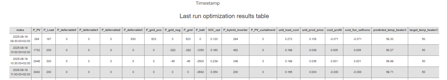

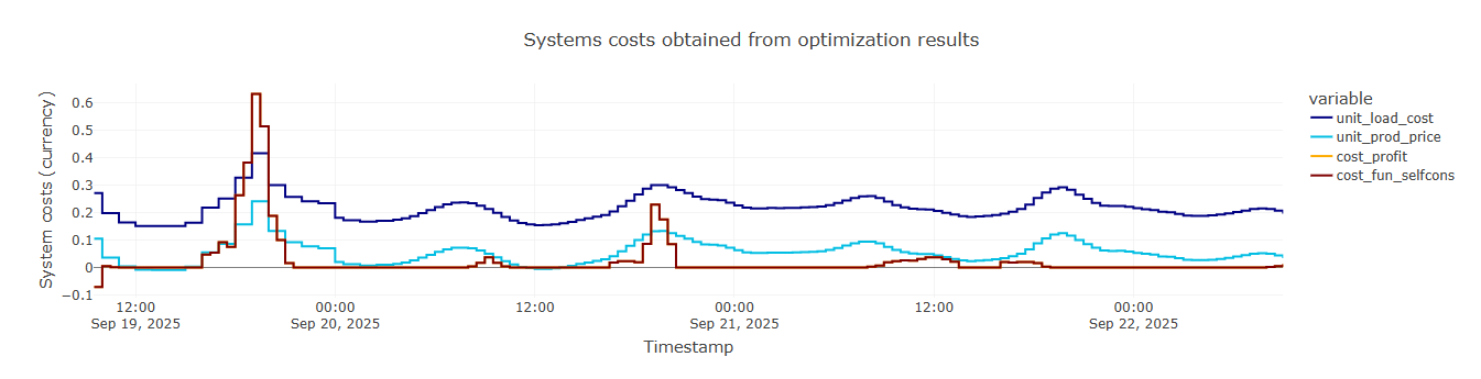

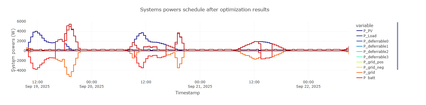

The error 500 is gone, and finally i actually can run the dayahead optimization and get a graph again!
Not that it imports the Nordpool-data, but atleast a graph!
Nordpool still runs on 1h, will move to 15min 1/10.

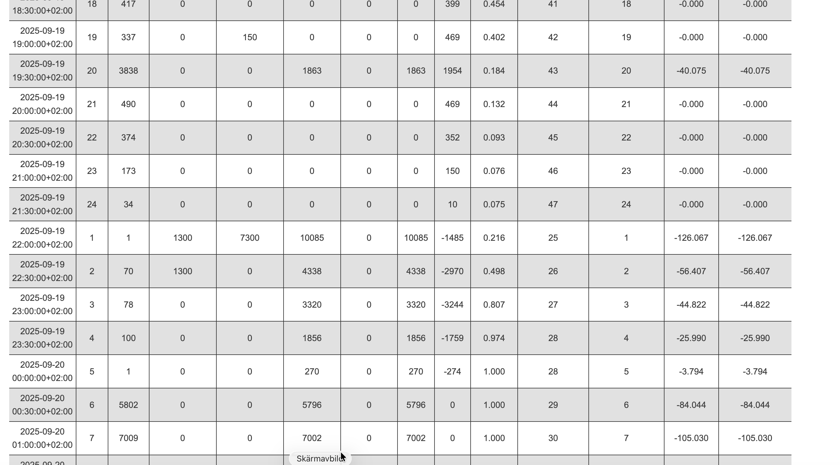

I am now down to trying to post just a fixed list of numbers with the rest_command. Nu success.
 method: POST
    headers:
      Content-Type: "application/json"
    payload: >
        "pv_power_forecast": [1, 2, 3, 4, 5, 6, 7, 8, 9, 10, 11, 12, 13, 14, 15, 16, 17, 18, 19, 20, 21, 22, 23, 24],
        "prediction_horizon": 24,
        "prod_price_forecast": [1, 2, 3, 4, 5, 6, 7, 8, 9, 10, 11, 12, 13, 14, 15, 16, 17, 18, 19, 20, 21, 22, 23, 24],
        "load_cost_forecast": [25, 26, 27, 28, 28, 29, 30, 31, 32, 33, 34, 35, 36, 37, 38, 39, 40, 41, 42, 43, 44]

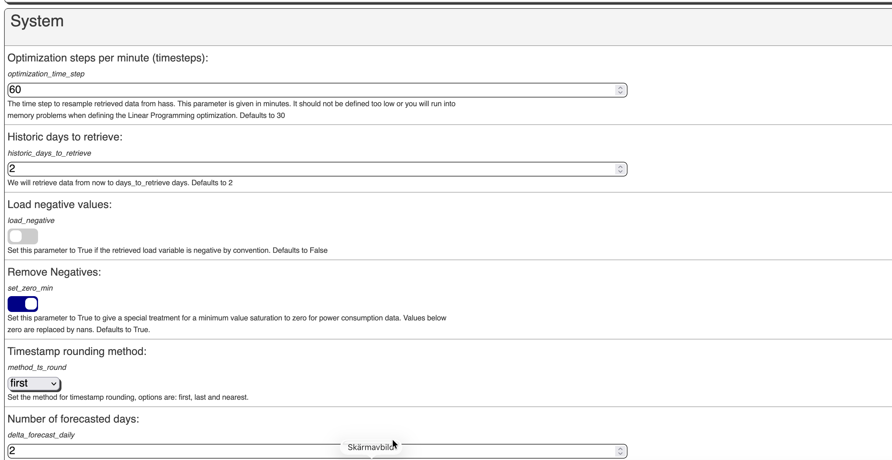

But there is absolutely none of these values posted in the “table” after running the day-ahead optimization. The unit_load_cost is still showing the hc_lc values. aso.
The timestep is set to 60, and as you see i only try to pass arrays with 24 values in each.

Hi, using the thermal model for my waterpumpboiler. P_deferrable3 = DHW
Results of the optimization doesn’t make sense to me:
Heating up will price is high, battery is empty and 1h later there is plenty of PV power available.
This was more than usually stupid by me…Thnx for pointing out the wrong numbers!
So, added up to 24 in each row. Still not working.
Notice in the output that it keeps publishing in 30min. timesteps despite the timestep set to 60 in config.
Changed the rows to 48numbers, and NOW they go through and into the publish!
SO, there seem to be a problem with the change of timestep in the config file, that is not updated in EMHASS, that keep running on 30min. timestep!
This is now the rest_command array:
    payload: >
        "pv_power_forecast": [1, 2, 3, 4, 5, 6, 7, 8, 9, 10, 11, 12, 13, 14, 15, 16, 17, 18, 19, 20, 21, 22, 23, 24, 1, 2, 3, 4, 5, 6, 7, 8, 9, 10, 11, 12, 13, 14, 15, 16, 17, 18, 19, 20, 21, 22, 23, 24],
        "prod_price_forecast": [1, 2, 3, 4, 5, 6, 7, 8, 9, 10, 11, 12, 13, 14, 15, 16, 17, 18, 19, 20, 21, 22, 23, 24, 1, 2, 3, 4, 5, 6, 7, 8, 9, 10, 11, 12, 13, 14, 15, 16, 17, 18, 19, 20, 21, 22, 23, 24],
        "load_cost_forecast": [25, 26, 27, 28, 28, 29, 30, 31, 32, 33, 34, 35, 36, 37, 38, 39, 40, 41, 42, 43, 44, 45, 46, 47, 25, 26, 27, 28, 28, 29, 30, 31, 32, 33, 34, 35, 36, 37, 38, 39, 40, 41, 42, 43, 44, 45, 46, 47]
From /share/config.json
    "optimization_time_step": 60,
    "data_path": "default",
From GUI:
From publish, picture of middle of the table (to save space in thread that i already occupy quite alot) as seen it publish 30min timesteps, and the “numbers” start over from 24 to 1:
Can you post your complete configuration in JSON format (select the <> symbol at the top of the configuration UI) and your logfile.
  "battery_nominal_energy_capacity": 5000,
  "delta_forecast_daily": 2,
    0,
    0
  "inverter_ac_input_max": 1000,
  "inverter_ac_output_max": 1000,
  "inverter_efficiency_ac_dc": 1,
  "inverter_efficiency_dc_ac": 1,
    "period_hp_1": [
        "start": "02:54"
        "end": "15:24"
    "period_hp_2": [
        "start": "17:24"
        "end": "20:24"
    0,
    0
    17
    1300,
    7300
  "num_threads": 0,
    2,
    1
    "sensor.power_myhouse_load_no_var_loads"
  "sensor_power_load_no_var_loads": "sensor.power_myhouse_load_no_var_loads",
  "sensor_power_photovoltaics": "sensor.solar_panel_production_w",
    "sensor.solar_battery_out_to_grid_and_house_w"
    false,
    false
    0,
    0
  "set_use_pv": true,
    0,
    0
    1
    10
  "surface_tilt": [
    21
    true,
    false

2025-09-19 18:00:00+02:00           16.0       617.779500              39
2025-09-19 18:30:00+02:00           17.0       417.269550              40
2025-09-19 19:00:00+02:00           18.0       337.203683              41
2025-09-19 19:30:00+02:00           19.0      3838.144254              42
2025-09-19 20:00:00+02:00           20.0       490.172500              43
2025-09-19 20:30:00+02:00           21.0       374.927710              44
2025-09-19 21:00:00+02:00           22.0       173.575000              45
2025-09-19 21:30:00+02:00           23.0        34.343987              46
2025-09-19 22:00:00+02:00           24.0         1.368162              47
2025-09-19 22:30:00+02:00            1.0        70.970756              25
2025-09-19 23:00:00+02:00            2.0        78.355745              26
2025-09-19 23:30:00+02:00            3.0       100.685644              27
2025-09-20 00:00:00+02:00            4.0         1.192500              28
2025-09-20 00:30:00+02:00            5.0      5802.166667              28
2025-09-20 01:00:00+02:00            6.0      7009.000000              29
2025-09-20 01:30:00+02:00            7.0      6987.500000              30
2025-09-20 02:00:00+02:00            8.0      7004.285714              31
2025-09-20 02:30:00+02:00            9.0      6970.000000              32
2025-09-20 03:00:00+02:00           10.0      6962.857143              33
2025-09-20 03:30:00+02:00           11.0      9020.000000              34
2025-09-20 04:00:00+02:00           12.0     10411.285714              35
2025-09-20 04:30:00+02:00           13.0      9105.181818              36
2025-09-20 05:00:00+02:00           14.0      9000.714286              37
2025-09-20 05:30:00+02:00           15.0      8172.304167              38
2025-09-20 06:00:00+02:00           16.0       420.465000              39
2025-09-20 06:30:00+02:00           17.0       423.874856              40
2025-09-20 07:00:00+02:00           18.0       854.498067              41
2025-09-20 07:30:00+02:00           19.0       389.255333              42
2025-09-20 08:00:00+02:00           20.0       278.366683              43
2025-09-20 08:30:00+02:00           21.0       289.961367              44
2025-09-20 09:00:00+02:00           22.0       245.988800              45
2025-09-20 09:30:00+02:00           23.0       261.865636              46
2025-09-20 10:00:00+02:00           24.0       249.903667              47

Key issues in the config vs. logs
  1. Mismatched time step
  • Config: "optimization_time_step": 60 (minutes, so 1-hour resolution).
  • Logs: optimization_time_step': Timedelta('0 days 00:30:00') → EMHASS is interpreting it as 30 minutes.
  • This mismatch usually happens if prediction_horizon length (24) and the number of points passed (48) don’t align with the optimization time step.
  • Your runtime data (pv_power_forecast etc.) has 48 values → EMHASS assumes half-hour steps, not 1-hour.
:white_check_mark: Fix: Either:
  • set optimization_time_step: 30 in config,
    OR
  • pass only 24 values (not 48) if you really want 60-minute resolution.
  1. Forecast methods overridden by lists
  • Config has "load_cost_forecast_method": "hp_hc_periods" and "production_price_forecast_method": "constant".
  • But logs show load_cost_forecast_method: list and production_price_forecast_method: list.
  • That’s because you passed explicit arrays (prod_price_forecast, load_cost_forecast) in runtime parameters.
  • This is fine, just know that your config methods are ignored when you supply lists.
  1. Inverter AC limits
  • Config has "inverter_ac_output_max": 1000 and "inverter_ac_input_max": 1000.
  • That caps PV → grid and grid → load to just 1 kW!
  • But your PV model is Primo 6.0-1 (6 kW inverter).
  • So your optimization will think you can only export/import 1 kW total, which is wrong.
  • "inverter_ac_output_max": 6000
  • "inverter_ac_input_max": 6000 (or higher if allowed).
  1. Battery target SOC = 0
  • "battery_target_state_of_charge": 0 → optimizer has no incentive to preserve charge for later periods.
  • This often results in battery discharging fully as soon as it’s profitable.
  • You many waht to set something like 0.2 or 0.3 (20–30%) to preserve minimum energy. But you don’t have to.
  1. Deferrable loads config
  • You’ve got 2 loads: [1300, 7300] W.
  • "operating_hours_of_each_deferrable_load": [2, 1] → they must run 2h and 1h per horizon.
  • But start and end times are both [0, 0] → means EMHASS can schedule them anywhere.
  • That’s OK, just be aware EMHASS is free to place them wherever costs are lowest. If you want them locked into windows, you need real start/end step numbers.
Thnx again for all help!
Reverted back to the 24 number arrays.
payload: >
        "load_cost_forecast": [25, 26, 27, 28, 28, 29, 30, 31, 32, 33, 34, 35, 36, 37, 38, 39, 40, 41, 42, 43, 44, 45, 46, 47]
Ran the rest_command.
Again, the array is not added in EMHASS. The computation is based on the hc_lc prices, and the timestep still is 30 min.
SO, still believe that by some reason, the change of timestep doesnt seem to have effect. And i can only import 48 number arrays in timestep of 30min!!
see log:

[2025-09-20 00:37:40 +0200] [23] [DEBUG] get_power_from_weather returning:
2025-09-20 00:30:00+02:00      0.000000
2025-09-20 01:00:00+02:00      0.000000
2025-09-20 01:30:00+02:00      0.000000
2025-09-20 02:00:00+02:00      0.000000
2025-09-20 02:30:00+02:00      0.000000
2025-09-20 03:00:00+02:00      0.000000
2025-09-20 03:30:00+02:00      0.000000
2025-09-20 04:00:00+02:00      0.000000
2025-09-20 04:30:00+02:00      0.000000
2025-09-20 05:00:00+02:00      0.000000
2025-09-20 05:30:00+02:00      0.000000
2025-09-20 06:00:00+02:00      0.000000
2025-09-20 06:30:00+02:00      0.000000
2025-09-20 07:00:00+02:00      0.000000
2025-09-20 07:30:00+02:00     52.753367
2025-09-20 08:00:00+02:00    143.604149
2025-09-20 08:30:00+02:00    246.909983
2025-09-20 09:00:00+02:00    389.462767
2025-09-20 09:30:00+02:00    551.590477
2025-09-20 10:00:00+02:00    659.795442
2025-09-20 10:30:00+02:00    740.798266
2025-09-20 11:00:00+02:00    833.220026
2025-09-20 11:30:00+02:00    904.022853
2025-09-20 12:00:00+02:00    900.484450
2025-09-20 12:30:00+02:00    859.191958
2025-09-20 13:00:00+02:00    949.050396
2025-09-20 13:30:00+02:00    900.378191
2025-09-20 14:00:00+02:00    836.257399
2025-09-20 14:30:00+02:00    769.981402
2025-09-20 15:00:00+02:00    689.710427
2025-09-20 15:30:00+02:00    602.088071
2025-09-20 16:00:00+02:00    517.615094
2025-09-20 16:30:00+02:00    437.564567
2025-09-20 17:00:00+02:00    358.005471
2025-09-20 17:30:00+02:00    274.257905
2025-09-20 18:00:00+02:00    182.222218
2025-09-20 18:30:00+02:00     76.939975
2025-09-20 19:00:00+02:00      0.000000
2025-09-20 19:30:00+02:00      0.000000
2025-09-20 20:00:00+02:00      0.000000
2025-09-20 20:30:00+02:00      0.000000
2025-09-20 21:00:00+02:00      0.000000
2025-09-20 21:30:00+02:00      0.000000
2025-09-20 22:00:00+02:00      0.000000
2025-09-20 22:30:00+02:00      0.000000
2025-09-20 23:00:00+02:00      0.000000
2025-09-20 23:30:00+02:00      0.000000
2025-09-21 00:00:00+02:00      0.000000
Freq: 30min, dtype: float64
[2025-09-20 00:37:40 +0200] [23] [INFO] Retrieving data from hass for load forecast using method = naive
[2025-09-20 00:37:40 +0200] [23] [INFO] Retrieve hass get data method initiated...
[2025-09-20 00:37:41 +0200] [23] [DEBUG] prepare_data self.var_list=['sensor.power_myhouse_load_no_var_loads']
[2025-09-20 00:37:41 +0200] [23] [DEBUG] prepare_data var_load=sensor.power_myhouse_load_no_var_loads
[2025-09-20 00:37:41 +0200] [23] [DEBUG] prepare_data load_negative=False
[2025-09-20 00:37:41 +0200] [23] [DEBUG] prepare_data set_zero_min=True
[2025-09-20 00:37:41 +0200] [23] [DEBUG] prepare_data var_replace_zero=None
[2025-09-20 00:37:41 +0200] [23] [DEBUG] prepare_data var_interp=['sensor.power_myhouse_load_no_var_loads']
[2025-09-20 00:37:41 +0200] [23] [DEBUG] get_load_forecast returning:
2025-09-20 00:30:00+02:00     5802.166667
2025-09-20 01:00:00+02:00     7009.000000
2025-09-20 01:30:00+02:00     6987.500000
2025-09-20 02:00:00+02:00     7004.285714
2025-09-20 02:30:00+02:00     6970.000000
2025-09-20 03:00:00+02:00     6962.857143
2025-09-20 03:30:00+02:00     9020.000000
2025-09-20 04:00:00+02:00    10411.285714
2025-09-20 04:30:00+02:00     9105.181818
2025-09-20 05:00:00+02:00     9000.714286
2025-09-20 05:30:00+02:00     8172.304167
2025-09-20 06:00:00+02:00      420.465000
2025-09-20 06:30:00+02:00      423.874856
2025-09-20 07:00:00+02:00      854.498067
2025-09-20 07:30:00+02:00      389.255333
2025-09-20 08:00:00+02:00      278.366683
2025-09-20 08:30:00+02:00      289.961367
2025-09-20 09:00:00+02:00      245.988800
2025-09-20 09:30:00+02:00      261.865636
2025-09-20 10:00:00+02:00      249.903667
2025-09-20 10:30:00+02:00      208.670000
2025-09-20 11:00:00+02:00      511.338333
2025-09-20 11:30:00+02:00      805.836250
2025-09-20 12:00:00+02:00      178.190000
2025-09-20 12:30:00+02:00      119.761250
2025-09-20 13:00:00+02:00      132.333333
2025-09-20 13:30:00+02:00      121.722500
2025-09-20 14:00:00+02:00       64.693333
2025-09-20 14:30:00+02:00       74.296667
2025-09-20 15:00:00+02:00      341.426667
2025-09-20 15:30:00+02:00      145.084444
2025-09-20 16:00:00+02:00       86.147833
2025-09-20 16:30:00+02:00      142.053300
2025-09-20 17:00:00+02:00     1214.656517
2025-09-20 17:30:00+02:00      248.987300
2025-09-20 18:00:00+02:00      256.158800
2025-09-20 18:30:00+02:00      189.895750
2025-09-20 19:00:00+02:00      216.938333
2025-09-20 19:30:00+02:00      169.537289
2025-09-20 20:00:00+02:00      150.405117
2025-09-20 20:30:00+02:00      261.000100
2025-09-20 21:00:00+02:00      292.655767
2025-09-20 21:30:00+02:00      217.448978
2025-09-20 22:00:00+02:00       91.111967
2025-09-20 22:30:00+02:00       40.081500
2025-09-20 23:00:00+02:00        2.216120
2025-09-20 23:30:00+02:00       43.404463
2025-09-21 00:00:00+02:00        1.437750
Name: yhat, dtype: float64
[2025-09-20 00:37:41 +0200] [23] [INFO]  >> Performing dayahead optimization...
[2025-09-20 00:37:41 +0200] [23] [INFO] Performing day-ahead forecast optimization
[2025-09-20 00:37:41 +0200] [23] [DEBUG] get_load_cost_forecast returning:
                           P_PV_forecast  P_load_forecast  unit_load_cost
2025-09-20 00:30:00+02:00       0.000000      5802.166667          0.1419
2025-09-20 01:00:00+02:00       0.000000      7009.000000          0.1419
2025-09-20 01:30:00+02:00       0.000000      6987.500000          0.1419
2025-09-20 02:00:00+02:00       0.000000      7004.285714          0.1419
2025-09-20 02:30:00+02:00       0.000000      6970.000000          0.1419
2025-09-20 03:00:00+02:00       0.000000      6962.857143          0.1907
2025-09-20 03:30:00+02:00       0.000000      9020.000000          0.1907
2025-09-20 04:00:00+02:00       0.000000     10411.285714          0.1907
2025-09-20 04:30:00+02:00       0.000000      9105.181818          0.1907
2025-09-20 05:00:00+02:00       0.000000      9000.714286          0.1907
2025-09-20 05:30:00+02:00       0.000000      8172.304167          0.1907
2025-09-20 06:00:00+02:00       0.000000       420.465000          0.1907
2025-09-20 06:30:00+02:00       0.000000       423.874856          0.1907
2025-09-20 07:00:00+02:00       0.000000       854.498067          0.1907
2025-09-20 07:30:00+02:00      52.753367       389.255333          0.1907
2025-09-20 08:00:00+02:00     143.604149       278.366683          0.1907
2025-09-20 08:30:00+02:00     246.909983       289.961367          0.1907
2025-09-20 09:00:00+02:00     389.462767       245.988800          0.1907
2025-09-20 09:30:00+02:00     551.590477       261.865636          0.1907
2025-09-20 10:00:00+02:00     659.795442       249.903667          0.1907
2025-09-20 10:30:00+02:00     740.798266       208.670000          0.1907
2025-09-20 11:00:00+02:00     833.220026       511.338333          0.1907
2025-09-20 11:30:00+02:00     904.022853       805.836250          0.1907
2025-09-20 12:00:00+02:00     900.484450       178.190000          0.1907
2025-09-20 12:30:00+02:00     859.191958       119.761250          0.1907
2025-09-20 13:00:00+02:00     949.050396       132.333333          0.1907
2025-09-20 13:30:00+02:00     900.378191       121.722500          0.1907
2025-09-20 14:00:00+02:00     836.257399        64.693333          0.1907
2025-09-20 14:30:00+02:00     769.981402        74.296667          0.1907
2025-09-20 15:00:00+02:00     689.710427       341.426667          0.1907
2025-09-20 15:30:00+02:00     602.088071       145.084444          0.1419
2025-09-20 16:00:00+02:00     517.615094        86.147833          0.1419
2025-09-20 16:30:00+02:00     437.564567       142.053300          0.1419
2025-09-20 17:00:00+02:00     358.005471      1214.656517          0.1419
2025-09-20 17:30:00+02:00     274.257905       248.987300          0.1907
2025-09-20 18:00:00+02:00     182.222218       256.158800          0.1907
2025-09-20 18:30:00+02:00      76.939975       189.895750          0.1907
2025-09-20 19:00:00+02:00       0.000000       216.938333          0.1907
2025-09-20 19:30:00+02:00       0.000000       169.537289          0.1907
2025-09-20 20:00:00+02:00       0.000000       150.405117          0.1907
2025-09-20 20:30:00+02:00       0.000000       261.000100          0.1419
2025-09-20 21:00:00+02:00       0.000000       292.655767          0.1419
2025-09-20 21:30:00+02:00       0.000000       217.448978          0.1419
2025-09-20 22:00:00+02:00       0.000000        91.111967          0.1419
2025-09-20 22:30:00+02:00       0.000000        40.081500          0.1419
2025-09-20 23:00:00+02:00       0.000000         2.216120          0.1419
2025-09-20 23:30:00+02:00       0.000000        43.404463          0.1419
2025-09-21 00:00:00+02:00       0.000000         1.437750          0.1419

2025-09-20 18:00:00+02:00     182.222218  ...           0.1419
2025-09-20 18:30:00+02:00      76.939975  ...           0.1419
2025-09-20 19:00:00+02:00       0.000000  ...           0.1419
2025-09-20 19:30:00+02:00       0.000000  ...           0.1419
2025-09-20 20:00:00+02:00       0.000000  ...           0.1419
2025-09-20 20:30:00+02:00       0.000000  ...           0.1419
2025-09-20 21:00:00+02:00       0.000000  ...           0.1419
2025-09-20 21:30:00+02:00       0.000000  ...           0.1419
2025-09-20 22:00:00+02:00       0.000000  ...           0.1419
2025-09-20 22:30:00+02:00       0.000000  ...           0.1419
2025-09-20 23:00:00+02:00       0.000000  ...           0.1419
2025-09-20 23:30:00+02:00       0.000000  ...           0.1419
2025-09-21 00:00:00+02:00       0.000000  ...           0.1419
[48 rows x 4 columns]

It is also stated in the log [2025-09-20 00:37:37 +0200] [23] [ERROR] ERROR: The passed data is either the wrong type or the length is not correct, length should be 48.
Strange!
:x: “optimization_time_step”: 60 → Perhaps EMHASS interprets this weirdly (it ends up as 0:30:00 in your logs).
Try
:white_check_mark: “optimization_time_step”: “1:00:00”, → EMHASS might accept this as a 1-hour step or “0:30:00” for 30 min.
Restart EMHASS and see if it works.
