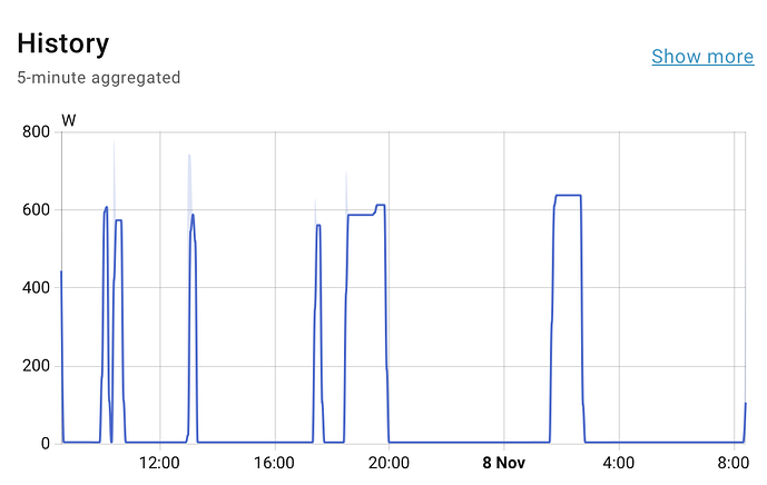

I have a question for the people who use a heatpumpboiler for DHW with the thermal model and rolling window with 5 min MPC runs. Do you see a nice planning with the heatpumpboiler getting warmed up during PV generation, but in the end EMHASS decides to start in the early mornings? I have a 15 kWh battery also. I just wonder why EMHASS deviates from it’s original planning when heading into the evening/night. You don’t expect big changes anymore in the forecasts at night for the next day. If you want to share your experience with this,that would be very helpful. Thank you all

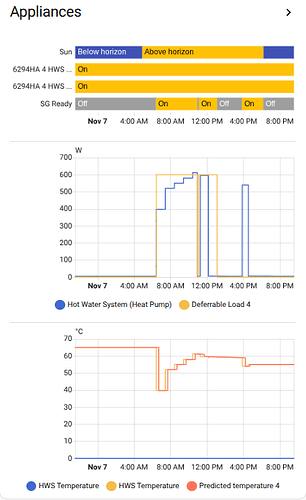

Enclosed you can see the behaviour with 5 min MPC
The internal logics prevent the heatpump to start

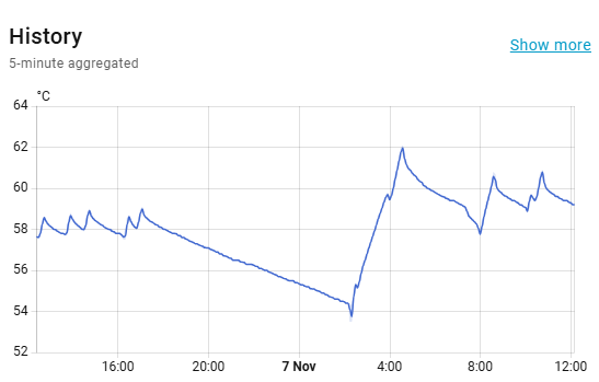

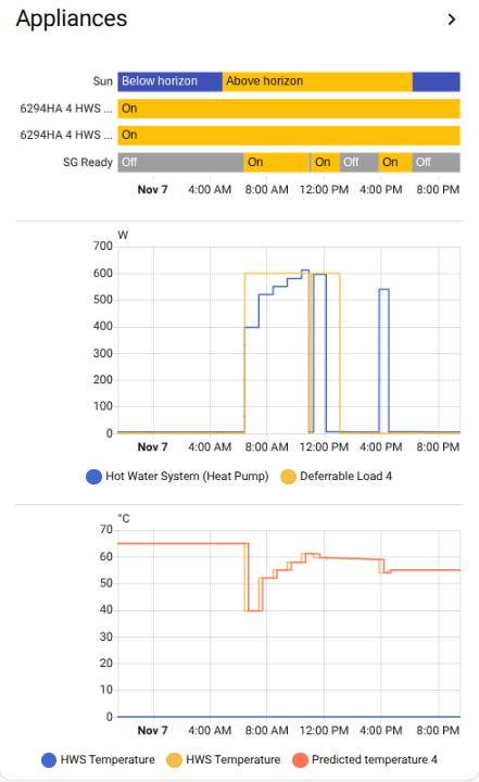

This is the temperature profile, I would expect one long run not all those in between starts.
I use the dry-contact to increase the setpoint, if deferrable > 0 then the dry-contact is closed and setpoint goes to 65°C until deferrable = 0, then back to 50°C

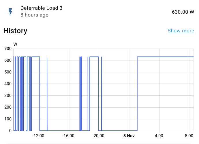

I have three thermal loads running HVAC (cooling), hot water and pool heating. I do see their schedules jump around after each 5 minute MPC run.

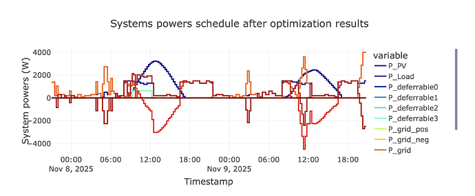

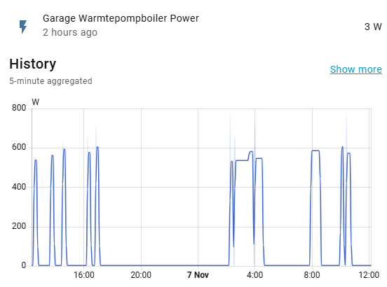

All looks nice, however heading towards evening/night I get these short starts 15 min runs plus the longer runs at approx 2:00 - 4:00 a.m.

Here is my hot water system
My desired_temperatures I allow it to cool to 40 deg overnight, but charge to 60 deg at 6 hours before sunset (set - 12) for 3 hours. Getting the desired_temperature profile is complicated.
Here is my hot water, I too use a change of setpoint (SG Ready = 65 deg C) when deferrable4 > 0.

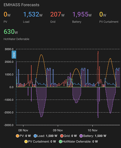

This is my setup. 15 min optimisation, I started the same as you @markpurcell
Same day hours later I get this:

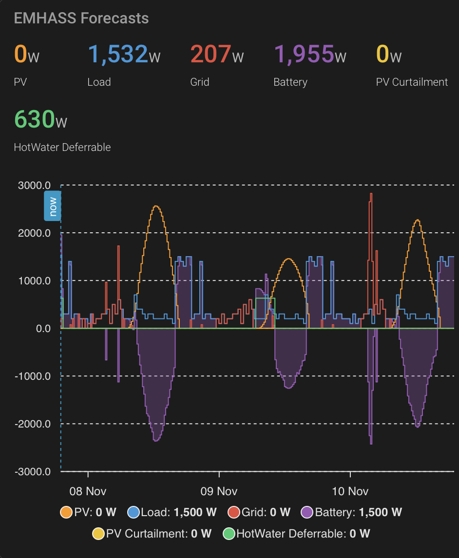

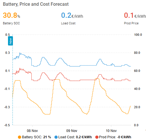

Totally shifted DHW with current 2 blocks planned. Maybe because pricing suddenly becomes very low, however that part is MLForecast model, will probably not be correct with real prices I get tomorrow at 1:30 pm
I have similar challenges with my ML forecast pricing.
The ML forecast has some very low costs in the future, so it defers startup until those lower prices.
It can also be useful to graph future temp_predicted4 (in my case) forecasts.

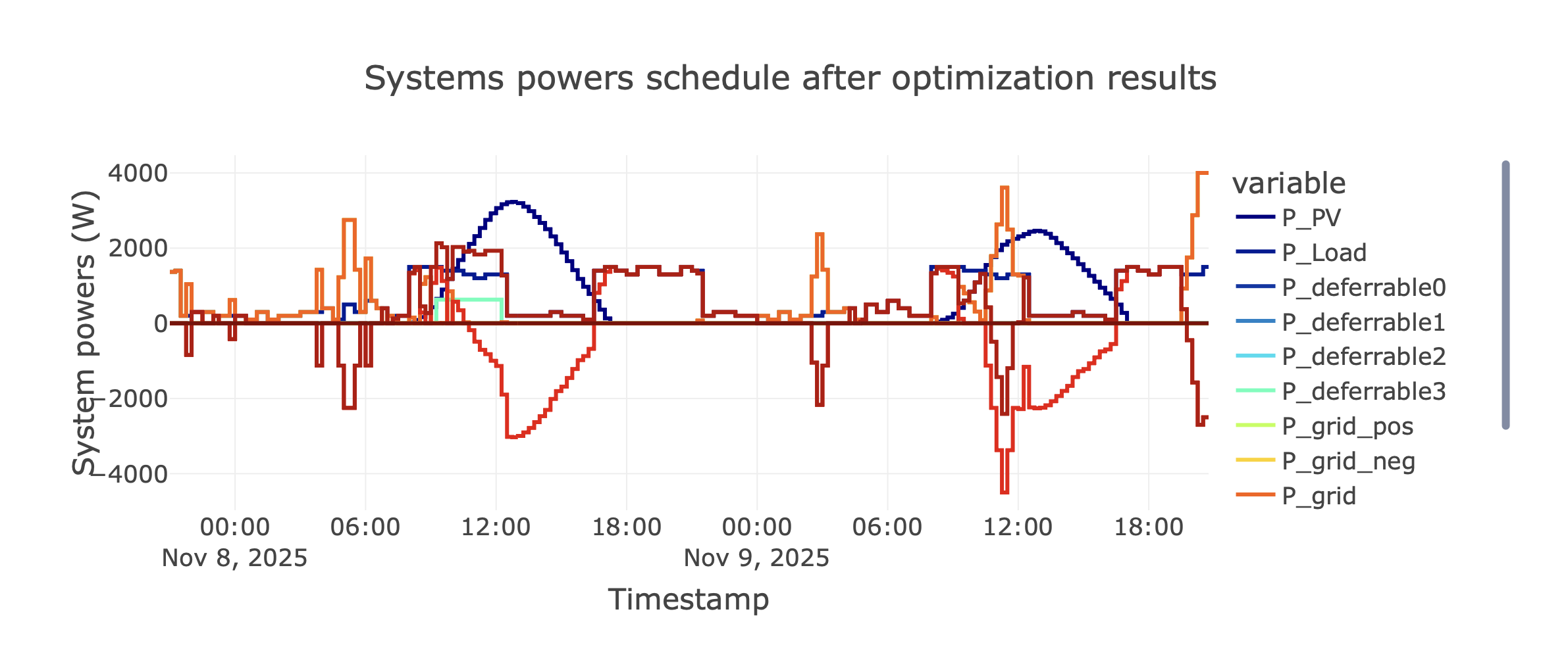

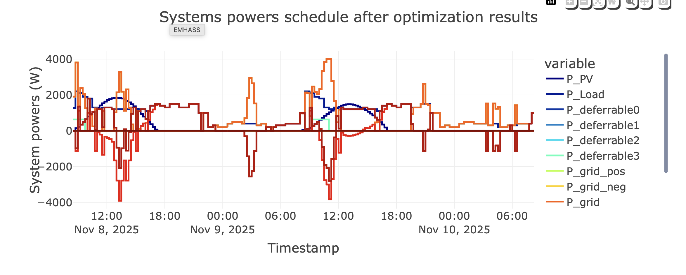

Last night I tried a 48h prediction window, intially It looked good:
But at night EMHASS decided to start the heatpompboiler:
Deferrable:
So many starts, however I fixed one run at least to be 15 min, internal logics don’t comply with EMHASS planning (See energy usage above)
New planning after the night:
Will incorporate your graphs as well @markpurcell
