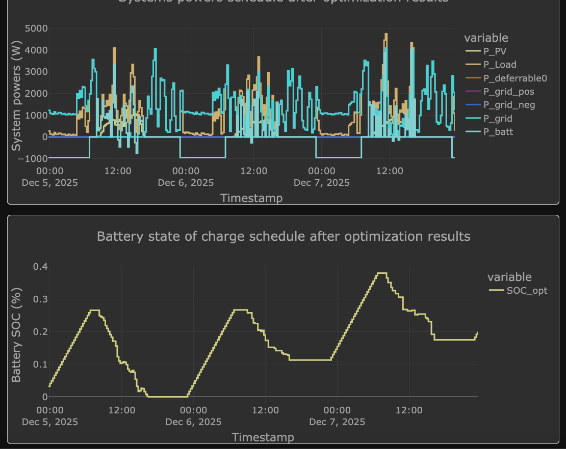

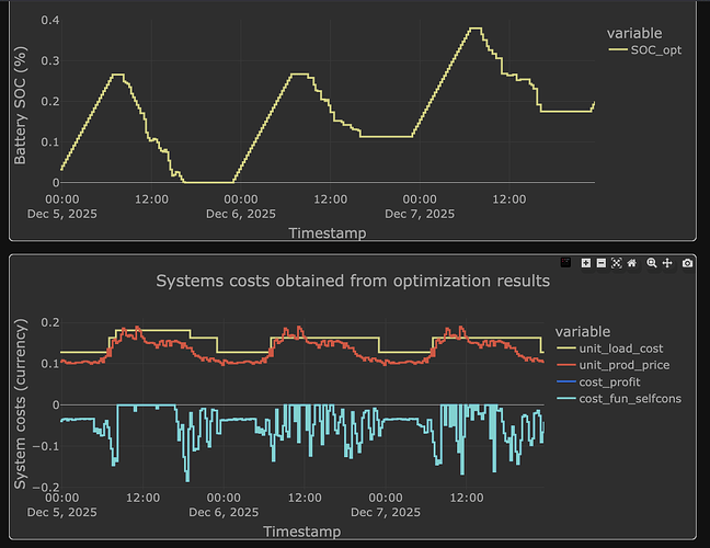

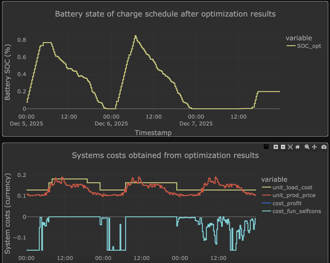

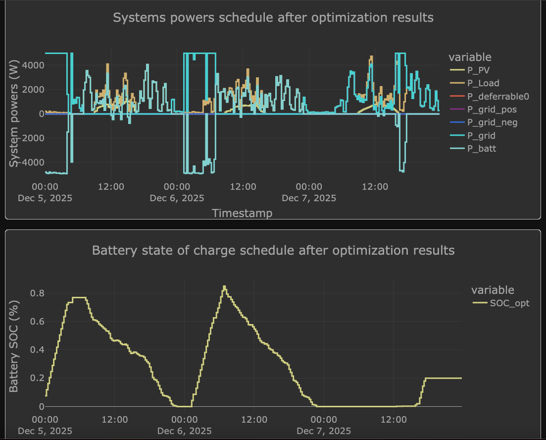

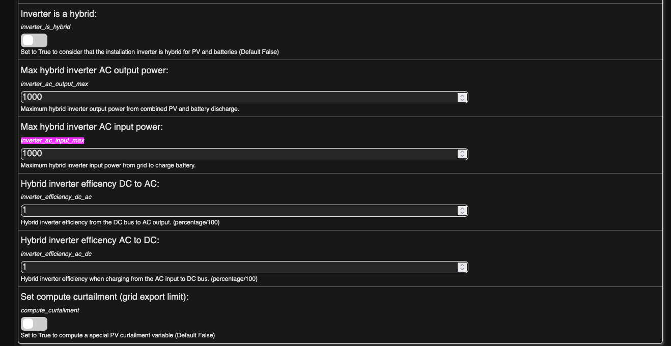

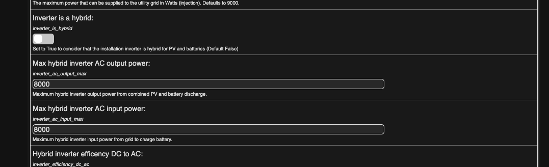

@davidusb I think there is something that doesn’t make sense following the update to 0.14.1
I’m seeing this, which doesn’t make sense as I’m buying electricity from grid instead of charging at night / postponing to the lowest tariff when the price is not the least.

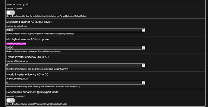

Also, despite of my setup, it seems the maximum charge power is 1kW.

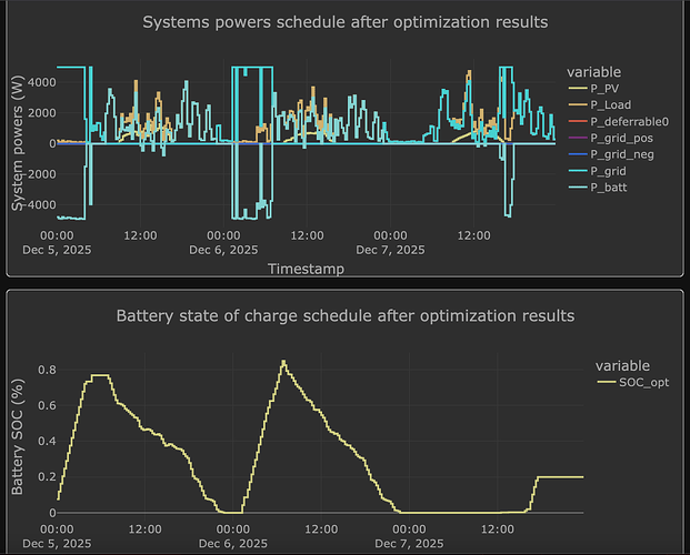

So I tried to roll back to v.0.14.0 and the results of the elaboration, performed with just a few minutes later, are completely different and this time make much more sense to me.
Indeed I’m charging my battery at higher rate and I follow the tariffs, and I only buy electricity during off-peak hours.
I also upload the tables with the results:
v.0.14.0
index P_PV P_Load P_deferrable0 P_grid_pos P_grid_neg P_grid P_batt SOC_opt unit_load_cost unit_prod_price cost_profit cost_fun_selfcons

I have a Growatt inverter controlling my batteries. The inverter is connected to Home Assistant using the SolaX Modbus integration. I don’t understand how I should control the batteries based on what EMHASS publish.
Someone who can share how you do?

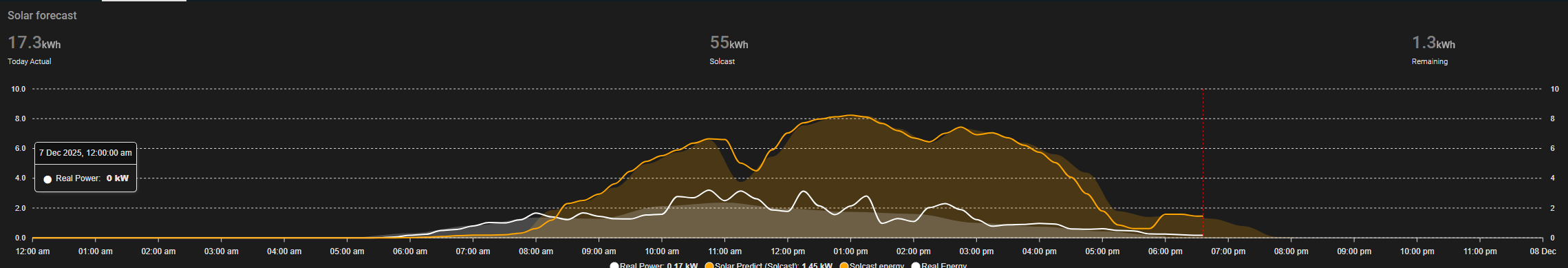

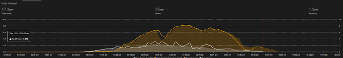

Anyone else get days like this from solcast? makes an utter mess of the forecasting. Currently using the bjreplay solcast integration
Emhass publishes p_batt_forecast & soc_batt_forecast. These will tell you what to do p_batt_forecast is the power (W), 0 = do nothing, positive = charge, negative = discharge (might be other way around). The SOC parameter tells you the target percentage the battery should (dis)charge to. E.g. if your current SOC is 20% and this value is 40%, it means you should charge to 40%. How to control that with your Growatt inverter I don’t know, but most likely you can use the modbus integration to tell it to go to the requested SOC or powers.
Change inverter_ac_input_max from 1000 to something else.
I do understand what I get from EMHASS. My problem is how I control the batteries.
Are there anyone using Growatt inverter/batteries together with EMHASS?
Thank you, the fact is that I do not owe a hybrid inverter.
Below my set-up from v.0.14.0
So is this going to be used for ANY inverter? Is this behaviour expected?
