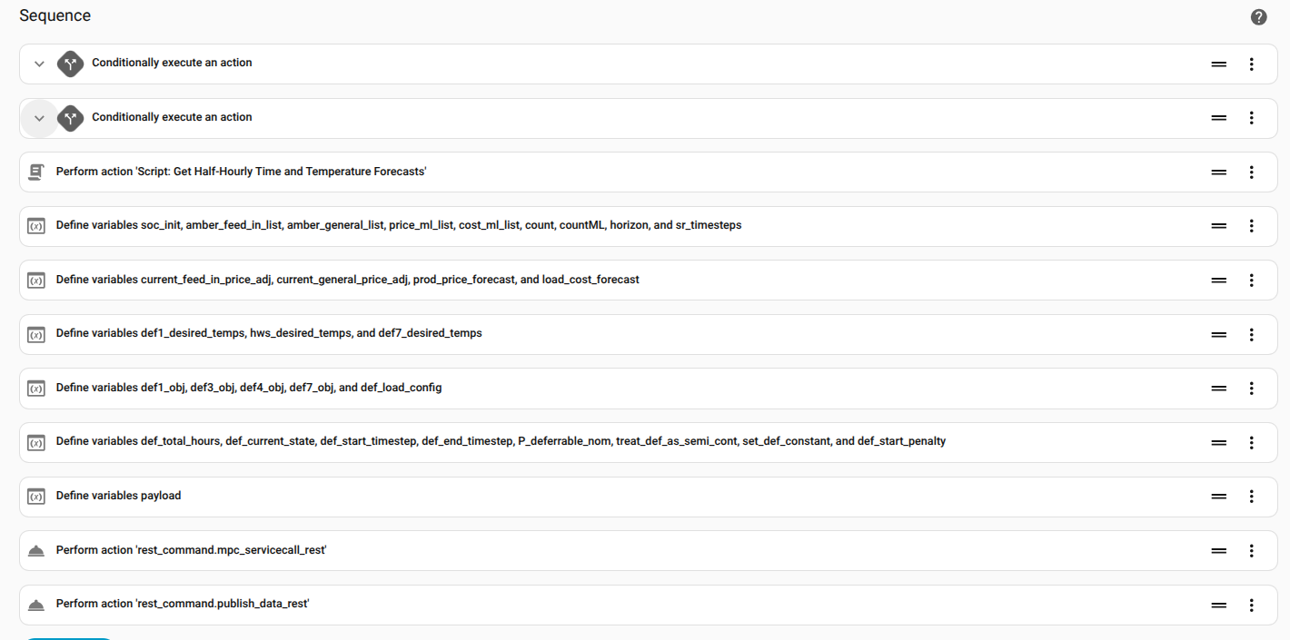

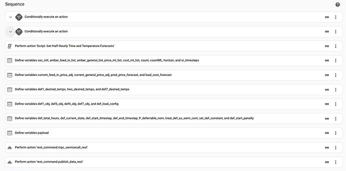

I know my payload is getting way out of control and very difficult to manage, I’m wondering what others are doing to modularize their payloads?

Unfortunately I have no answer to your question. I was also playing around with variables, but no passing the whole payload just the variables, which resulted in some issues that does variables are not correctly handled in the call.
How do you test your payload, when adjusting it?
Currently I work in the file editor and test my payload in the template editor.

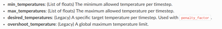

One small remark, as far as I know, passed “def_total_hours” for thermal loads are ignored.
Ha,ha!! YES you are so right, and the most obvious is the hardest i guess. And you also did beat the ChatGPT even though prompted to “read the docs” and “look at commands and actions”… Thnx a million David!

The curl command showed me the way. Trying to connect to “localhost” gave me a “failed to connect”. Changing “localhost” to ‘internal IP adres’ did the trick and gives me a working connection from Emhass to Influxdb.
store all the variables in templates.yaml as sensors and then collate in a rest command. trigger rest command in automation that updates when the amber2mqtt 5 minute price updates.
storing in templates.yaml means the config for each variable is accessible in file editor / vscode which i find easier to read than the templating box in an automation

No overshoot_temperature necessary anymore? It says ‘Legacy’ in the documentation. But desired_temperatures you would stil need?
I think the intention is to replace overshoot and desired with min and max.

The new code is an improvement of the previous model.
This might need some explanation and I will probably update the confusing “Legacy” term in the docs.
The new code adds min and max constraints but does not remove the old desired logic. They work differently:
  • min / max: These are new hard constraints. The solver must stay within these bounds. If the starting temperature (e.g., 28°C) is outside these bounds (e.g., Max 25°C), the solver correctly declares the problem “Infeasible” because it is mathematically impossible to satisfy the constraint at Time=0.
  • desired: This acts as a soft target. It adds a “penalty” cost to the objective function
So desired_temperatures are definitely still needed.
Also you must also keep the same overshoot_temperature as in your previous config.
In the code the logic that applies the desired temperature penalty is currently wrapped inside a check for overshoot_temperature:
# In optimization.py
if desired_temperatures and overshoot_temperature is not None:
    # ... logic that calculates penalty cost based on difference from desired temperature ...
But your point is right @markpurcell with your max values.
To handle cases where your home starts hotter than your target, set your max_temperature to a safety limit (e.g., 30°C) to avoid “Infeasible” errors. Then, keep desired_temperatures at your preferred setpoint (25°C) AND be sure that overshoot_temperature is defined in your config. This activates the penalty logic, forcing the solver to cool the house down from 30°C to 25°C as quickly as economically possible
