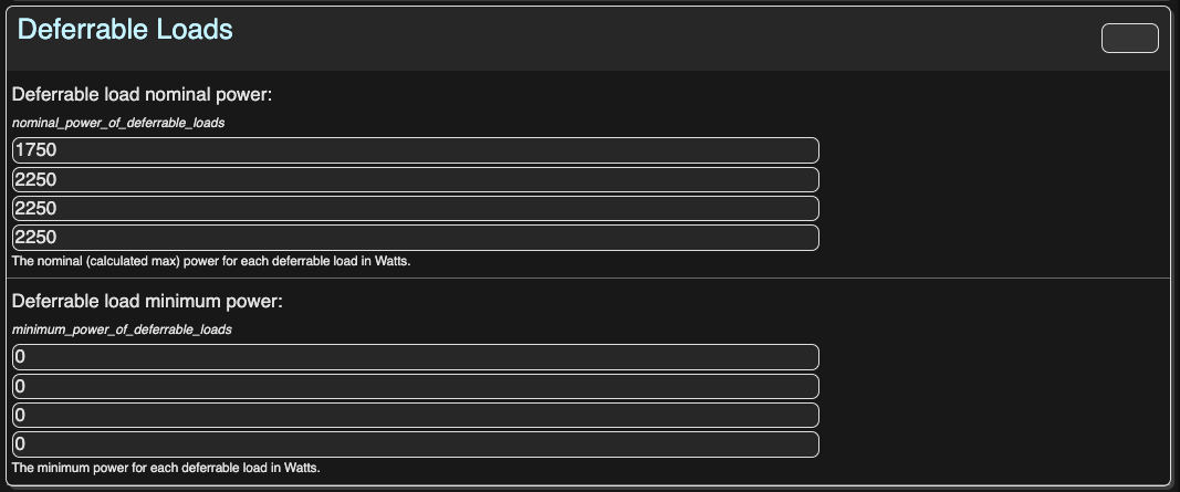

Basically all def_loads are zero.
Here’s my config:
  "adjusted_pv_model_max_age": 24,
  "adjusted_pv_regression_model": "LassoRegression",
  "adjusted_pv_solar_elevation_threshold": 10,
  "battery_charge_efficiency": 0.95,
  "battery_charge_power_max": 1000,
  "battery_discharge_efficiency": 0.95,
  "battery_discharge_power_max": 1000,
  "battery_dynamic_max": 0.9,
  "battery_dynamic_min": -0.9,
  "battery_maximum_state_of_charge": 0.9,
  "battery_minimum_state_of_charge": 0.3,
  "battery_nominal_energy_capacity": 5000,
  "battery_stress_cost": 0,
  "battery_stress_segments": 10,
  "battery_target_state_of_charge": 0.6,
  "compute_curtailment": false,
  "continual_publish": false,
  "costfun": "self-consumption",
  "delta_forecast_daily": 1,
  "end_timesteps_of_each_deferrable_load": [
    0,
    28,
    64,
    0
  "historic_days_to_retrieve": 2,
  "influxdb_database": "homeassistant",
  "influxdb_host": "192.168.178.149",
  "influxdb_measurement": "W",
  "influxdb_password": "influx-db-user",
  "influxdb_port": 8086,
  "influxdb_retention_policy": "autogen",
  "influxdb_use_ssl": false,
  "influxdb_username": "influx-db-user",
  "influxdb_verify_ssl": false,
  "inverter_ac_input_max": 1000,
  "inverter_ac_output_max": 1000,
  "inverter_efficiency_ac_dc": 1,
  "inverter_efficiency_dc_ac": 1,
  "inverter_is_hybrid": false,
  "inverter_stress_cost": 0,
  "inverter_stress_segments": 10,
  "load_cost_forecast_method": "hp_hc_periods",
  "load_forecast_method": "naive",
  "load_negative": false,
  "load_offpeak_hours_cost": 0.1419,
  "load_peak_hour_periods": {
    "period_hp_1": [
        "start": "08:00"
        "end": "12:00"
    "period_hp_2": [
        "start": "15:00"
        "end": "18:00"
  "load_peak_hours_cost": 0.1907,
  "logging_level": "DEBUG",
  "lp_solver": "default",
  "lp_solver_path": "empty",
  "lp_solver_timeout": 45,
  "maximum_power_from_grid": 9000,
  "maximum_power_to_grid": 9000,
  "method_ts_round": "first",
  "minimum_power_of_deferrable_loads": [
    0,
    0,
    0,
    0
  "model_type": "load_forecast",
  "modules_per_string": [
    12,
    11,
    12
  "nominal_power_of_deferrable_loads": [
    1750,
    2250,
    2250,
    2250
  "num_lags": 48,
  "num_threads": 0,
  "number_of_deferrable_loads": 4,
  "open_meteo_cache_max_age": 30,
  "operating_hours_of_each_deferrable_load": [
    0,
    0,
    0,
    0
  "optimization_time_step": 15,
  "perform_backtest": false,
  "photovoltaic_production_sell_price": 0.07553,
  "production_price_forecast_method": "constant",
  "pv_inverter_model": [
    "Fronius_International_GmbH__Fronius_Primo_10_0_1_208_240__240V_",
  "pv_module_model": [
    "Trina_Solar_TSM_465DEG15VC_20_II_",
  "sensor_linear_interp": [
    "sensor.power_photovoltaics"
  "sensor_power_load_no_var_loads": "sensor.power_load_no_var_loads",
  "sensor_power_photovoltaics": "sensor.pv_inverter_watts",
  "sensor_power_photovoltaics_forecast": "sensor.p_pv_forecast",
  "sensor_replace_zero": [
  "set_battery_dynamic": false,
  "set_deferrable_load_single_constant": [
    false,
    false,
    false,
    false
  "set_deferrable_startup_penalty": [
    400,
    250,
    250,
    250
  "set_nocharge_from_grid": false,
  "set_nodischarge_to_grid": true,
  "set_total_pv_sell": false,
  "set_use_adjusted_pv": false,
  "set_use_battery": false,
  "set_use_pv": true,
  "set_zero_min": true,
  "sklearn_model": "KNeighborsRegressor",
  "split_date_delta": "48h",
  "start_timesteps_of_each_deferrable_load": [
    0,
    0,
    56,
    86
  "strings_per_inverter": [
    1,
    1,
    1
  "surface_azimuth": [
    85,
    175,
    265
  "surface_tilt": [
    21,
    21,
    21
  "treat_deferrable_load_as_semi_cont": [
    true,
    true,
    true,
    true
  "use_influxdb": true,
  "use_websocket": false,
  "var_model": "sensor.power_load_no_var_loads",
  "weather_forecast_method": "open-meteo",
  "weight_battery_charge": 0,
  "weight_battery_discharge": 0
Here’s the log:

In the meantime I was exactly looking at operating_hours_of_each_deferrable_load. I erased all the 0…now I’m unable to view the config as code in the UI…just no reaction.
And the operating_hours_of_each_deferrable_load is not visible anymore :grimacing:
Can you share the debug logs. These should include the information, if the thermal battery load is correctly detected.
Thanks for your help. I will post them.
But first I need to get my UI working again. It seems that I can’t make any changes there anymore. It’s just not reacting to any changes. So, no save possible, deferrable loads settings are incomplete.
I would like to get into the ā€œcode-modeā€
to set the 0’s again for ā€˜operating_hours_of_each_deferrable_load’ but that’s also not possible. I kind of crashed the configuration page.
[2026-01-14 07:40:00,481] DEBUG in optimization: Initialized Optimization with retrieve_hass_conf: {'optimization_time_step': Timedelta('0 days 00:15:00'), 'historic_days_to_retrieve': 2, 'sensor_power_photovoltaics': 'sensor.pv_inverter_watts', 'sensor_power_photovoltaics_forecast': 'sensor.p_pv_forecast', 'sensor_power_load_no_var_loads': 'sensor.power_load_no_var_loads', 'load_negative': False, 'set_zero_min': True, 'sensor_replace_zero': ['sensor.power_photovoltaics'], 'sensor_linear_interp': ['sensor.power_photovoltaics'], 'use_influxdb': True, 'influxdb_host': '192.168.178.149', 'influxdb_port': 8086, 'influxdb_username': 'influx-db-user', 'influxdb_password': 'influx-db-user', 'influxdb_database': 'homeassistant', 'influxdb_measurement': 'W', 'influxdb_retention_policy': 'autogen', 'influxdb_use_ssl': False, 'influxdb_verify_ssl': False, 'method_ts_round': 'first', 'continual_publish': False, 'use_websocket': False, 'hass_url': 'http://supervisor/core/api', 'long_lived_token': '0e270787fc67c3cec2f9250a067c981a6c0ecd49115c102232745a8119cd14e76677e00d4a3074386cf82d5706b06f0e8ae7a6d669fbf58d', 'time_zone': <DstTzInfo 'Europe/Berlin' LMT+0:53:00 STD>, 'Latitude': 50.64753866400673, 'Longitude': 7.933228611946107, 'Altitude': 525}
[2026-01-14 07:40:00,482] DEBUG in optimization: Optimization configuration: {'costfun': 'self-consumption', 'logging_level': 'DEBUG', 'set_use_pv': True, 'set_use_adjusted_pv': False, 'adjusted_pv_regression_model': 'LassoRegression', 'adjusted_pv_solar_elevation_threshold': 10, 'adjusted_pv_model_max_age': 24, 'set_use_battery': False, 'number_of_deferrable_loads': 4, 'nominal_power_of_deferrable_loads': [1750, 2250, 2250, 2250], 'minimum_power_of_deferrable_loads': [0, 0, 0, 0], 'operating_hours_of_each_deferrable_load': [None, None, None, None], 'treat_deferrable_load_as_semi_cont': [True, True, True, True], 'set_deferrable_load_single_constant': [False, False, False, False], 'set_deferrable_startup_penalty': [400, 250, 250, 250], 'delta_forecast_daily': Timedelta('1 days 00:00:00'), 'load_forecast_method': 'naive', 'load_cost_forecast_method': 'hp_hc_periods', 'load_peak_hours_cost': 0.1907, 'load_offpeak_hours_cost': 0.1419, 'production_price_forecast_method': 'constant', 'photovoltaic_production_sell_price': 0.07553, 'set_total_pv_sell': False, 'lp_solver': 'default', 'lp_solver_path': 'empty', 'lp_solver_timeout': 45, 'num_threads': 0, 'set_nocharge_from_grid': False, 'set_nodischarge_to_grid': True, 'set_battery_dynamic': False, 'battery_dynamic_max': 0.9, 'battery_dynamic_min': -0.9, 'weight_battery_discharge': 0.0, 'weight_battery_charge': 0.0, 'weather_forecast_method': 'open-meteo', 'open_meteo_cache_max_age': 30, 'start_timesteps_of_each_deferrable_load': [0, 0, 56, 86], 'end_timesteps_of_each_deferrable_load': [0, 28, 64, 0], 'load_peak_hour_periods': {'period_hp_1': [{'start': '08:00'}, {'end': '12:00'}], 'period_hp_2': [{'start': '15:00'}, {'end': '18:00'}]}, 'model_type': 'load_forecast', 'var_model': 'sensor.power_load_no_var_loads', 'sklearn_model': 'KNeighborsRegressor', 'num_lags': 48, 'split_date_delta': '48h', 'perform_backtest': False}
[2026-01-14 07:40:00,482] DEBUG in optimization: Plant configuration: {'maximum_power_from_grid': 9000, 'maximum_power_to_grid': 9000, 'pv_module_model': ['Trina_Solar_TSM_465DEG15VC_20_II_', 'Trina_Solar_TSM_465DEG15VC_20_II_', 'Trina_Solar_TSM_465DEG15VC_20_II_'], 'pv_inverter_model': ['Fronius_International_GmbH__Fronius_Primo_10_0_1_208_240__240V_', 'Fronius_International_GmbH__Fronius_Primo_10_0_1_208_240__240V_', 'Fronius_International_GmbH__Fronius_Primo_10_0_1_208_240__240V_'], 'surface_tilt': [21, 21, 21], 'surface_azimuth': [85, 175, 265], 'modules_per_string': [12, 11, 12], 'strings_per_inverter': [1, 1, 1], 'inverter_is_hybrid': False, 'inverter_ac_output_max': 1000, 'inverter_ac_input_max': 1000, 'inverter_efficiency_dc_ac': 1, 'inverter_efficiency_ac_dc': 1, 'inverter_stress_cost': 0, 'inverter_stress_segments': 10, 'compute_curtailment': False, 'battery_discharge_power_max': 1000, 'battery_charge_power_max': 1000, 'battery_discharge_efficiency': 0.95, 'battery_charge_efficiency': 0.95, 'battery_nominal_energy_capacity': 5000, 'battery_minimum_state_of_charge': 0.3, 'battery_maximum_state_of_charge': 0.9, 'battery_target_state_of_charge': 0.6, 'battery_stress_cost': 0.0, 'battery_stress_segments': 10}
please see → 'operating_hours_of_each_deferrable_load': [None, None, None, None]
There must be some way to change that again…
