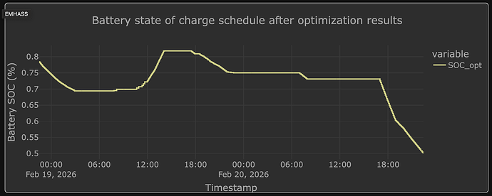

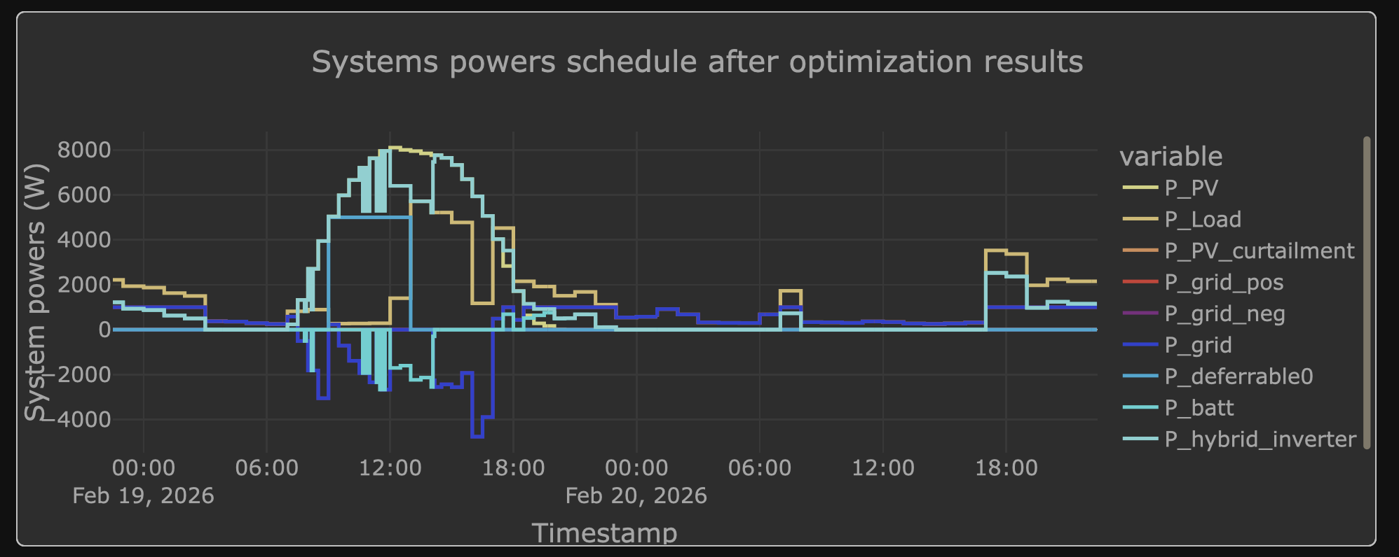

Hi Mark, I have seen some of you posts on here showing the dashboards and energy management automation that you have set up which are all very impressive. I am just starting off with HA and Amber. I have 10 KW, 50 KWh battery, solar and EV. I would like to optimise the charging and discharging of the battery to the grid based on the energy prices from Amber and AEMO forecasts. Would you be able to share some of the codes for the dashboards you have set up for you automations and how you have set up EMHASS to work with Amber and AEMO pricing. Anything you can share to help me get started would be much appreciated :slightly_smiling_face:
I’ve just started so my configuration may be seriously wrong, but it appears to have generated the result that seemingly reasonable/logical. However, the MPC will only run when maximum_power_from_grid is NOT 0 and must have at least 1000W. Otherwise I got the “infeasible” error and I have no idea what or where went wrong. @davidusb, really keen if you can help or assist in validating if there is anything wrong with my config or point me the in right direction to resolve this.
'costfun': 'profit',
'prediction_horizon': 576,
'optimization_time_step': 5,
'delta_forecast_daily': 2,
'set_use_pv': True,
'set_use_battery': True,
'inverter_is_hybrid': True,
'number_of_deferrable_loads': 1,
'set_nodischarge_to_grid': False,
'logging_level': 'debug',
'lp_solver_timeout': 45,
'compute_curtailment': True,
'nominal_power_of_deferrable_loads': [5000],
'operating_hours_of_each_deferrable_load': [4],
'start_timesteps_of_each_deferrable_load': [-148],
'end_timesteps_of_each_deferrable_load': [-28],
'treat_deferrable_load_as_semi_cont': [False],
'set_deferrable_load_single_constant': [True]
'weight_battery_charge': 0.1,
'weight_battery_discharge': 0.1,
'battery_minimum_state_of_charge': 0.5,
'battery_nominal_energy_capacity': 40300,
'battery_charge_power_max': 21000,
'battery_discharge_power_max': 24000,
'maximum_power_from_grid': **1000,**
'maximum_power_to_grid': 5000,
'inverter_ac_output_max': 9999,
'inverter_ac_input_max': 9999,
'soc_init': 0.796,
'soc_final': 0.5,
'load_cost_forecast': {'2026-02-18T00:00:00+11:00': 0.2001, '2026-02-18T00:05:00+11:00': 0.2001, '2026-02-18T00:10:00+11:00': 0.2001, '2026-02-18T00:15:00+11:00': 0.2001, '2026-02-18T00:20:00+11:00': 0.2001, '2026-02-18T00:25:00+11:00': 0.2001, '2026-02-18T00:30:00+11:00': 0.2001, '2026-02-18T00:35:00+11:00': 0.2001, '2026-02-18T00:40:00+11:00': 0.2001, '2026-02-18T00:45:00+11:00': 0.2001, '2026-02-18T00:50:00+11:00': 0.2001, '2026-02-18T00:55:00+11:00': 0.2001, '2026-02-18T01:00:00+11:00': 0.2001, '2026-02-18T01:05:00+11:00': 0.2001, '2026-02-18T01:10:00+11:00': 0.2001, '2026-02-18T01:15:00+11:00': 0.2001, '2026-02-18T01:20:00+11:00': 0.2001, '2026-02-18T01:25:00+11:00': 0.2001, '2026-02-18T01:30:00+11:00': 0.2001, '2026-02-18T01:35:00+11:00': 0.2001, '2026-02-18T01:40:00+11:00': 0.2001, '2026-02-18T01:45:00+11:00': 0.2001, '2026-02-18T01:50:00+11:00': 0.2001, '2026-02-18T01:55:00+11:00': 0.2001, '2026-02-18T02:00:00+11:00': 0.2001, '2026-02-18T02:05:00+11:00': 0.2001, '2026-02-18T02:10:00+11:00': 0.2001, '2026-02-18T02:15:00+11:00': 0.2001, '2026-02-18T02:20:00+11:00': 0.2001, '2026-02-18T02:25:00+11:00': 0.2001, '2026-02-18T02:30:00+11:00': 0.2001, '2026-02-18T02:35:00+11:00': 0.2001, '2026-02-18T02:40:00+11:00': 0.2001, '2026-02-18T02:45:00+11:00': 0.2001, '2026-02-18T02:50:00+11:00': 0.2001, '2026-02-18T02:55:00+11:00': 0.2001, '2026-02-18T03:00:00+11:00': 0.2001, '2026-02-18T03:05:00+11:00': 0.2001, '2026-02-18T03:10:00+11:00': 0.2001, '2026-02-18T03:15:00+11:00': 0.2001, '2026-02-18T03:20:00+11:00': 0.2001, '2026-02-18T03:25:00+11:00': 0.2001, '2026-02-18T03:30:00+11:00': 0.2001, '2026-02-18T03:35:00+11:00': 0.2001, '2026-02-18T03:40:00+11:00': 0.2001, '2026-02-18T03:45:00+11:00': 0.2001, '2026-02-18T03:50:00+11:00': 0.2001, '2026-02-18T03:55:00+11:00': 0.2001, '2026-02-18T04:00:00+11:00': 0.2001, '2026-02-18T04:05:00+11:00': 0.2001, '2026-02-18T04:10:00+11:00': 0.2001, '2026-02-18T04:15:00+11:00': 0.2001, '2026-02-18T04:20:00+11:00': 0.2001, '2026-02-18T04:25:00+11:00': 0.2001, '2026-02-18T04:30:00+11:00': 0.2001, '2026-02-18T04:35:00+11:00': 0.2001, '2026-02-18T04:40:00+11:00': 0.2001, '2026-02-18T04:45:00+11:00': 0.2001, '2026-02-18T04:50:00+11:00': 0.2001, '2026-02-18T04:55:00+11:00': 0.2001, '2026-02-18T05:00:00+11:00': 0.2001, '2026-02-18T05:05:00+11:00': 0.2001, '2026-02-18T05:10:00+11:00': 0.2001, '2026-02-18T05:15:00+11:00': 0.2001, '2026-02-18T05:20:00+11:00': 0.2001, '2026-02-18T05:25:00+11:00': 0.2001, '2026-02-18T05:30:00+11:00': 0.2001, '2026-02-18T05:35:00+11:00': 0.2001, '2026-02-18T05:40:00+11:00': 0.2001, '2026-02-18T05:45:00+11:00': 0.2001, '2026-02-18T05:50:00+11:00': 0.2001, '2026-02-18T05:55:00+11:00': 0.2001, '2026-02-18T06:00:00+11:00': 0.3001, '2026-02-18T06:05:00+11:00': 0.3001, '2026-02-18T06:10:00+11:00': 0.3001, '2026-02-18T06:15:00+11:00': 0.3001, '2026-02-18T06:20:00+11:00': 0.3001, '2026-02-18T06:25:00+11:00': 0.3001, '2026-02-18T06:30:00+11:00': 0.3001, '2026-02-18T06:35:00+11:00': 0.3001, '2026-02-18T06:40:00+11:00': 0.3001, '2026-02-18T06:45:00+11:00': 0.3001, '2026-02-18T06:50:00+11:00': 0.3001, '2026-02-18T06:55:00+11:00': 0.3001, '2026-02-18T07:00:00+11:00': 0.3001, '2026-02-18T07:05:00+11:00': 0.3001, '2026-02-18T07:10:00+11:00': 0.3001, '2026-02-18T07:15:00+11:00': 0.3001, '2026-02-18T07:20:00+11:00': 0.3001, '2026-02-18T07:25:00+11:00': 0.3001, '2026-02-18T07:30:00+11:00': 0.3001, '2026-02-18T07:35:00+11:00': 0.3001, '2026-02-18T07:40:00+11:00': 0.3001, '2026-02-18T07:45:00+11:00': 0.3001, '2026-02-18T07:50:00+11:00': 0.3001, '2026-02-18T07:55:00+11:00': 0.3001, '2026-02-18T08:00:00+11:00': 0.3001, '2026-02-18T08:05:00+11:00': 0.3001, '2026-02-18T08:10:00+11:00': 0.3001, '2026-02-18T08:15:00+11:00': 0.3001, '2026-02-18T08:20:00+11:00': 0.3001, '2026-02-18T08:25:00+11:00': 0.3001, '2026-02-18T08:30:00+11:00': 0.3001, '2026-02-18T08:35:00+11:00': 0.3001, '2026-02-18T08:40:00+11:00': 0.3001, '2026-02-18T08:45:00+11:00': 0.3001, '2026-02-18T08:50:00+11:00': 0.3001, '2026-02-18T08:55:00+11:00': 0.3001, '2026-02-18T09:00:00+11:00': 0.3001, '2026-02-18T09:05:00+11:00': 0.3001, '2026-02-18T09:10:00+11:00': 0.3001, '2026-02-18T09:15:00+11:00': 0.3001, '2026-02-18T09:20:00+11:00': 0.3001, '2026-02-18T09:25:00+11:00': 0.3001, '2026-02-18T09:30:00+11:00': 0.3001, '2026-02-18T09:35:00+11:00': 0.3001, '2026-02-18T09:40:00+11:00': 0.3001, '2026-02-18T09:45:00+11:00': 0.3001, '2026-02-18T09:50:00+11:00': 0.3001, '2026-02-18T09:55:00+11:00': 0.3001, '2026-02-18T10:00:00+11:00': 0.3001, '2026-02-18T10:05:00+11:00': 0.3001, '2026-02-18T10:10:00+11:00': 0.3001, '2026-02-18T10:15:00+11:00': 0.3001, '2026-02-18T10:20:00+11:00': 0.3001, '2026-02-18T10:25:00+11:00': 0.3001, '2026-02-18T10:30:00+11:00': 0.3001, '2026-02-18T10:35:00+11:00': 0.3001, '2026-02-18T10:40:00+11:00': 0.3001, '2026-02-18T10:45:00+11:00': 0.3001, '2026-02-18T10:50:00+11:00': 0.3001, '2026-02-18T10:55:00+11:00': 0.3001, '2026-02-18T11:00:00+11:00': 0.3001, '2026-02-18T11:05:00+11:00': 0.3001, '2026-02-18T11:10:00+11:00': 0.3001, '2026-02-18T11:15:00+11:00': 0.3001, '2026-02-18T11:20:00+11:00': 0.3001, '2026-02-18T11:25:00+11:00': 0.3001, '2026-02-18T11:30:00+11:00': 0.3001, '2026-02-18T11:35:00+11:00': 0.3001, '2026-02-18T11:40:00+11:00': 0.3001, '2026-02-18T11:45:00+11:00': 0.3001, '2026-02-18T11:50:00+11:00': 0.3001, '2026-02-18T11:55:00+11:00': 0.3001, '2026-02-18T12:00:00+11:00': 0.3001, '2026-02-18T12:05:00+11:00': 0.3001, '2026-02-18T12:10:00+11:00': 0.3001, '2026-02-18T12:15:00+11:00': 0.3001, '2026-02-18T12:20:00+11:00': 0.3001, '2026-02-18T12:25:00+11:00': 0.3001, '2026-02-18T12:30:00+11:00': 0.3001, '2026-02-18T12:35:00+11:00': 0.3001, '2026-02-18T12:40:00+11:00': 0.3001, '2026-02-18T12:45:00+11:00': 0.3001, '2026-02-18T12:50:00+11:00': 0.3001, '2026-02-18T12:55:00+11:00': 0.3001, '2026-02-18T13:00:00+11:00': 0.3001, '2026-02-18T13:05:00+11:00': 0.3001, '2026-02-18T13:10:00+11:00': 0.3001, '2026-02-18T13:15:00+11:00': 0.3001, '2026-02-18T13:20:00+11:00': 0.3001, '2026-02-18T13:25:00+11:00': 0.3001, '2026-02-18T13:30:00+11:00': 0.3001, '2026-02-18T13:35:00+11:00': 0.3001, '2026-02-18T13:40:00+11:00': 0.3001, '2026-02-18T13:45:00+11:00': 0.3001, '2026-02-18T13:50:00+11:00': 0.3001, '2026-02-18T13:55:00+11:00': 0.3001, '2026-02-18T14:00:00+11:00': 0.3001, '2026-02-18T14:05:00+11:00': 0.3001, '2026-02-18T14:10:00+11:00': 0.3001, '2026-02-18T14:15:00+11:00': 0.3001, '2026-02-18T14:20:00+11:00': 0.3001, '2026-02-18T14:25:00+11:00': 0.3001, '2026-02-18T14:30:00+11:00': 0.3001, '2026-02-18T14:35:00+11:00': 0.3001, '2026-02-18T14:40:00+11:00': 0.3001, '2026-02-18T14:45:00+11:00': 0.3001, '2026-02-18T14:50:00+11:00': 0.3001, '2026-02-18T14:55:00+11:00': 0.3001, '2026-02-18T15:00:00+11:00': 0.3001, '2026-02-18T15:05:00+11:00': 0.3001, '2026-02-18T15:10:00+11:00': 0.3001, '2026-02-18T15:15:00+11:00': 0.3001, '2026-02-18T15:20:00+11:00': 0.3001, '2026-02-18T15:25:00+11:00': 0.3001, '2026-02-18T15:30:00+11:00': 0.3001, '2026-02-18T15:35:00+11:00': 0.3001, '2026-02-18T15:40:00+11:00': 0.3001, '2026-02-18T15:45:00+11:00': 0.3001, '2026-02-18T15:50:00+11:00': 0.3001, '2026-02-18T15:55:00+11:00': 0.3001, '2026-02-18T16:00:00+11:00': 0.3001, '2026-02-18T16:05:00+11:00': 0.3001, '2026-02-18T16:10:00+11:00': 0.3001, '2026-02-18T16:15:00+11:00': 0.3001, '2026-02-18T16:20:00+11:00': 0.3001, '2026-02-18T16:25:00+11:00': 0.3001, '2026-02-18T16:30:00+11:00': 0.3001, '2026-02-18T16:35:00+11:00': 0.3001, '2026-02-18T16:40:00+11:00': 0.3001, '2026-02-18T16:45:00+11:00': 0.3001, '2026-02-18T16:50:00+11:00': 0.3001, '2026-02-18T16:55:00+11:00': 0.3001, '2026-02-18T17:00:00+11:00': 0.3001, '2026-02-18T17:05:00+11:00': 0.3001, '2026-02-18T17:10:00+11:00': 0.3001, '2026-02-18T17:15:00+11:00': 0.3001, '2026-02-18T17:20:00+11:00': 0.3001, '2026-02-18T17:25:00+11:00': 0.3001, '2026-02-18T17:30:00+11:00': 0.3001, '2026-02-18T17:35:00+11:00': 0.3001, '2026-02-18T17:40:00+11:00': 0.3001, '2026-02-18T17:45:00+11:00': 0.3001, '2026-02-18T17:50:00+11:00': 0.3001, '2026-02-18T17:55:00+11:00': 0.3001, '2026-02-18T18:00:00+11:00': 0.3001, '2026-02-18T18:05:00+11:00': 0.3001, '2026-02-18T18:10:00+11:00': 0.3001, '2026-02-18T18:15:00+11:00': 0.3001, '2026-02-18T18:20:00+11:00': 0.3001, '2026-02-18T18:25:00+11:00': 0.3001, '2026-02-18T18:30:00+11:00': 0.3001, '2026-02-18T18:35:00+11:00': 0.3001, '2026-02-18T18:40:00+11:00': 0.3001, '2026-02-18T18:45:00+11:00': 0.3001, '2026-02-18T18:50:00+11:00': 0.3001, '2026-02-18T18:55:00+11:00': 0.3001, '2026-02-18T19:00:00+11:00': 0.3001, '2026-02-18T19:05:00+11:00': 0.3001, '2026-02-18T19:10:00+11:00': 0.3001, '2026-02-18T19:15:00+11:00': 0.3001, '2026-02-18T19:20:00+11:00': 0.3001, '2026-02-18T19:25:00+11:00': 0.3001, '2026-02-18T19:30:00+11:00': 0.3001, '2026-02-18T19:35:00+11:00': 0.3001, '2026-02-18T19:40:00+11:00': 0.3001, '2026-02-18T19:45:00+11:00': 0.3001, '2026-02-18T19:50:00+11:00': 0.3001, '2026-02-18T19:55:00+11:00': 0.3001, '2026-02-18T20:00:00+11:00': 0.3001, '2026-02-18T20:05:00+11:00': 0.3001, '2026-02-18T20:10:00+11:00': 0.3001, '2026-02-18T20:15:00+11:00': 0.3001, '2026-02-18T20:20:00+11:00': 0.3001, '2026-02-18T20:25:00+11:00': 0.3001, '2026-02-18T20:30:00+11:00': 0.3001, '2026-02-18T20:35:00+11:00': 0.3001, '2026-02-18T20:40:00+11:00': 0.3001, '2026-02-18T20:45:00+11:00': 0.3001, '2026-02-18T20:50:00+11:00': 0.3001, '2026-02-18T20:55:00+11:00': 0.3001, '2026-02-18T21:00:00+11:00': 0.3001, '2026-02-18T21:05:00+11:00': 0.3001, '2026-02-18T21:10:00+11:00': 0.3001, '2026-02-18T21:15:00+11:00': 0.3001, '2026-02-18T21:20:00+11:00': 0.3001, '2026-02-18T21:25:00+11:00': 0.3001, '2026-02-18T21:30:00+11:00': 0.3001, '2026-02-18T21:35:00+11:00': 0.3001, '2026-02-18T21:40:00+11:00': 0.3001, '2026-02-18T21:45:00+11:00': 0.3001, '2026-02-18T21:50:00+11:00': 0.3001, '2026-02-18T21:55:00+11:00': 0.3001, '2026-02-18T22:00:00+11:00': 0.3001, '2026-02-18T22:05:00+11:00': 0.3001, '2026-02-18T22:10:00+11:00': 0.3001, '2026-02-18T22:15:00+11:00': 0.3001, '2026-02-18T22:20:00+11:00': 0.3001, '2026-02-18T22:25:00+11:00': 0.3001, '2026-02-18T22:30:00+11:00': 0.3001, '2026-02-18T22:35:00+11:00': 0.3001, '2026-02-18T22:40:00+11:00': 0.3001, '2026-02-18T22:45:00+11:00': 0.3001, '2026-02-18T22:50:00+11:00': 0.3001, '2026-02-18T22:55:00+11:00': 0.3001, '2026-02-18T23:00:00+11:00': 0.3001, '2026-02-18T23:05:00+11:00': 0.3001, '2026-02-18T23:10:00+11:00': 0.3001, '2026-02-18T23:15:00+11:00': 0.3001, '2026-02-18T23:20:00+11:00': 0.3001, '2026-02-18T23:25:00+11:00': 0.3001, '2026-02-18T23:30:00+11:00': 0.3001, '2026-02-18T23:35:00+11:00': 0.3001, '2026-02-18T23:40:00+11:00': 0.3001, '2026-02-18T23:45:00+11:00': 0.3001, '2026-02-18T23:50:00+11:00': 0.3001, '2026-02-18T23:55:00+11:00': 0.3001, '2026-02-19T00:00:00+11:00': 0.2001, '2026-02-19T00:05:00+11:00': 0.2001, '2026-02-19T00:10:00+11:00': 0.2001, '2026-02-19T00:15:00+11:00': 0.2001, '2026-02-19T00:20:00+11:00': 0.2001, '2026-02-19T00:25:00+11:00': 0.2001, '2026-02-19T00:30:00+11:00': 0.2001, '2026-02-19T00:35:00+11:00': 0.2001, '2026-02-19T00:40:00+11:00': 0.2001, '2026-02-19T00:45:00+11:00': 0.2001, '2026-02-19T00:50:00+11:00': 0.2001, '2026-02-19T00:55:00+11:00': 0.2001, '2026-02-19T01:00:00+11:00': 0.2001, '2026-02-19T01:05:00+11:00': 0.2001, '2026-02-19T01:10:00+11:00': 0.2001, '2026-02-19T01:15:00+11:00': 0.2001, '2026-02-19T01:20:00+11:00': 0.2001, '2026-02-19T01:25:00+11:00': 0.2001, '2026-02-19T01:30:00+11:00': 0.2001, '2026-02-19T01:35:00+11:00': 0.2001, '2026-02-19T01:40:00+11:00': 0.2001, '2026-02-19T01:45:00+11:00': 0.2001, '2026-02-19T01:50:00+11:00': 0.2001, '2026-02-19T01:55:00+11:00': 0.2001, '2026-02-19T02:00:00+11:00': 0.2001, '2026-02-19T02:05:00+11:00': 0.2001, '2026-02-19T02:10:00+11:00': 0.2001, '2026-02-19T02:15:00+11:00': 0.2001, '2026-02-19T02:20:00+11:00': 0.2001, '2026-02-19T02:25:00+11:00': 0.2001, '2026-02-19T02:30:00+11:00': 0.2001, '2026-02-19T02:35:00+11:00': 0.2001, '2026-02-19T02:40:00+11:00': 0.2001, '2026-02-19T02:45:00+11:00': 0.2001, '2026-02-19T02:50:00+11:00': 0.2001, '2026-02-19T02:55:00+11:00': 0.2001, '2026-02-19T03:00:00+11:00': 0.2001, '2026-02-19T03:05:00+11:00': 0.2001, '2026-02-19T03:10:00+11:00': 0.2001, '2026-02-19T03:15:00+11:00': 0.2001, '2026-02-19T03:20:00+11:00': 0.2001, '2026-02-19T03:25:00+11:00': 0.2001, '2026-02-19T03:30:00+11:00': 0.2001, '2026-02-19T03:35:00+11:00': 0.2001, '2026-02-19T03:40:00+11:00': 0.2001, '2026-02-19T03:45:00+11:00': 0.2001, '2026-02-19T03:50:00+11:00': 0.2001, '2026-02-19T03:55:00+11:00': 0.2001, '2026-02-19T04:00:00+11:00': 0.2001, '2026-02-19T04:05:00+11:00': 0.2001, '2026-02-19T04:10:00+11:00': 0.2001, '2026-02-19T04:15:00+11:00': 0.2001, '2026-02-19T04:20:00+11:00': 0.2001, '2026-02-19T04:25:00+11:00': 0.2001, '2026-02-19T04:30:00+11:00': 0.2001, '2026-02-19T04:35:00+11:00': 0.2001, '2026-02-19T04:40:00+11:00': 0.2001, '2026-02-19T04:45:00+11:00': 0.2001, '2026-02-19T04:50:00+11:00': 0.2001, '2026-02-19T04:55:00+11:00': 0.2001, '2026-02-19T05:00:00+11:00': 0.2001, '2026-02-19T05:05:00+11:00': 0.2001, '2026-02-19T05:10:00+11:00': 0.2001, '2026-02-19T05:15:00+11:00': 0.2001, '2026-02-19T05:20:00+11:00': 0.2001, '2026-02-19T05:25:00+11:00': 0.2001, '2026-02-19T05:30:00+11:00': 0.2001, '2026-02-19T05:35:00+11:00': 0.2001, '2026-02-19T05:40:00+11:00': 0.2001, '2026-02-19T05:45:00+11:00': 0.2001, '2026-02-19T05:50:00+11:00': 0.2001, '2026-02-19T05:55:00+11:00': 0.2001, '2026-02-19T06:00:00+11:00': 0.3001, '2026-02-19T06:05:00+11:00': 0.3001, '2026-02-19T06:10:00+11:00': 0.3001, '2026-02-19T06:15:00+11:00': 0.3001, '2026-02-19T06:20:00+11:00': 0.3001, '2026-02-19T06:25:00+11:00': 0.3001, '2026-02-19T06:30:00+11:00': 0.3001, '2026-02-19T06:35:00+11:00': 0.3001, '2026-02-19T06:40:00+11:00': 0.3001, '2026-02-19T06:45:00+11:00': 0.3001, '2026-02-19T06:50:00+11:00': 0.3001, '2026-02-19T06:55:00+11:00': 0.3001, '2026-02-19T07:00:00+11:00': 0.3001, '2026-02-19T07:05:00+11:00': 0.3001, '2026-02-19T07:10:00+11:00': 0.3001, '2026-02-19T07:15:00+11:00': 0.3001, '2026-02-19T07:20:00+11:00': 0.3001, '2026-02-19T07:25:00+11:00': 0.3001, '2026-02-19T07:30:00+11:00': 0.3001, '2026-02-19T07:35:00+11:00': 0.3001, '2026-02-19T07:40:00+11:00': 0.3001, '2026-02-19T07:45:00+11:00': 0.3001, '2026-02-19T07:50:00+11:00': 0.3001, '2026-02-19T07:55:00+11:00': 0.3001, '2026-02-19T08:00:00+11:00': 0.3001, '2026-02-19T08:05:00+11:00': 0.3001, '2026-02-19T08:10:00+11:00': 0.3001, '2026-02-19T08:15:00+11:00': 0.3001, '2026-02-19T08:20:00+11:00': 0.3001, '2026-02-19T08:25:00+11:00': 0.3001, '2026-02-19T08:30:00+11:00': 0.3001, '2026-02-19T08:35:00+11:00': 0.3001, '2026-02-19T08:40:00+11:00': 0.3001, '2026-02-19T08:45:00+11:00': 0.3001, '2026-02-19T08:50:00+11:00': 0.3001, '2026-02-19T08:55:00+11:00': 0.3001, '2026-02-19T09:00:00+11:00': 0.3001, '2026-02-19T09:05:00+11:00': 0.3001, '2026-02-19T09:10:00+11:00': 0.3001, '2026-02-19T09:15:00+11:00': 0.3001, '2026-02-19T09:20:00+11:00': 0.3001, '2026-02-19T09:25:00+11:00': 0.3001, '2026-02-19T09:30:00+11:00': 0.3001, '2026-02-19T09:35:00+11:00': 0.3001, '2026-02-19T09:40:00+11:00': 0.3001, '2026-02-19T09:45:00+11:00': 0.3001, '2026-02-19T09:50:00+11:00': 0.3001, '2026-02-19T09:55:00+11:00': 0.3001, '2026-02-19T10:00:00+11:00': 0.3001, '2026-02-19T10:05:00+11:00': 0.3001, '2026-02-19T10:10:00+11:00': 0.3001, '2026-02-19T10:15:00+11:00': 0.3001, '2026-02-19T10:20:00+11:00': 0.3001, '2026-02-19T10
:25:00+11:00': 0.3001, '2026-02-19T10:30:00+11:00': 0.3001, '2026-02-19T10:35:00+11:00': 0.3001, '2026-02-19T10:40:00+11:00': 0.3001, '2026-02-19T10:45:00+11:00': 0.3001, '2026-02-19T10:50:00+11:00': 0.3001, '2026-02-19T10:55:00+11:00': 0.3001, '2026-02-19T11:00:00+11:00': 0.3001, '2026-02-19T11:05:00+11:00': 0.3001, '2026-02-19T11:10:00+11:00': 0.3001, '2026-02-19T11:15:00+11:00': 0.3001, '2026-02-19T11:20:00+11:00': 0.3001, '2026-02-19T11:25:00+11:00': 0.3001, '2026-02-19T11:30:00+11:00': 0.3001, '2026-02-19T11:35:00+11:00': 0.3001, '2026-02-19T11:40:00+11:00': 0.3001, '2026-02-19T11:45:00+11:00': 0.3001, '2026-02-19T11:50:00+11:00': 0.3001, '2026-02-19T11:55:00+11:00': 0.3001, '2026-02-19T12:00:00+11:00': 0.3001, '2026-02-19T12:05:00+11:00': 0.3001, '2026-02-19T12:10:00+11:00': 0.3001, '2026-02-19T12:15:00+11:00': 0.3001, '2026-02-19T12:20:00+11:00': 0.3001, '2026-02-19T12:25:00+11:00': 0.3001, '2026-02-19T12:30:00+11:00': 0.3001, '2026-02-19T12:35:00+11:00': 0.3001, '2026-02-19T12:40:00+11:00': 0.3001, '2026-02-19T12:45:00+11:00': 0.3001, '2026-02-19T12:50:00+11:00': 0.3001, '2026-02-19T12:55:00+11:00': 0.3001, '2026-02-19T13:00:00+11:00': 0.3001, '2026-02-19T13:05:00+11:00': 0.3001, '2026-02-19T13:10:00+11:00': 0.3001, '2026-02-19T13:15:00+11:00': 0.3001, '2026-02-19T13:20:00+11:00': 0.3001, '2026-02-19T13:25:00+11:00': 0.3001, '2026-02-19T13:30:00+11:00': 0.3001, '2026-02-19T13:35:00+11:00': 0.3001, '2026-02-19T13:40:00+11:00': 0.3001, '2026-02-19T13:45:00+11:00': 0.3001, '2026-02-19T13:50:00+11:00': 0.3001, '2026-02-19T13:55:00+11:00': 0.3001, '2026-02-19T14:00:00+11:00': 0.3001, '2026-02-19T14:05:00+11:00': 0.3001, '2026-02-19T14:10:00+11:00': 0.3001, '2026-02-19T14:15:00+11:00': 0.3001, '2026-02-19T14:20:00+11:00': 0.3001, '2026-02-19T14:25:00+11:00': 0.3001, '2026-02-19T14:30:00+11:00': 0.3001, '2026-02-19T14:35:00+11:00': 0.3001, '2026-02-19T14:40:00+11:00': 0.3001, '2026-02-19T14:45:00+11:00': 0.3001, '2026-02-19T14:50:00+11:00': 0.3001, '2026-02-19T14:55:00+11:00': 0.3001, '2026-02-19T15:00:00+11:00': 0.3001, '2026-02-19T15:05:00+11:00': 0.3001, '2026-02-19T15:10:00+11:00': 0.3001, '2026-02-19T15:15:00+11:00': 0.3001, '2026-02-19T15:20:00+11:00': 0.3001, '2026-02-19T15:25:00+11:00': 0.3001, '2026-02-19T15:30:00+11:00': 0.3001, '2026-02-19T15:35:00+11:00': 0.3001, '2026-02-19T15:40:00+11:00': 0.3001, '2026-02-19T15:45:00+11:00': 0.3001, '2026-02-19T15:50:00+11:00': 0.3001, '2026-02-19T15:55:00+11:00': 0.3001, '2026-02-19T16:00:00+11:00': 0.3001, '2026-02-19T16:05:00+11:00': 0.3001, '2026-02-19T16:10:00+11:00': 0.3001, '2026-02-19T16:15:00+11:00': 0.3001, '2026-02-19T16:20:00+11:00': 0.3001, '2026-02-19T16:25:00+11:00': 0.3001, '2026-02-19T16:30:00+11:00': 0.3001, '2026-02-19T16:35:00+11:00': 0.3001, '2026-02-19T16:40:00+11:00': 0.3001, '2026-02-19T16:45:00+11:00': 0.3001, '2026-02-19T16:50:00+11:00': 0.3001, '2026-02-19T16:55:00+11:00': 0.3001, '2026-02-19T17:00:00+11:00': 0.3001, '2026-02-19T17:05:00+11:00': 0.3001, '2026-02-19T17:10:00+11:00': 0.3001, '2026-02-19T17:15:00+11:00': 0.3001, '2026-02-19T17:20:00+11:00': 0.3001, '2026-02-19T17:25:00+11:00': 0.3001, '2026-02-19T17:30:00+11:00': 0.3001, '2026-02-19T17:35:00+11:00': 0.3001, '2026-02-19T17:40:00+11:00': 0.3001, '2026-02-19T17:45:00+11:00': 0.3001, '2026-02-19T17:50:00+11:00': 0.3001, '2026-02-19T17:55:00+11:00': 0.3001, '2026-02-19T18:00:00+11:00': 0.3001, '2026-02-19T18:05:00+11:00': 0.3001, '2026-02-19T18:10:00+11:00': 0.3001, '2026-02-19T18:15:00+11:00': 0.3001, '2026-02-19T18:20:00+11:00': 0.3001, '2026-02-19T18:25:00+11:00': 0.3001, '2026-02-19T18:30:00+11:00': 0.3001, '2026-02-19T18:35:00+11:00': 0.3001, '2026-02-19T18:40:00+11:00': 0.3001, '2026-02-19T18:45:00+11:00': 0.3001, '2026-02-19T18:50:00+11:00': 0.3001, '2026-02-19T18:55:00+11:00': 0.3001, '2026-02-19T19:00:00+11:00': 0.3001, '2026-02-19T19:05:00+11:00': 0.3001, '2026-02-19T19:10:00+11:00': 0.3001, '2026-02-19T19:15:00+11:00': 0.3001, '2026-02-19T19:20:00+11:00': 0.3001, '2026-02-19T19:25:00+11:00': 0.3001, '2026-02-19T19:30:00+11:00': 0.3001, '2026-02-19T19:35:00+11:00': 0.3001, '2026-02-19T19:40:00+11:00': 0.3001, '2026-02-19T19:45:00+11:00': 0.3001, '2026-02-19T19:50:00+11:00': 0.3001, '2026-02-19T19:55:00+11:00': 0.3001, '2026-02-19T20:00:00+11:00': 0.3001, '2026-02-19T20:05:00+11:00': 0.3001, '2026-02-19T20:10:00+11:00': 0.3001, '2026-02-19T20:15:00+11:00': 0.3001, '2026-02-19T20:20:00+11:00': 0.3001, '2026-02-19T20:25:00+11:00': 0.3001, '2026-02-19T20:30:00+11:00': 0.3001, '2026-02-19T20:35:00+11:00': 0.3001, '2026-02-19T20:40:00+11:00': 0.3001, '2026-02-19T20:45:00+11:00': 0.3001, '2026-02-19T20:50:00+11:00': 0.3001, '2026-02-19T20:55:00+11:00': 0.3001, '2026-02-19T21:00:00+11:00': 0.3001, '2026-02-19T21:05:00+11:00': 0.3001, '2026-02-19T21:10:00+11:00': 0.3001, '2026-02-19T21:15:00+11:00': 0.3001, '2026-02-19T21:20:00+11:00': 0.3001, '2026-02-19T21:25:00+11:00': 0.3001, '2026-02-19T21:30:00+11:00': 0.3001, '2026-02-19T21:35:00+11:00': 0.3001, '2026-02-19T21:40:00+11:00': 0.3001, '2026-02-19T21:45:00+11:00': 0.3001, '2026-02-19T21:50:00+11:00': 0.3001, '2026-02-19T21:55:00+11:00': 0.3001, '2026-02-19T22:00:00+11:00': 0.3001, '2026-02-19T22:05:00+11:00': 0.3001, '2026-02-19T22:10:00+11:00': 0.3001, '2026-02-19T22:15:00+11:00': 0.3001, '2026-02-19T22:20:00+11:00': 0.3001, '2026-02-19T22:25:00+11:00': 0.3001, '2026-02-19T22:30:00+11:00': 0.3001, '2026-02-19T22:35:00+11:00': 0.3001, '2026-02-19T22:40:00+11:00': 0.3001, '2026-02-19T22:45:00+11:00': 0.3001, '2026-02-19T22:50:00+11:00': 0.3001, '2026-02-19T22:55:00+11:00': 0.3001, '2026-02-19T23:00:00+11:00': 0.3001, '2026-02-19T23:05:00+11:00': 0.3001, '2026-02-19T23:10:00+11:00': 0.3001, '2026-02-19T23:15:00+11:00': 0.3001, '2026-02-19T23:20:00+11:00': 0.3001, '2026-02-19T23:25:00+11:00': 0.3001, '2026-02-19T23:30:00+11:00': 0.3001, '2026-02-19T23:35:00+11:00': 0.3001, '2026-02-19T23:40:00+11:00': 0.3001, '2026-02-19T23:45:00+11:00': 0.3001, '2026-02-19T23:50:00+11:00': 0.3001, '2026-02-19T23:55:00+11:00': 0.3001}, 'prod_price_forecast': {'2026-02-18T00:00:00+11:00': 0.1, '2026-02-19T00:00:00+11:00': 0.1}
'pv_power_forecast': {'2026-02-18T22:20:51+11:00': 0, '2026-02-18T22:30:00+11:00': 0, '2026-02-18T23:00:00+11:00': 0, '2026-02-18T23:30:00+11:00': 0, '2026-02-19T00:00:00+11:00': 0, '2026-02-19T00:30:00+11:00': 0, '2026-02-19T01:00:00+11:00': 0, '2026-02-19T01:30:00+11:00': 0, '2026-02-19T02:00:00+11:00': 0, '2026-02-19T02:30:00+11:00': 0, '2026-02-19T03:00:00+11:00': 0, '2026-02-19T03:30:00+11:00': 0, '2026-02-19T04:00:00+11:00': 0, '2026-02-19T04:30:00+11:00': 0, '2026-02-19T05:00:00+11:00': 0, '2026-02-19T05:30:00+11:00': 0, '2026-02-19T06:00:00+11:00': 0, '2026-02-19T06:30:00+11:00': 0, '2026-02-19T07:00:00+11:00': 237, '2026-02-19T07:30:00+11:00': 1324, '2026-02-19T08:00:00+11:00': 2709, '2026-02-19T08:30:00+11:00': 3944, '2026-02-19T09:00:00+11:00': 5038, '2026-02-19T09:30:00+11:00': 5979, '2026-02-19T10:00:00+11:00': 6661, '2026-02-19T10:30:00+11:00': 7206, '2026-02-19T11:00:00+11:00': 7628, '2026-02-19T11:30:00+11:00': 7955, '2026-02-19T12:00:00+11:00': 8102, '2026-02-19T12:30:00+11:00': 8001, '2026-02-19T13:00:00+11:00': 7946, '2026-02-19T13:30:00+11:00': 7845, '2026-02-19T14:00:00+11:00': 7764, '2026-02-19T14:30:00+11:00': 7646, '2026-02-19T15:00:00+11:00': 7329
'load_power_forecast': {'2026-02-18T22:20:51+11:00': 2235, '2026-02-18T23:00:00+11:00': 1935, '2026-02-19T00:00:00+11:00': 1872, '2026-02-19T01:00:00+11:00': 1628, '2026-02-19T02:00:00+11:00': 1500, '2026-02-19T03:00:00+11:00': 373, '2026-02-19T04:00:00+11:00': 361, '2026-02-19T05:00:00+11:00': 292, '2026-02-19T06:00:00+11:00': 251, '2026-02-19T07:00:00+11:00': 818, '2026-02-19T08:00:00+11:00': 892, '2026-02-19T09:00:00+11:00': 269, '2026-02-19T10:00:00+11:00': 275, '2026-02-19T11:00:00+11:00': 286, '2026-02-19T12:00:00+11:00': 1400, '2026-02-19T13:00:00+11:00': 5713, '2026-02-19T14:00:00+11:00': 5213, '2026-02-19T15:00:00+11:00': 4772, '2026-02-19T16:00:00+11:00': 1172, '2026-02-19T17:00:00+11:00': 4521, '2026-02-19T18:00:00+11:00': 2153, '2026-02-19T19:00:00+11:00': 1920, '2026-02-19T20:00:00+11:00': 1509, '2026-02-19T21:00:00+11:00': 1681, '2026-02-19T22:00:00+11:00': 1113, '2026-02-19T23:00:00+11:00': 545, '2026-02-20T00:00:00+11:00': 577, '2026-02-20T01:00:00+11:00': 919, '2026-02-20T02:00:00+11:00': 677, '2026-02-20T03:00:00+11:00': 324, '2026-02-20T04:00:00+11:00': 301, '2026-02-20T05:00:00+11:00': 299, '2026-02-20T06:00:00+11:00': 677, '2026-02-20T07:00:00+11:00': 1730, '2026-02-20T08:00:00+11:00': 333, '2026-02-20T09:00:00+11:00': 327, '2026-02-20T10:00:00+11:00': 301, '2026-02-20T11:00:00+11:00': 365, '2026-02-20T12:00:00+11:00': 338, '2026-02-20T13:00:00+11:00': 273, '2026-02-20T14:00:00+11:00': 258, '2026-02-20T15:00:00+11:00': 276, '2026-02-20T16:00:00+11:00': 317, '2026-02-20T17:00:00+11:00': 3527, '2026-02-20T18:00:00+11:00': 3367, '2026-02-20T19:00:00+11:00': 1974, '2026-02-20T20:00:00+11:00': 2242, '2026-02-20T21:00:00+11:00': 2152}}
When maximum_power_from_grid is set to 0, below are the messages I get and the optimisation is not complete (no data published)

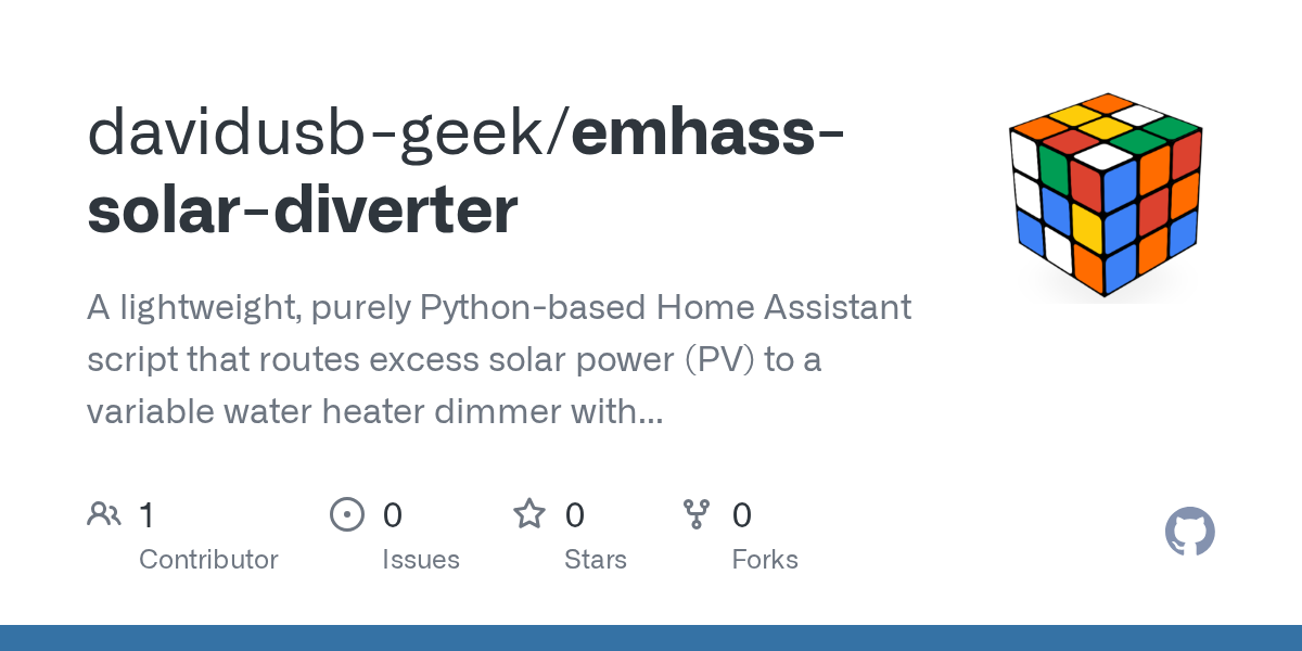

I’ve created this new HACS project where I share this realization of a Solar Diverter or Solar Router.
I’ve built this myself at home and it has been working perfectly for several months now.

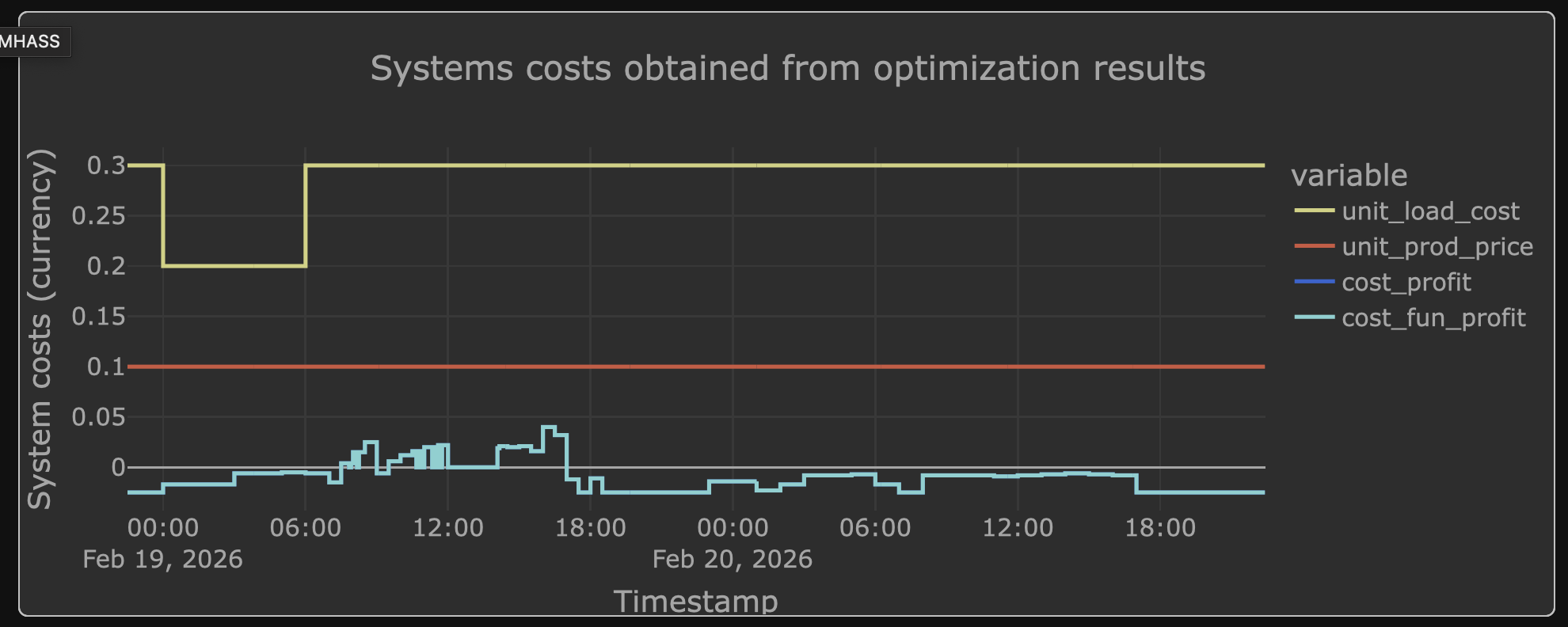

https://emhass.readthedocs.io/en/latest/publish_data.html
reading through the publish data, it seems like the senso.total_cost_profit_value doesn’t publish at all for me. All the other sensors get published bar this. Anyone else having the same?

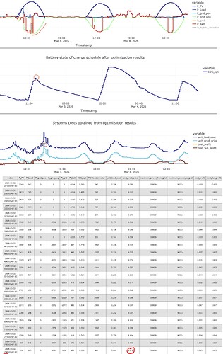

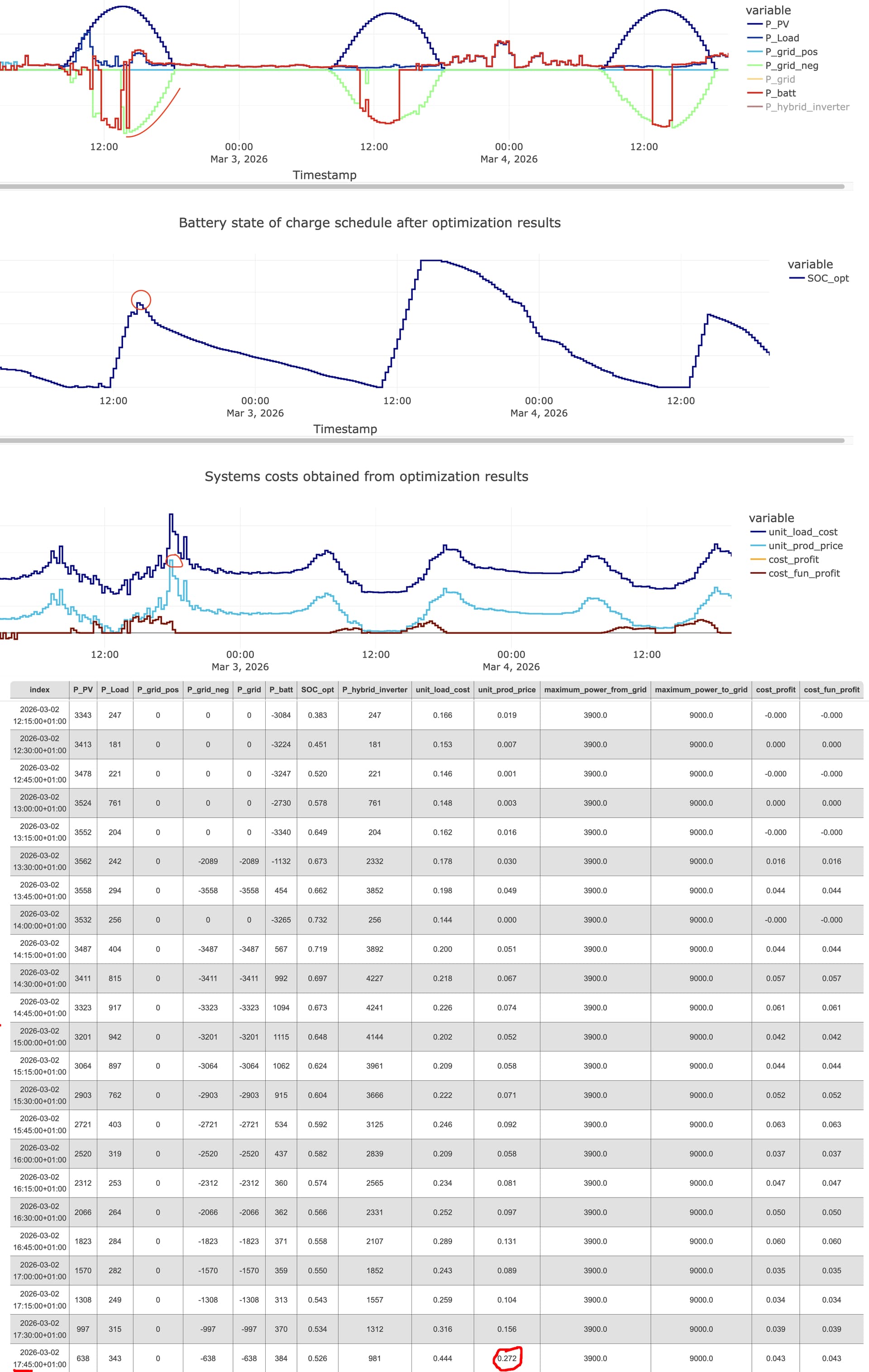

Hi!
First of all, I’d like to thank @davidusb for this great piece of software. I’ve been increasing my use of EMHASS gradually over the past couple of months. I started with manually running a day-ahead pass in January and then manually configuring my battery charging periods, and manually enabling/disabling the battery’s self-consumption. Since then I’ve added automatically enabling/disabling the battery’s self-consumption, MPC runs, and tomorrow I want to test automatically disabling battery charging if EMHASS decides I should export (I don’t want to force-discharge yet, that’s a next step).
Anyway, I’m using EMHASS 0.17, but the following issue also happened with previous release before I upgraded today: I wonder why EMHASS is not planning to charge the battery more tomorrow (using solar energy) and then discharge it during peak hours (e.g. at 17h45). Instead, it’s sending the energy directly on the grid when it gets produced, at a much lower price. There’s of course overhead in storing it into the battery and taking it out again, but not that much? (I set my battery charge/discharge efficiency both to 0.975, and inverter DC<->AC efficiency both to 0.96).
I have these settings as well:
  • “set_nodischarge_to_grid”: false
  • “weight_battery_discharge”: 0
As I’m a new user, I can only attach one picture. So I put the graphs and table in one :grimacing: (this is a 3-day-window MPC run)

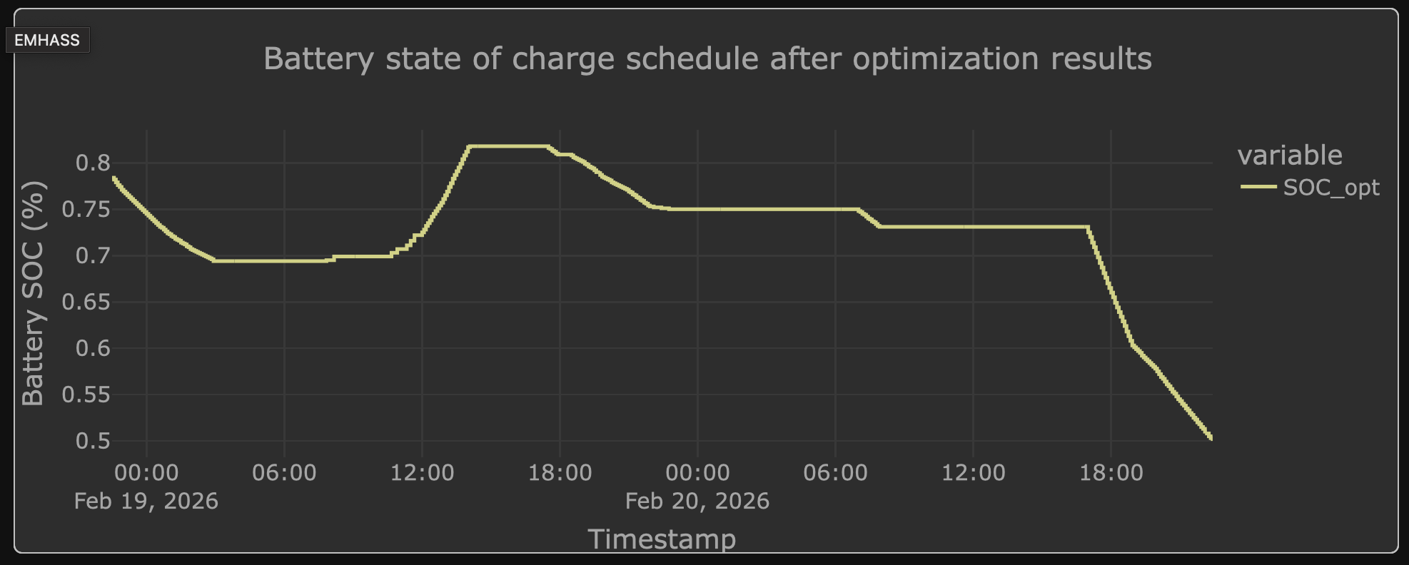

Hi all.
I thought I’d ask here before creating a feature request for EMHASS.
I’m using EMHASS extensively for battery optimization and thermal loads, and it makes all the difference for my solar plant with battery. I’m incredibly grateful for @davidusb and all co-developers for creating and maintaining EMHASS.
Now, what I don’t really understand is why I have to have a set battery SOC at the end of my optimization window when in reality I don’t care and it doesn’t matter. What I’d rather have is the optimization to select a SOC for me that optimizes profit for the optimization window. Quite frequently, I feel that EMHAS makes suboptimal decisions in order to reach a specific SOC when it actually doesn’t really matter.
Please help me out here, what is it with the optimization (mpc_optim) that I don’t understand?
Hi and thanks for your message.
There is no easy way to answer this. I will say it depends on how we see the optimization problem. When the optimization problem is solved the solver has no concept of what happens after the optimization window, it only sees the exact prediction_horizon you give it. Because discharging the battery almost always saves or makes money, if you do not constrain the final SOC, the mathematical absolute maximum profit will “always” be to completely empty the battery to 0% (or its safe minimum) by the very last timestep.
All of this also depends if you are thinking “day-ahead” or just MPC on a reduced time window (<24h).
On a day-ahead optimization we run once for a fixed block of time (e.g., midnight to midnight). Setting a soc_final here makes perfect sense because you want to be sure that the battery has a baseline charge ready for the start of the next day. The most typical choice here is soc_initial=soc_final.
Now for MPC it will depend on the 2 notions of receding and shrinking horizon.
If you have a receding (rolling) horizon then the optimization window always looks exactly prediction_horizon timesteps ahead. Does it make sense to set a soc_final here? It depends entirely on the length of your horizon:
  • Short Horizons (ex 1 to 6 hours): You must set a target soc_final. Otherwise, the setup might drive the solver to completely empty the battery by the end of that short hour. However, this soc_final shouldn’t be arbitrary; both soc_init and soc_final should be dynamically fed from a previously defined long-term plan (like the 24-hour schedule proposed by a day-ahead optimization). This setup will guide the short-term MPC to stay on track with a long-term daily goal.
  • Long Horizons (ex 24 hours): Setting a high soc_final here forces the optimizer to constantly chase a moving target that keeps getting pushed back every time the MPC runs. This might cause the “suboptimal” charging/discharging decisions that you are probably identifying. For long receding horizons I would say it is best to set soc_final equal to your battery_minimum_state_of_charge so the solver has maximum flexibility.
Finally the is the Shrinking Horizon case. Here the finish line is fixed to a specific time (ex midnight tonight). As the day progresses, the horizon gets shorter and shorter. Setting a target soc_final works perfectly here and it’s the situation that makes more sense to me for using MPC, because the target is rooted to a real moment in time, rather than constantly running away from the solver.
Would this be a big issue? Doesn’t seem to be when looking at the debug for PV forecast with Open Meteo.

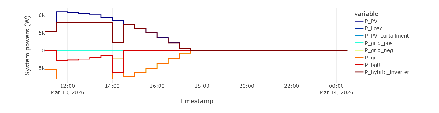

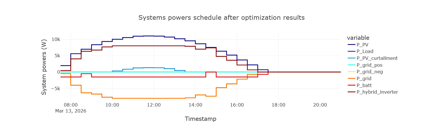

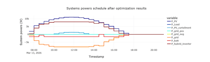

Hey guys,
i am working on my Dads Solar system which contains a SigEnergy Setup with 13,35kWp Solar and 16kWh Battery.
He currently has a static export Price of 0,068€ and import price of 0,24€.
As he has the old meter he is limited to 8kW export.
So my primary Goal is to maximise both Self consumption and money or in other words: Dont waste energy.
In my opinion on a day like today (see below) i would like to sell more in the morning and evening and prioritize charging in the middle of the day (where the light blue line marks wasting energy) but for some reason the charging (red line) is constant with drops in exactly those areas where i dont want to have it.
I have tried to change the battery stress cost do get up the charging current but that did not work. And this is why i want to reach out to you as my understanding of what to do unfortunately ends here :frowning:
Can you give me any advice on how to better controll the charging times with the EMHass settings and get rid of the curtailment?
Also id like to have the charging finished a little bit before the end of the day.
I am Running HA on a RaspberryPi 4 4GB and start the MPC with an automation with predictionHorizon = 28, soc_final = 1 and the forcast data from the solcast sensors.
Thank you all for your great work
Michi
Config
“adjusted_pv_model_max_age”: 24,
“adjusted_pv_regression_model”: “LassoRegression”,
“adjusted_pv_solar_elevation_threshold”: 10,
“battery_charge_efficiency”: 0.95,
“battery_charge_power_max”: 7000,
“battery_discharge_efficiency”: 0.95,
“battery_discharge_power_max”: 15000,
“battery_dynamic_max”: 0.9,
“battery_dynamic_min”: -0.9,
“battery_maximum_state_of_charge”: 1,
“battery_minimum_state_of_charge”: 0.1,
“battery_nominal_energy_capacity”: 16000,
“battery_stress_cost”: 0,
“battery_stress_segments”: 20,
“battery_target_state_of_charge”: 1,
“compute_curtailment”: true,
“continual_publish”: false,
“costfun”: “profit”,
“delta_forecast_daily”: 1,
“end_timesteps_of_each_deferrable_load”: [
0
“historic_days_to_retrieve”: 9,
“influxdb_database”: “homeassistant”,
“influxdb_host”: “localhost”,
“influxdb_measurement”: “W”,
“influxdb_port”: 8086,
“influxdb_retention_policy”: “autogen”,
“influxdb_use_ssl”: false,
“influxdb_verify_ssl”: false,
“inverter_ac_input_max”: 24000,
“inverter_ac_output_max”: 15000,
“inverter_efficiency_ac_dc”: 0.98,
“inverter_efficiency_dc_ac”: 0.98,
“inverter_is_hybrid”: true,
“inverter_stress_cost”: 0,
“inverter_stress_segments”: 10,
“load_cost_forecast_method”: “hp_hc_periods”,
“load_forecast_method”: “naive”,
“load_negative”: false,
“load_offpeak_hours_cost”: 0.24,
“load_peak_hour_periods”: {
“period_hp_1”: [
“start”: “17:00”
“end”: “21:00”
“load_peak_hours_cost”: 0.24,
“logging_level”: “DEBUG”,
“lp_solver_mip_rel_gap”: 0,
“lp_solver_timeout”: 45,
“maximum_power_from_grid”: 9000,
“maximum_power_to_grid”: 8000,
“method_ts_round”: “nearest”,
“minimum_power_of_deferrable_loads”: [
0
“model_type”: “load_forecast”,
“modules_per_string”: [
30
“nominal_power_of_deferrable_loads”: [
0
“num_lags”: 48,
“num_threads”: 0,
“number_of_deferrable_loads”: 0,
“open_meteo_cache_max_age”: 60,
“operating_hours_of_each_deferrable_load”: [
4
“optimization_time_step”: 30,
“perform_backtest”: false,
“photovoltaic_production_sell_price”: 0.068,
“production_price_forecast_method”: “constant”,
“pv_inverter_model”: [
“Fronius_International_GmbH__Fronius_Primo_5_0_1_208_240__240V_”
“pv_module_model”: [
“CSUN_Eurasia_Energy_Systems_Industry_and_Trade_CSUN295_60M”
“sensor_linear_interp”: [
“sensor.power_photovoltaics”,
“sensor.sigen_plant_consumed_power”
“sensor_power_load_no_var_loads”: “sensor.sigen_plant_consumed_power”,
“sensor_power_photovoltaics”: “sensor.sigen_plant_pv_power”,
“sensor_power_photovoltaics_forecast”: “”,
“sensor_replace_zero”: [
“sensor.p_pv_forecast”
“set_battery_dynamic”: false,
“set_deferrable_load_single_constant”: [
false
“set_deferrable_startup_penalty”: [
0
“set_nocharge_from_grid”: true,
“set_nodischarge_to_grid”: true,
“set_total_pv_sell”: false,
“set_use_adjusted_pv”: false,
“set_use_battery”: true,
“set_use_pv”: true,
“set_zero_min”: true,
“sklearn_model”: “KNeighborsRegressor”,
“split_date_delta”: “48h”,
“ssl_no_verify”: false,
“start_timesteps_of_each_deferrable_load”: [
0
“strings_per_inverter”: [
1
“surface_azimuth”: [
183
“surface_tilt”: [
30
“treat_deferrable_load_as_semi_cont”: [
false
“use_influxdb”: false,
“use_websocket”: false,
“var_model”: “sensor.power_load_no_var_loads”,
“weather_forecast_method”: “csv”,
“weight_battery_charge”: 0,
Edit:
I just played around a little bit more with no success until i changed the cost_function to “cost”. This obviously messed it completely so i changed back to “profit” and after running the optimisation it now looks like this:
I am completely confused now, why it never changed before to charge more than 1500W now matter when i hat run the MPC.
So now i would also be interested in why this happened and which parameter help me to flatten the charging to a more constant curve. (refering to the peak at 14 / 2PM)
