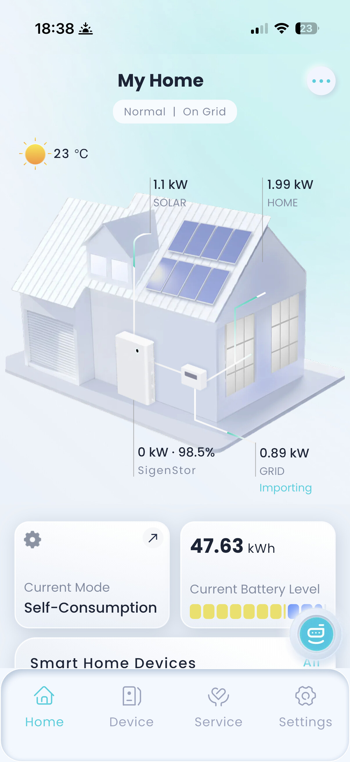

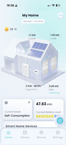

Have just started testing EMHASS with my Sigen system and now I have an issue. Hoping someone has had the same issue and can help!
EMS seems to be working fine and doing what it should, but I have now disabled EMS mode and put it back in to self consumption mode, but it now won’t use my stored battery and continuously takes from the grid.
When I put it in manual control and self consumption it takes from the battery fine, so it seems like an issue with the self consumption profile.
Has anyone had an issue like this before?
