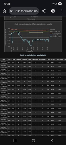

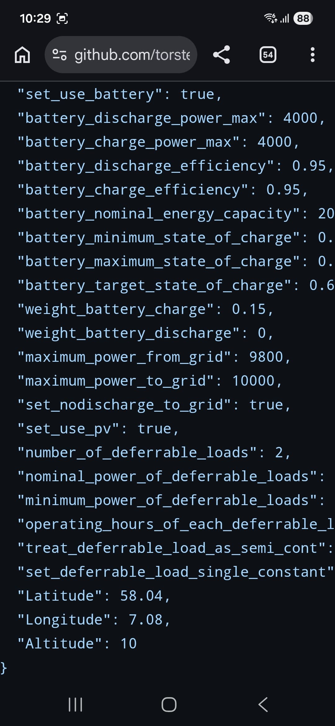

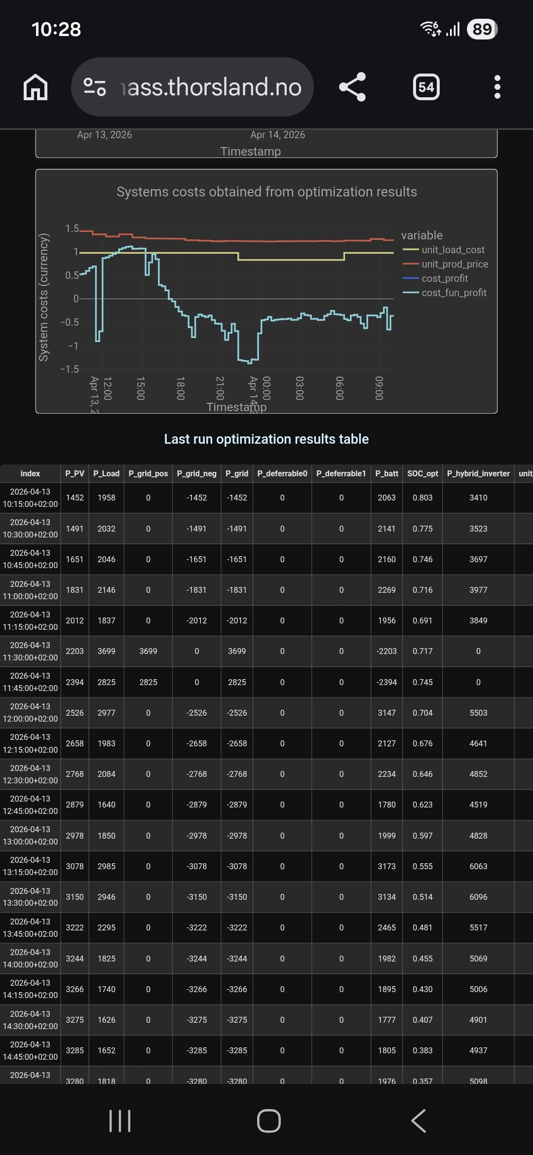

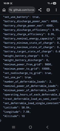

Think there is a bug in newest release. I have set no discharge to grid true from battery but my forcast shows that it want to do so anyway:

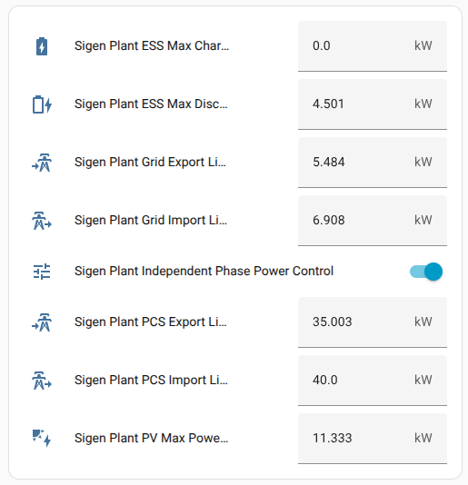

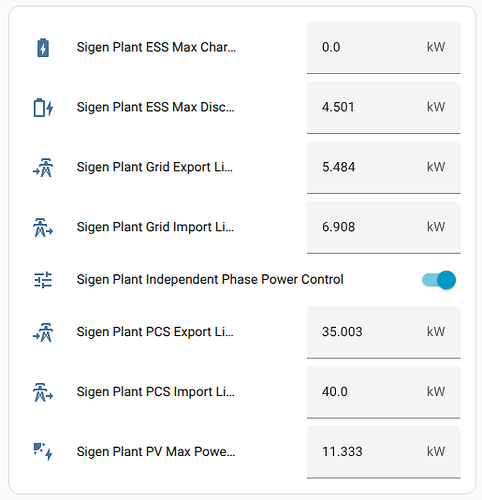

Just integrated EMHASS into my FoxESS set up and utilised the annabele synergy approach to do so. I am having issues with both the Automation and Curtailment integrations as they utilise sensors such as variable grid export limits that I can’t seem to find on Fox.
Does anyone have any tips or currently use an automation that works well for MPC and EMHASS with FoxEss via modbus??
