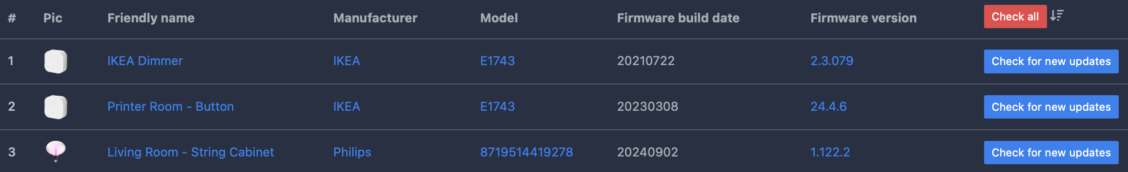

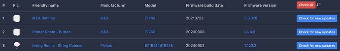

Given that your light bulb does support OTA, navigating into you Zigbee2mqtt add-on, you should see a tab across the top labelled “OTA” (next to Groups, or around there). Within there, you should be able to see all you devices, the current firmware, and the ability to push an OTA.

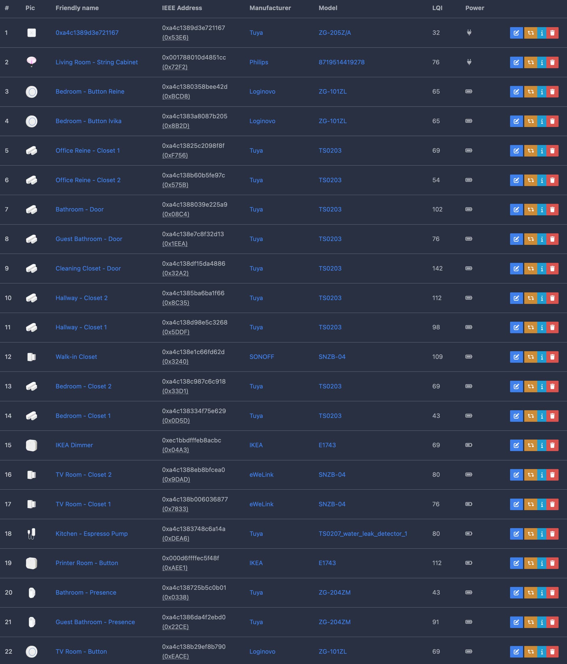

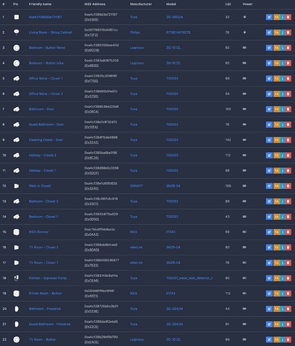

Do I do something wrong, why doesn’t more devices show up under the OTA tab?

Only devices with an OTA update ability will be shown.
Aha, I thought Tuya devices had that ability, but that was just something I presumed.
Any idea why my IKEA buttons doesn’t say they have an update when they are of the same model and one have a newer firmware?
With my IKEA devices, I always have to push the button to make sure they are ‘awake’ to receive an update.
