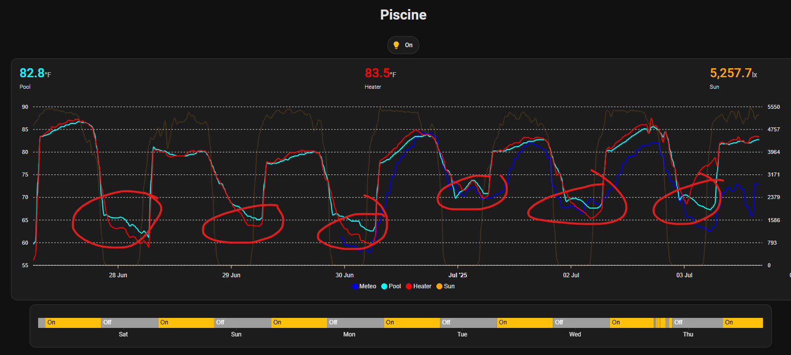

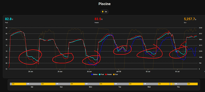

I have a temperature probe for my pool installed in the piping outside the pool.
It produces meaningful data only when the pump is working (I shut down the pump during the night), otherwise, the water temperature in the pipes go down WAY faster than the rest of the pool.
When my pump is off (got a toggle automation on my pump plug) I want to stop recording the temperature data.

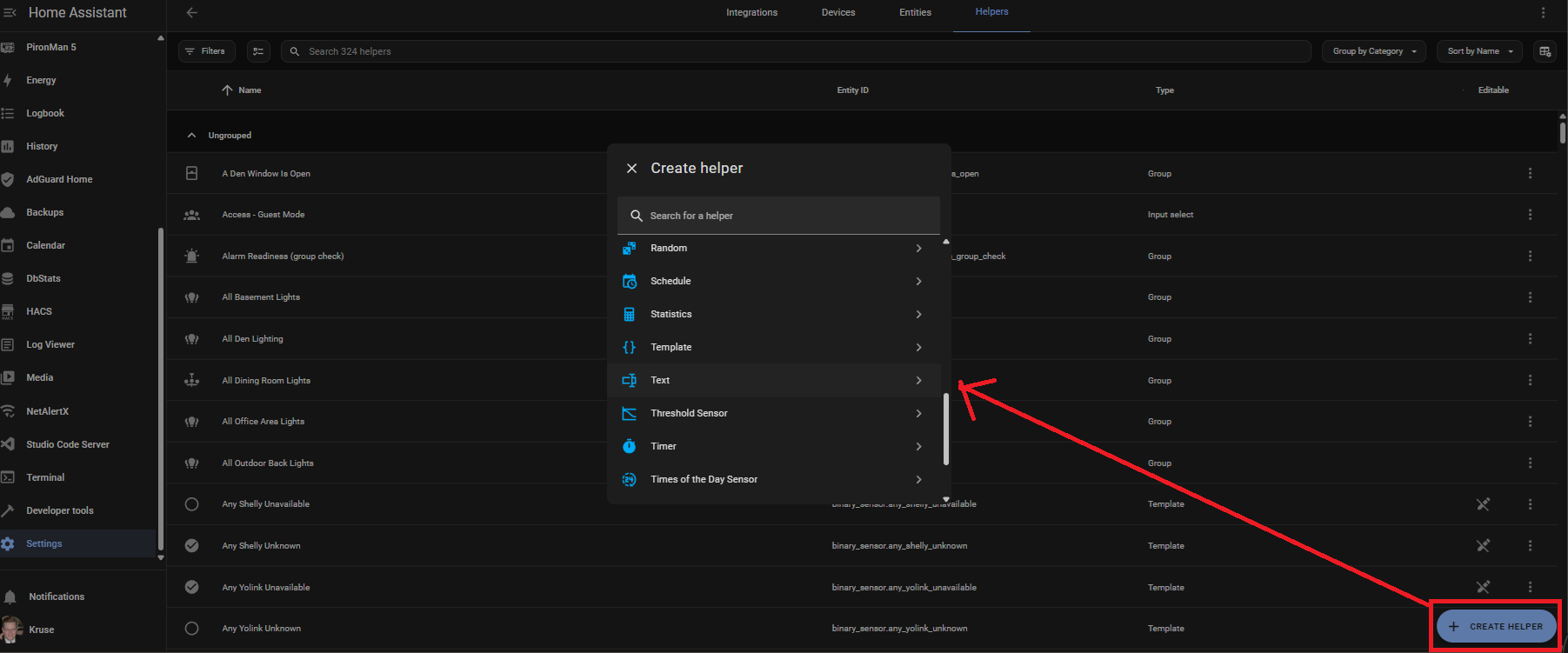

I see often a lot of YAML config code in documentation and examples like you do, but I’m not quite sure where to input this.
I am in my helpers page, I click “create Helper” > Template
I have a few choices, alarm, binary sensor, button, image, number, select, sensor, switch. (No Text)
The sensor one make sense.
I must define
State template : TBD
Unit of measurement : Null (if I put something, I get an error “Sensor None has device class ‘temperature’, state class ‘measurement’ unit ‘°C’ and suggested precision ‘None’ thus indicating it has a numeric value; however, it has the non-numeric value: ‘’ (<class ‘str’>)”
Device class : Temperature
State Class : Measurement
Device : Pool_Temp_In
Now, all that’s left is to define the state template, wich I’m not sure what it means, but should represent my conditions / filter ?

The ApexCharts-Card has options to handle null data points, I could keep it blank, or display the last know value.
