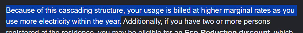

If you're not paying (or looking closely at) your own bills & depended on AI to get the answer, it also got it wrong:
*If you want to know how erratic they can be, I just had a look at my last half dozen bills - they varied from 59-70 days!
Uhm, that fixed charge is mandatory & not uncommon at all. It's a service charge which, again, is added pro-rata to your bill based on the number of days in your billing cycle. It varies every bill, but it's always there (like death & taxes) & not uncommon at all.
Please don't get me wrong. I was genuinely interested in installing this and am not here to spit on your efforts. You requested feedback and I'm providing it as honestly as possible. However, unless your package learns to read ARMS' minds or gets them to start billing on a fixed schedule, the costs returned by this integration will be wildly off for most of the year.
