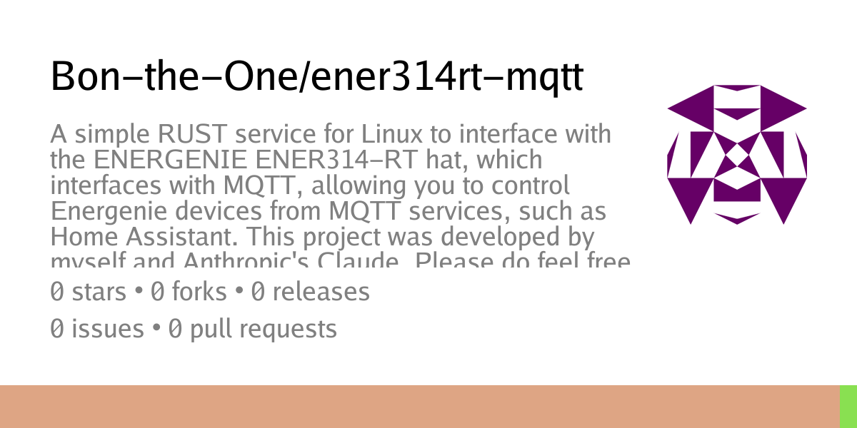

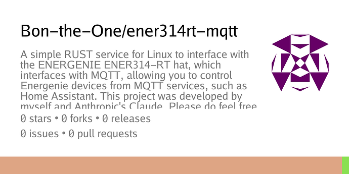

Code
MIT licensed. Contributions welcome. sysvinit only — no systemd. :smile: Screw you Poettering… Best on Devuan or BSD…
