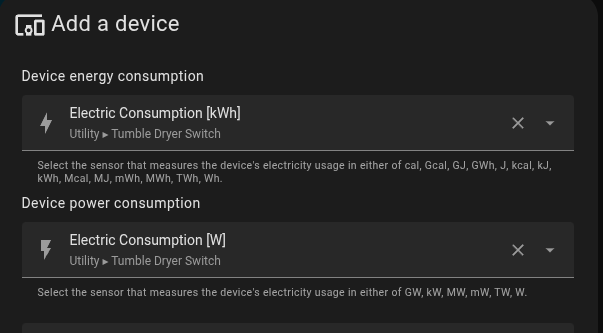

Not sure if you resolved this already but
Grid power is for total you are pulling from the grid, so in my case I just assign a single entity from my Solar inverter which measures this.
You should add your sensors under Individual devices, for each one you can specify energy (kWh) and power (W).
eg:
and these entities looks like:
After doing that and waiting a bit, they should show up under Energy → Individual device total usage and Now
